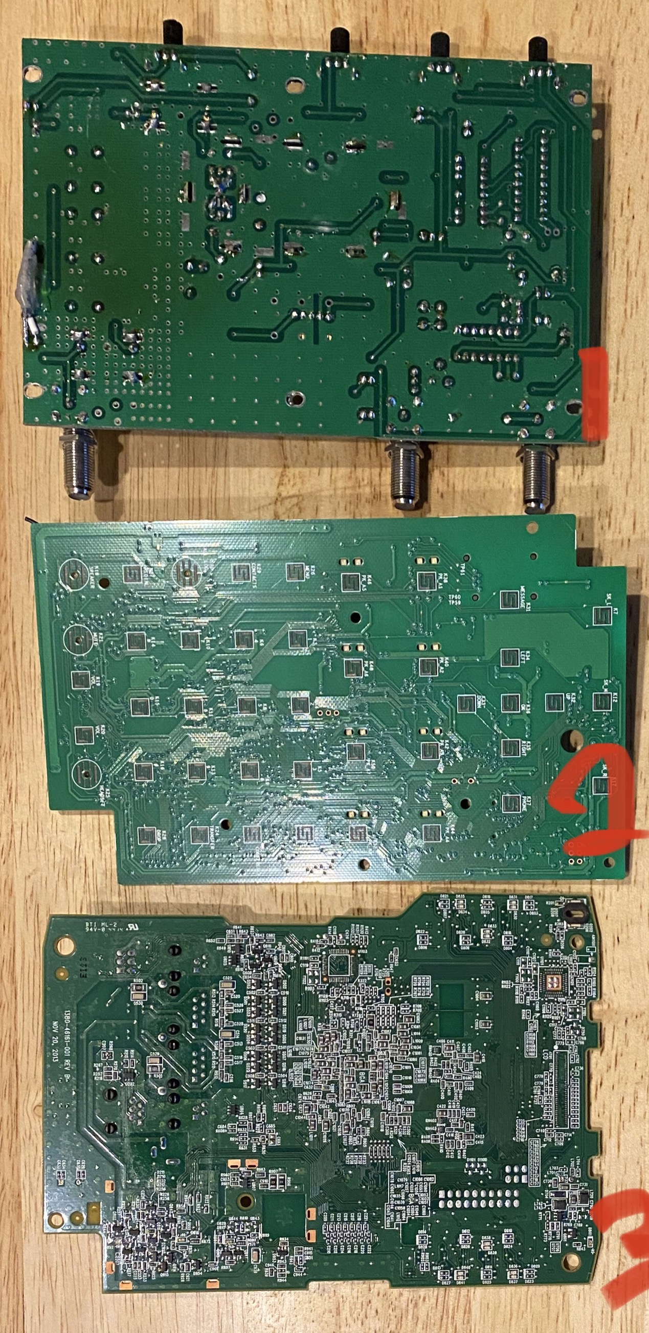

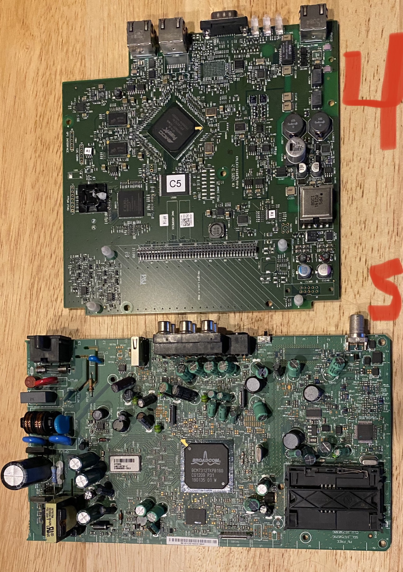

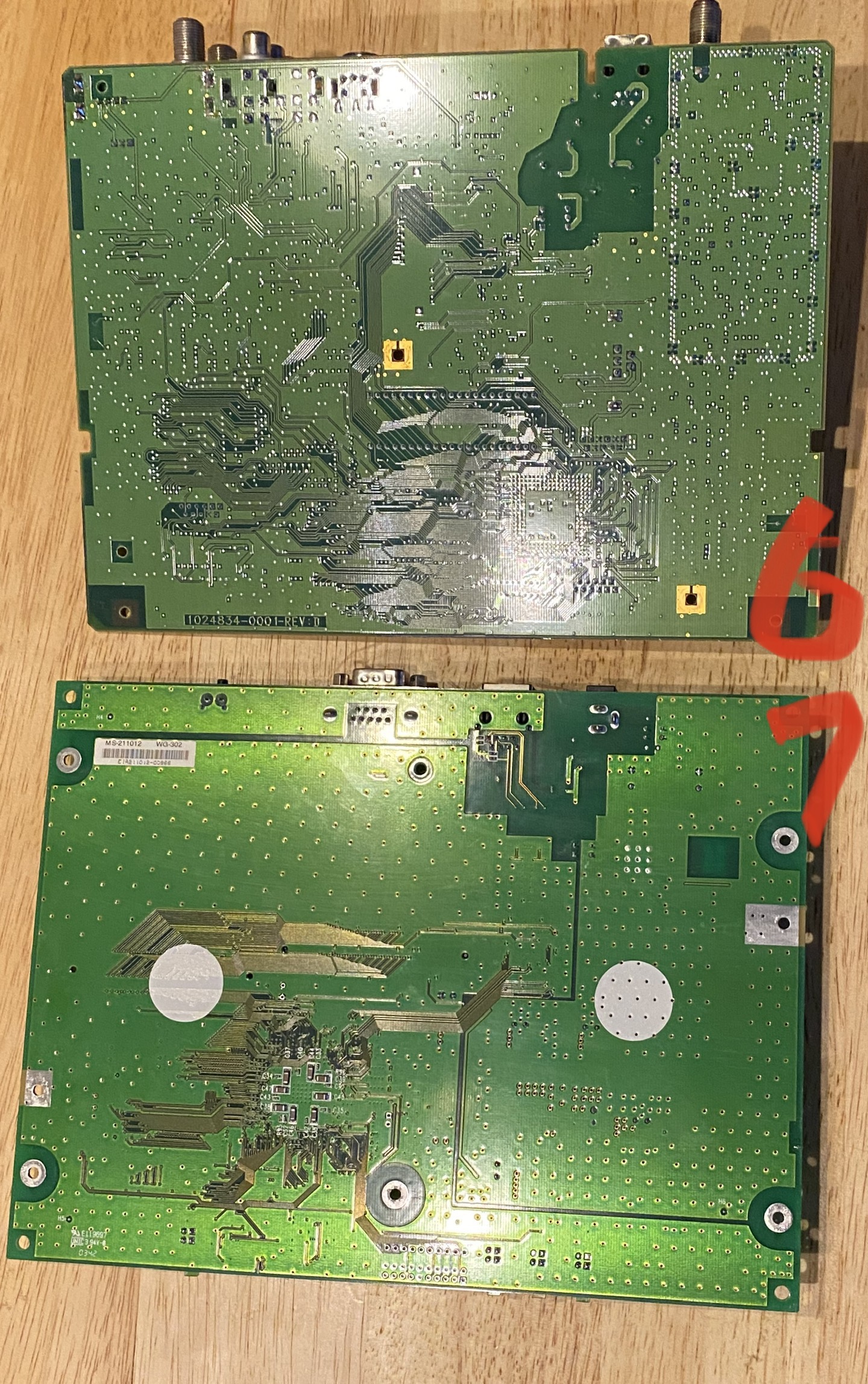

Hello looking for a couple quick grades please and thank you. Boards are numbered and with back pictures numbered as well.

#1 Low Peripheral. Too junky. Think of removing metal.
#2 High Peripheral
#3 High Peripheral
#4 High Peripheral
#5 High Peripheral
#6 High Peripheral
#7 High Peripheral
PostPosted: Mon Jun 01, 2026 6:04 pm
Posts: 2589
1 is a good case for removing shields (assuming the little ones are also shields), as is or without the metal boxes this looks low peripheral. But if removing them reveals ICs or other goodies then you have a case for moving into a higher grade.

Wouldn't you want to remove the transformers from 5/6? I normally remove them and toss them in my transformer bucket for my local yards.

Removing the transformers isn't required and often unnecessary for smaller ones. If a board is borderline it can make a difference though. That being said, 6 I see no reason to remove that one. 5 I think is okay also but I could see removing it if you're unsure.
