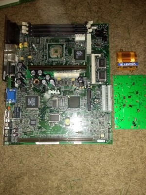

Older boards
 Post subject: Re: Board id
PostPosted: Mon Nov 30, 2015 2:37 am
Posts: 10496
Top 6 peripheral more than likely
Bottom 3 are mid grade and low.

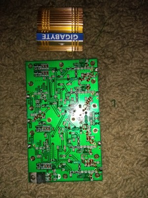

What if some of the chip got stuck on the heatsink. What grade would the big board be. And can i throw that heatsink with my gold pins. I scratched it and it's a different color, so I'm guessing it's gold plated. And the little board I'm thinking peripheral. But not sure.
PostPosted: Mon Nov 30, 2015 2:17 pm
Posts: 10496
The little one is going to be mid grade.
The large one us now peripheral without the cpu :/
The gigabyte heatsync is gold plated. But it's very thin. Gigabyte and AsRock use the same heatsync with a different print on it.
Put it in it's own spot in a bag in your shipment though since the cpu is still attached.
Normally those two heatsyncs would be between 60-80 cents a pound. i usually toss them in my gold connector bag.

Top pic mid on top peripheral below
Bottom pic. The riser card is backplane.
The wifi cards with the steel spreaders are peripheral. The ones without spreaders go telco. The gameboy card will be telco with one or two ics. You /may/ get ram if three ics.
The other cartridge card next to it is gold finger card.
