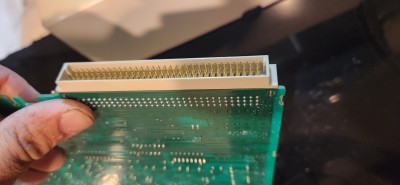

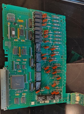

File comment: Board style 3

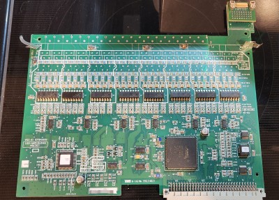

File comment: Board style 2

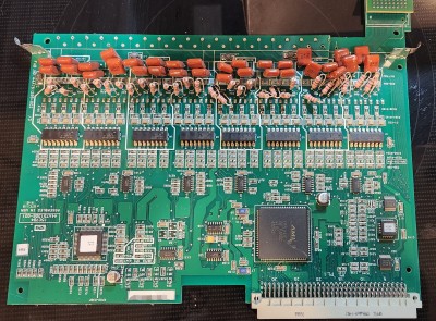

File comment: Board style 1
File comment: Gold plated connection pins, also note the absence of any reverse side components. This is the case for every board I was wanting help with. However I am aware that doesn't necessarily make it a lower grade.

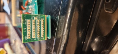

File comment: LED system status display example

Remove the glass. Fuses. No doubt. All those relays. Remove the relays. Submit to Boardsort as High Telecom. Does mid grade telecom exist? After your submission
You will get your question answered if mid grade telecom is a category. Which is not listed.
PostPosted: Sun Dec 21, 2025 12:26 pm
Posts: 366
Location: Ohio
I would only remove the glass fuses and keep everything else intact. Relays add value depending on what kind and quality.
Any board that can be separated from others or the main PCB must be disassembled; led board.
Submit all the larger boards as Low Tel. In my opinion they barely make Low Tel, mostly High end Per.
The led board will go low/mid grade.
PostPosted: Sun Dec 21, 2025 12:29 pm
Posts: 366
Location: Ohio
There is no in-between High and Low Tel but are some exceptions depending what's populated on the board or can be prorated depending if it's an easy upgrade or removal. That is completely up to BS in grading your boards or having an underlining exception to where BS will accept it as an off-listed item.
