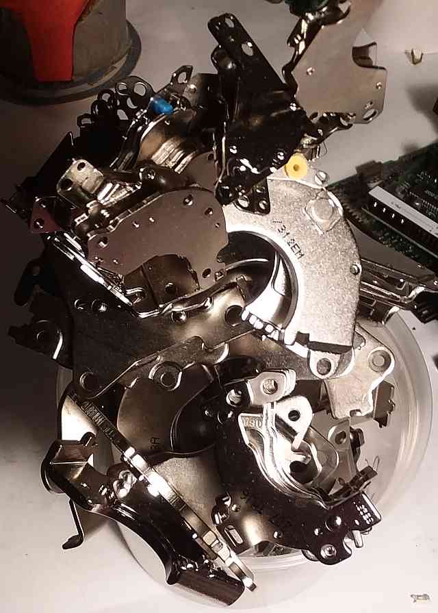

Five pounds of hard drive magnets with the metal they were attached to in the hard drives. Is there a market for these things ?

The backings are made of a high nickel allow that shields other components from the magnets. So find a scrapyard that takes nickle... yeah I spelled it both ways...
The magnets themselves I'm not sure on off the top of my head but the outer coating is also nickel. And if you want to store them without worrying about the magnetic field damaging something run a propane torch over the magnet until it pops and the magnetism will be gone.

The backing mount/shield is called permalloy. Yards that buy high-grade-separation stainless pay well for it. From $0.75-$1.50 averages now.
The magnet is a different story.
There is almost no consistency even from the same manufacturer and same model.
I’ve seen everything from junk iron-ferrite to high end clean cobalt.
Cobalt has some properties that with research and training you can learn to check for.
Aside from cobalt I tend to “donate” drive magnets without the backing to my local yards.
One of them has some employees that have taken to building an actual pyramid out of them in a corner. It’s roughly 7 feet square across and close to 8 feet high now.
How they ever intend to move it is another issue entirely. But it’s wicked to look at and powerful enough to require a small rope off area. Lol. :)

How do you get the magnets off of the permalloy backing? They seem to be quite hard to get off without destroying either the magnet or the coating/ plating on the magnet.

Any coating is either nickel or chromium.
Gently bang at it with a large screwdriver.
If the magnet crumbles it’s a ceramic. Just stop: it’s not worth the trouble.
I use a commercial heat gun at 1600 to the permalloy side. Melts most organic glues.
Then slide the mag off with lockjaws and a long screwdriver.

just bend the "backing" plate a bit with pliers - so that there is space where to put the flat head of screwdriver under the magnet - put it in and just twist it off - it comes of relatively easy that way. sometimes will damage the coating, though

From what I have seen more than half of the magnets break or tear the coating when I've done them this way. Especially newer magnets which are thinner.
