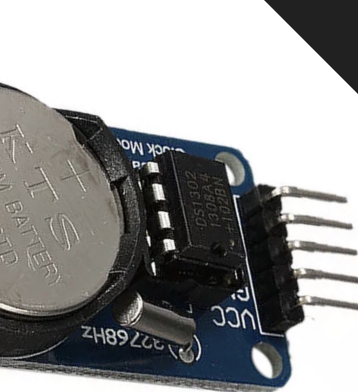

Can someone post some pics of Dallas switches? I am having trouble telling the difference between IC's and Dallas switches... Google wasn't much help... Is there an easy way to tell the difference?

Battery backed Real time clock IC boards: aka Dallas Switch
These are unacceptable
PostPosted: Sun Jul 12, 2020 9:54 pm
Posts: 10109
Battery backed real time clocks with batteries removed: peripheral rate
File comment: Obviously this has the battery still in the image

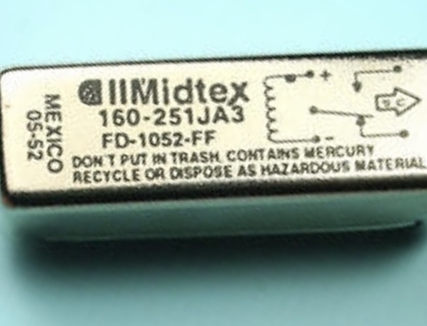

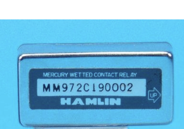

Mercury:

For mercury relays,
Attempt to remove or place whole board in hazmat?
Representin otown, central FL
PostPosted: Tue Jul 14, 2020 1:34 pm
Posts: 10109
For dip (IC) style, only ones in sockets. Otherwise the board is hazmat.
For canister style if you have enough experience to make clean breaks in a PCB you cou punch a hole around it and remove the can from the board. But generally best to hazmat the whole board.
For tube style they usually have a quarter or half turn socket. Push down gently and try to turn it. Some are clockwise some counter-c.
Mercury is a neurotoxin. Impossible to clean up in quantity without experience, and causes toxic stains in organics and cloth. If you aren’t 100 percent sure you can remove it safely don’t try.
