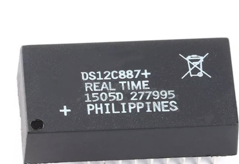

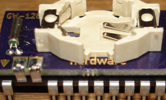

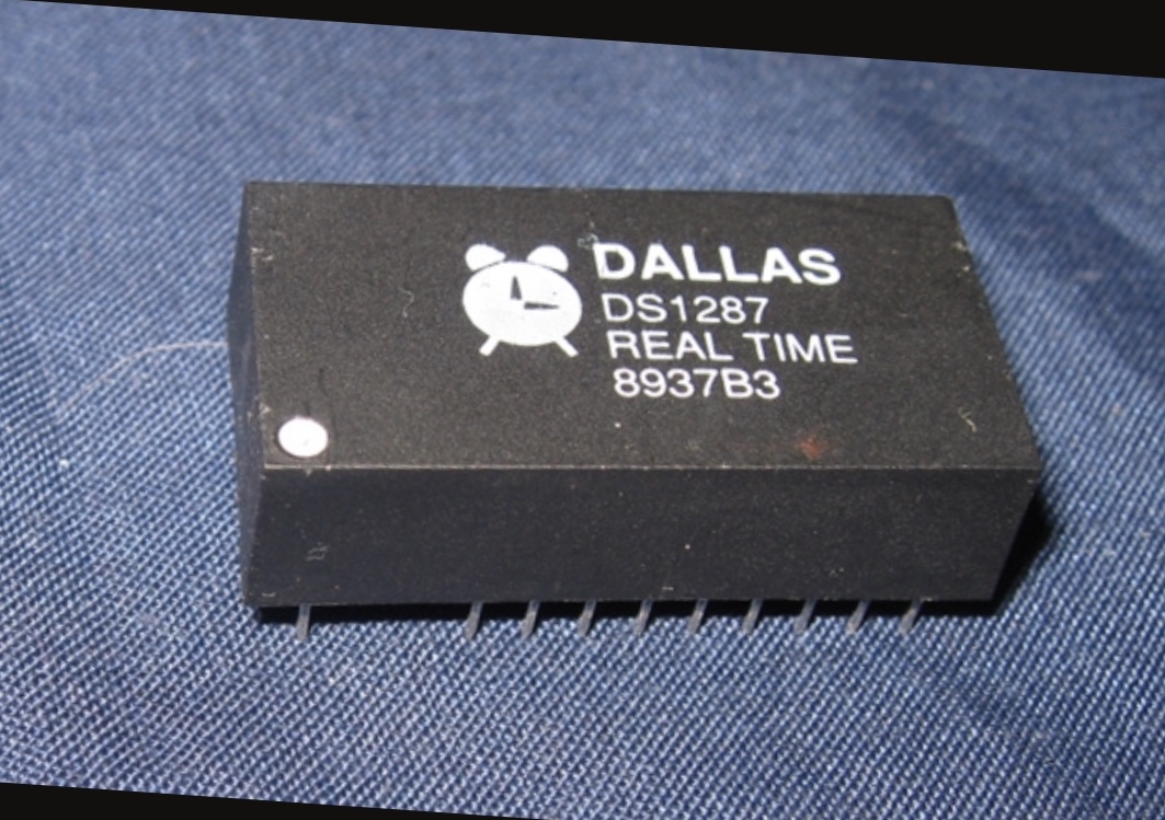

Can someone post some pics of Dallas switches? I am having trouble telling the difference between IC's and Dallas switches... Google wasn't much help... Is there an easy way to tell the difference?

PostPosted: Sun Jul 12, 2020 9:53 pm
Posts: 10060
Battery backed Real time clock IC boards: aka Dallas Switch
These are unacceptable
