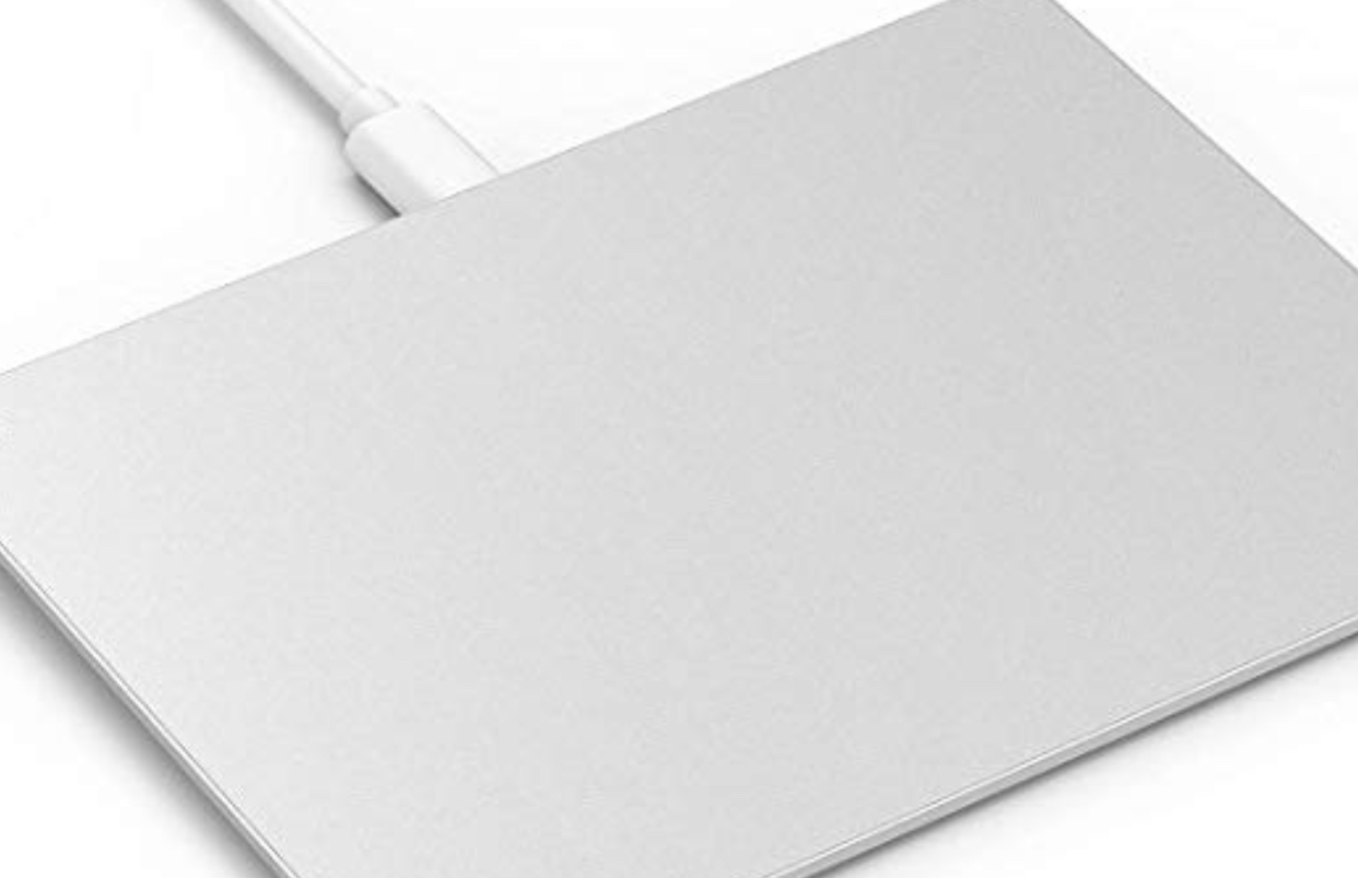

Trackpads? Like these?

Omg. I laughed so hard I got a cramp in my side.
More along the lines of these:
...and more specifically the board inside them.
