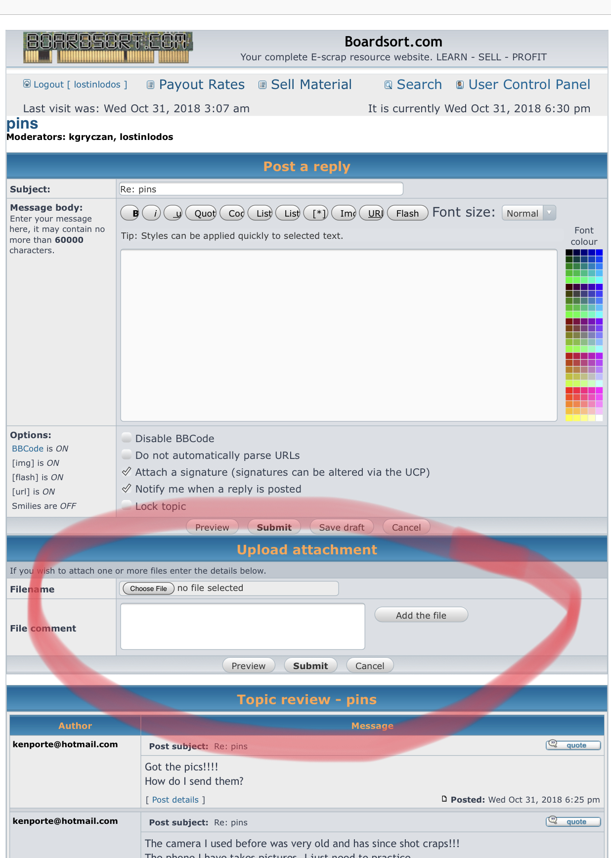

Got the pics!!!!
How do I send them?
 Post subject: Re: pins
PostPosted: Wed Oct 31, 2018 7:32 pm
Posts: 10568
Just try this; click post reply and use the image options below the text box.

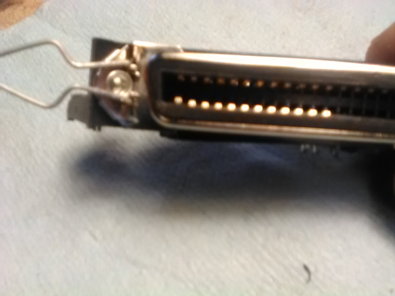

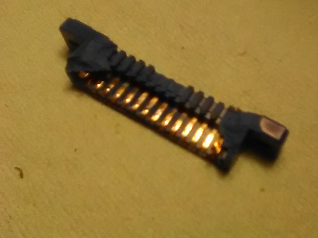

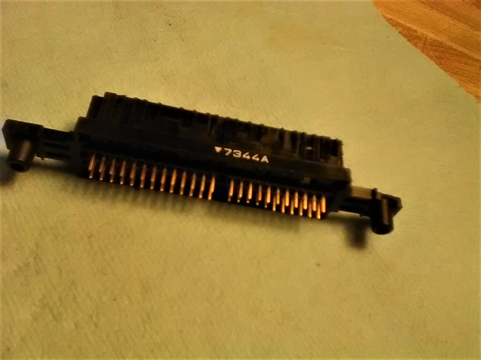

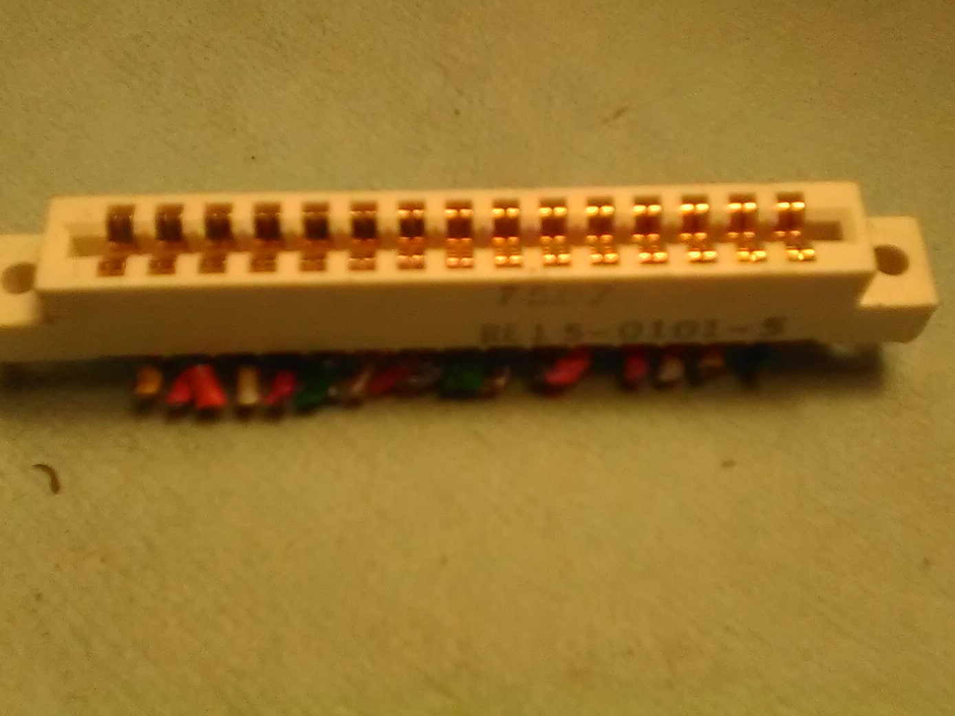

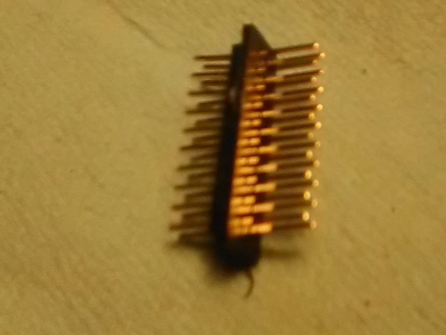

PostPosted: Wed Oct 31, 2018 11:11 pm
Posts: 10568
06)gold pin connector
07)gold pin connector
05)peripheral
03)gold pin connector
04)pins
02)pins
08)gold pin connector
01)peripheral (cutting it close)
PostPosted: Thu Nov 01, 2018 9:01 am
Joined: Thu Nov 12, 2015 2:43 pm
Posts: 36
Are those pins acceptable?
Why is 01 close, to much plastic?
PostPosted: Thu Nov 01, 2018 3:51 pm
Posts: 10568
The two I said were good for pins are good to send as is for a pin quote.
The gold pin connector class was set up to recognise the value of gold pins Ofer standard copper wire ends.
It covers most plastic and metal gold pin connectors.
When it comes to gold pins, and having plastic, they are handled separately at Boardsort. If the pin weight far exceeds the plastic weight it’s safe to send them for a pin quote.
Chris et al has picked a certain point where ends are better than the connector class but not good enough for the manual labour of doing a pin quote; which is very time consuming.
Their actual decision rules are unknown to me and not set in stone anywhere.
My guiding which has generally met with their approval has been, if the adapter is not worth taking apart, it’s a gold pin connector.
If it’s worth taking apart for a gold pin quote on the pins it is peripheral class.
I usually extract the pins from peripheral quality connectors, though not always.
So when I upgraded someone’s gold pin connector on the boards it’s because I would probably take that connector apart myself.
So to answer the question on the just barely connector for you it’s because if I had nothing else to do that day I MAY, or may not, snip it open and extract the pins.
