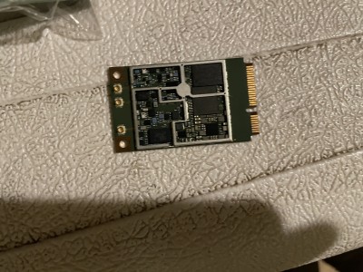

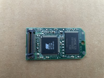

OSCAR is saying both are low grade STAT hard drive boards, how ever neither came from a hard drive.

The first board I think is some sort of RAM its out of a WYSE terminal. Although it doesn't go in RAM category.
The second I think is a wifi card, but its not a laptop wifi card.

That WIFI board. I would put it in WIFI. I submitted 3 strange lookin WIFI boards to Boardsort and got no negative feedback. The strangest looking one came from one of those circular automatic vaccum cleaners you let roam around in your house. It was clearly marked WIFI. About the size of a regular Laptop WIFI. But was just strange looking. It did have gold fingers. It was 2 small boards piggybacked on one another. It had good chip density. The other 2 looked a lot like the one you have shown.
Your RAM board. I would not put it in RAM category. It has NO gold fingers. That is important. Just look at the Gold Finger prices. I feel strongly gold fingers better be on a board submission for purchase in the Gold Finger Ram category. So. I am still thinking High Telecom for the other board.

First board high telco. I have sent in many small boards like this with high chip coverage and no junk with no complaints.
As you do more of this you will begin to see ram chips on a lot of odd boards, doesn't make them ram.
Once in a while I find a very old ram board, usually in scientific equipment, with a gold connector but no fingers. Still not sure what to do with them, but as I see so few have just been putting them in high telco and moving on.
Second is clearly gold finger wifi. Has the antenna connector (some have the antenna right on the board), gold fingers and I agree the under shield chips are right (pulled a few shields before I knew that I didn't have to).

That 2nd board is WIFI. Pulled shield.
