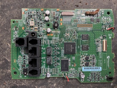

Board 1: OSCAR said High Telecom, but I think it mistook the transformers for connection ports. I'm thinking Mid Grade, possibly low grade peripheral if I'm lucky?

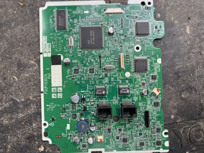

Board 2: OSCAR says Low Telecom. It was from an office phone. I've never taken apart phones before this, so this is my first experience with any telecoms equipment

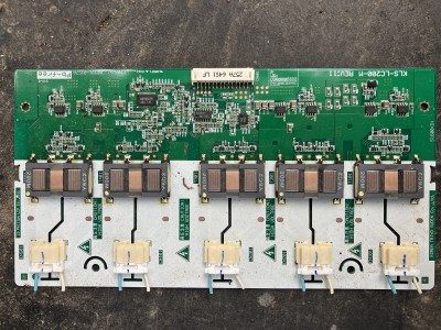

Board 3: OSCAR says High Peripheral. This is also from a lot of office phones, but a different model.

pictures 97-98 , are High Peripheral.
If you carefully separate the two boards from the few solder points of the transformers, the one can go as Low Per and the other Low or Mid grade. Wire cutters nipping the solder points a few times does well
