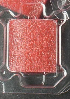

Clamshells work for individual CPUs. They run around 10-15 cents each.
There five standard sizes.
Large pin (pentium era ceramics, black fibre, modern AMD)
Small pin (486 sizes)
Wide pin (pentium pro, opteron)
Large LGA (sun, HP)
Small LGA (core, I series)

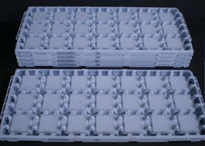

Trays come in 4-20 cpu sockets. In even numbers.
Small, large, and wide
Crafty people can very carefully cut double-wall trays to single chip trays.
Trays start around a filler each though. And wequire packaging knowledge.
Don’t get caught up in “designed for xxx cpu”. No generic trays are designed for any specific processor.
