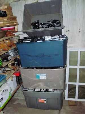

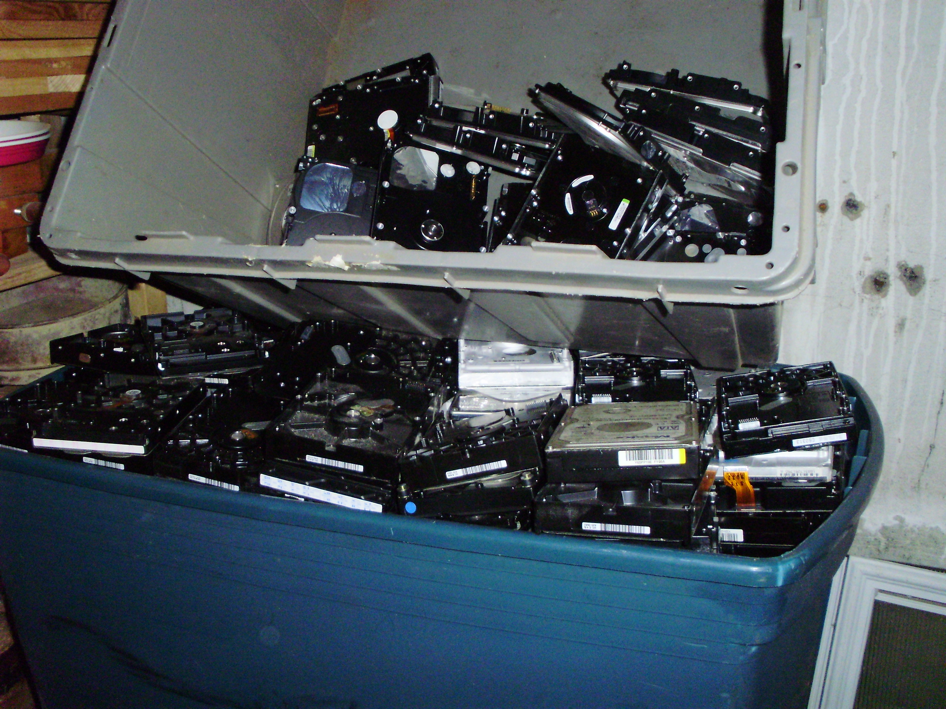

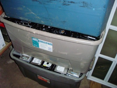

I just got about 50 laptop hard drives that someone took them apart for the discs. They left the read head and the board attached. Leaving me with the best of everything from the alum. case, to the circuit board, to the read head.
Which leads to the next project hopefully soon. It should be worth saving the read heads from these:
Bins measure 28"long x 18"wide x 15" deep with approx. 20 drives per layer.

Lmao on this on! I love it when people take the platters and leave the boards.
There’s a reason boardsort pays less for platters than standard aluminium.
For one thing nearly half of all platters are GLASS!!!! Look it up.
I’ve politely corrected quite a few yards over the years buying platters as high value aluminium. The myth of value continues on anyway!
That’s a lot of heads though. And a lot of boards!
I’ve noted elsewhere that the heads are not clean. By any stretch.
Be it a rod or pad rhodium is a tiny fraction of a fraction of the total head weight.
So it takes quite a few pounds of read heads to make a refinery interested.
I’m not sure what the actual ratio is or pricing at the moment. But with rhodium in the very low 5 digit value right now you don’t need much to get a few hundred bucks. You’re definitely in the quantity range there to get someone interested.

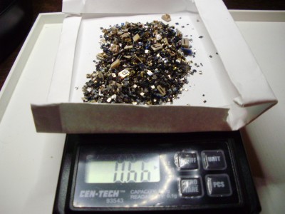

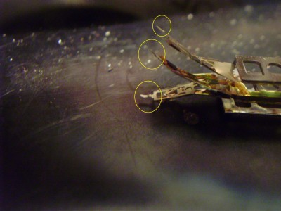

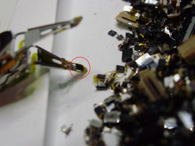

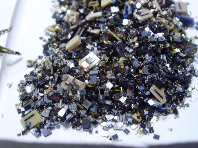

Finished scrapping all the hdd in the pics of the tubs. These are a few pics of the read heads with the rhodium coating. All I saved was the small ceramic square on the end of the read arm. The larger cubes are from old floppy drives.Again the only rhodium is the tiny line down the middle of the square. I am not sure what these are worth but I am just going to keep saving for now sooner or later someone will be interested in them. The second pic I circled the end of a read arm showing the ceramic square. Scale shows .66 ounces.

Posts: 1324
The floppy drives won't have rhodium. They work in an entirely different way. Tape drives and ZIP drives also won't. Someone else posted another topic on this recently where I linked to a couple interesting sites that show just how small the actual read/write head is on the slider and a patent on how rhodium is applied to the substrate.
viewtopic.php?f=4&t=21580
lostinlodos wrote:
...I won’t pretend to understand the how and why of this scientific aspect but the more precision needed the better rhodium works over other material cores. ...
The patent actually covers the why rhodium is used vs other materials. Gold too soft, tantalum too resistive, etc...
