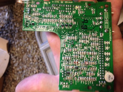

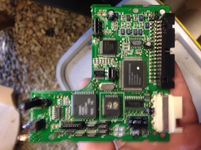

I was also curious about tape drives. I just purchased a ton of them and would bet they fall into cd/DVD category. But figured I would post and find out. They are pretty populated so it also wouldn't surprise me to be able to get telco or hard drive price out of it. But I'm just a new guy. I will see what boardsort has to say. Here is an example of one....
PostPosted: Sat Aug 29, 2015 12:17 am
Posts: 10102
That's peripheral
PostPosted: Sat Aug 29, 2015 12:23 am
Posts: 91
Really? It seems better populated than some of the cd/DVD boards I've pulled. And gold pins. What makes you say peripheral? Not disagreeing just trying to learn so I can figure it out on my own.
PostPosted: Sat Aug 29, 2015 12:36 am
Posts: 467
I think you would be able to get cd/dvd board classification for those... Hopefully Chris will be able to give you a definitive answer.
PostPosted: Sat Aug 29, 2015 11:14 am
Posts: 10102
I think (I'm not them) it's the number of pins as the ports are shorter. ?
I only say peripheral because a bunch of jazz and hp boards i sent in for review . Not quoted . Were taken as peripheral.
Maybe Chris could clarify this.
PostPosted: Sat Aug 29, 2015 12:20 pm
Posts: 91
I sent Chris an email. I will post the answer when I hear back. Fingers crossed.
PostPosted: Mon Aug 31, 2015 12:23 pm
Posts: 91
You were right. Chris says peripheral.
PostPosted: Mon Aug 31, 2015 3:09 pm
Posts: 467
ah, bummer.... i figured a well populated board like with a couple chips and all would make the cut... oh well. :/
