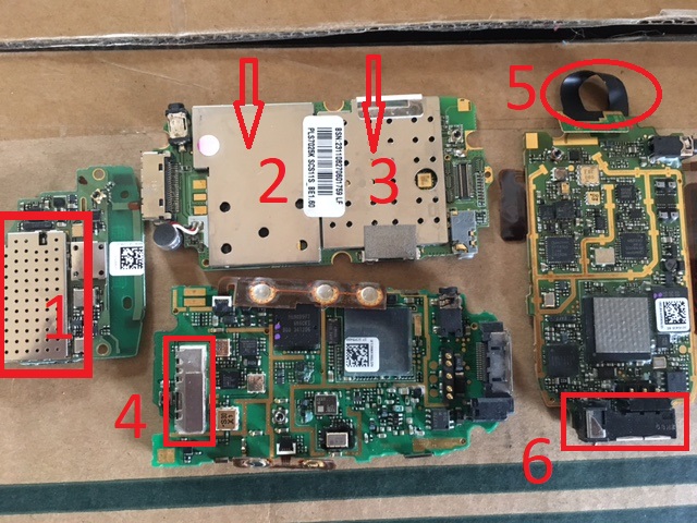

i have attached a picture of a sampling of cell phone boards.hopefully this will help out others too. I wanted to get some clarification on removal of the following:(y/n)
1: removal of this metal cover
2: removal of this metal cover
3: removal of this metal cover
4: removal of this part
5: flex cable attached to board
6: removal of adapter plug (has gold contacts in it)

1) yes
2) yes
3) yes
4) no
5) yes (wires should be removed from all boards)
6)
if it’s attached by pins yes
If it’s soldered no
