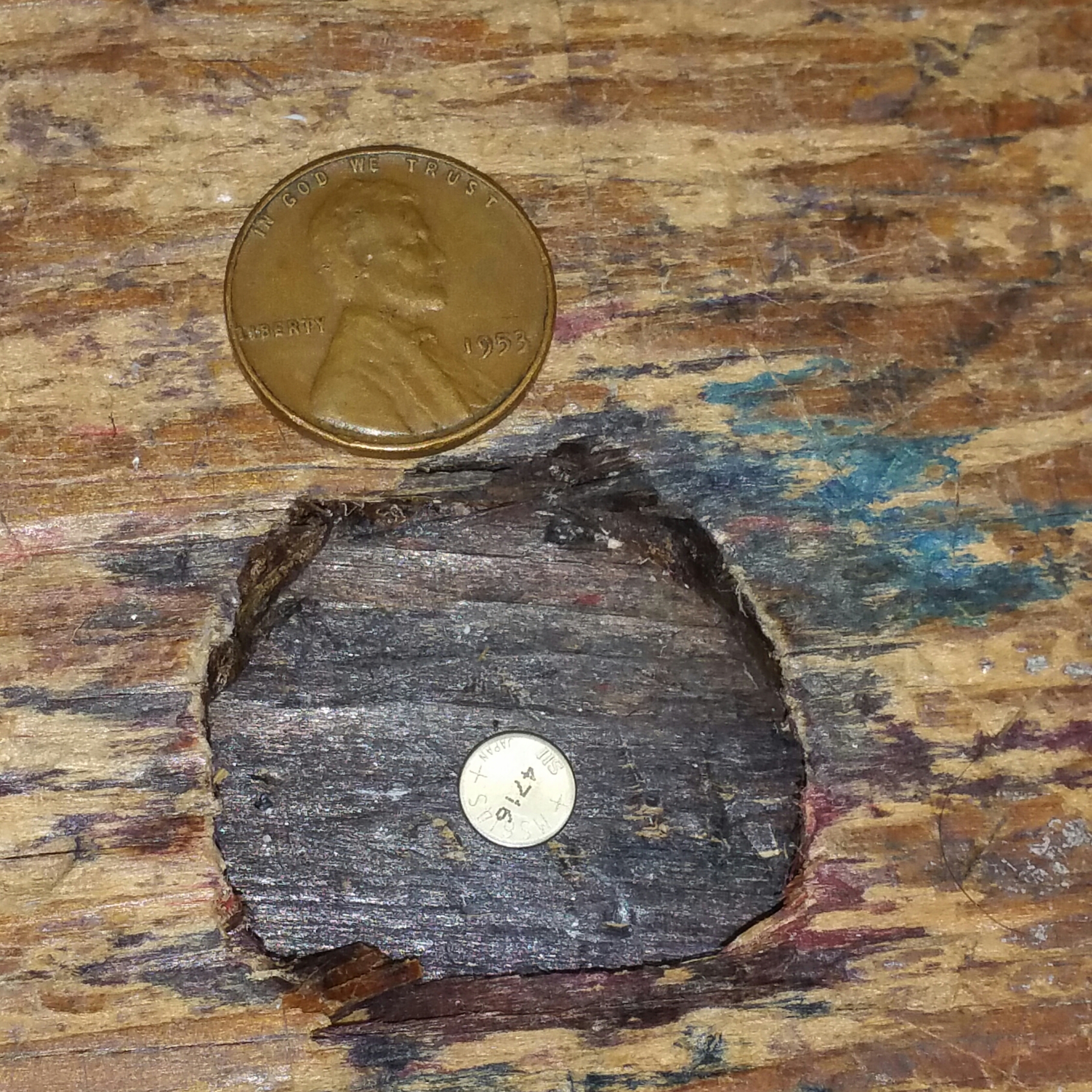

I tried to photograph the actually battery but the flash reflection simply wipes it out from the photo. Its too small.
The one that caused the hole doesn't cover a single letter on the posted battery in the pic... this larger one Which has enough compression energy to blow through the 4x4 brace and plank board top.
A cpu bios battery could in theory destroy a 12" thick box.
So use you eyes and remove every battery and every potential battery you come across.
Let's keep everything safe.

My explosion in this case? Condensation and a shorted wire contact on a broken (corroded) bettery so small i didn't see it. Blew through the board and left the nice crater.
