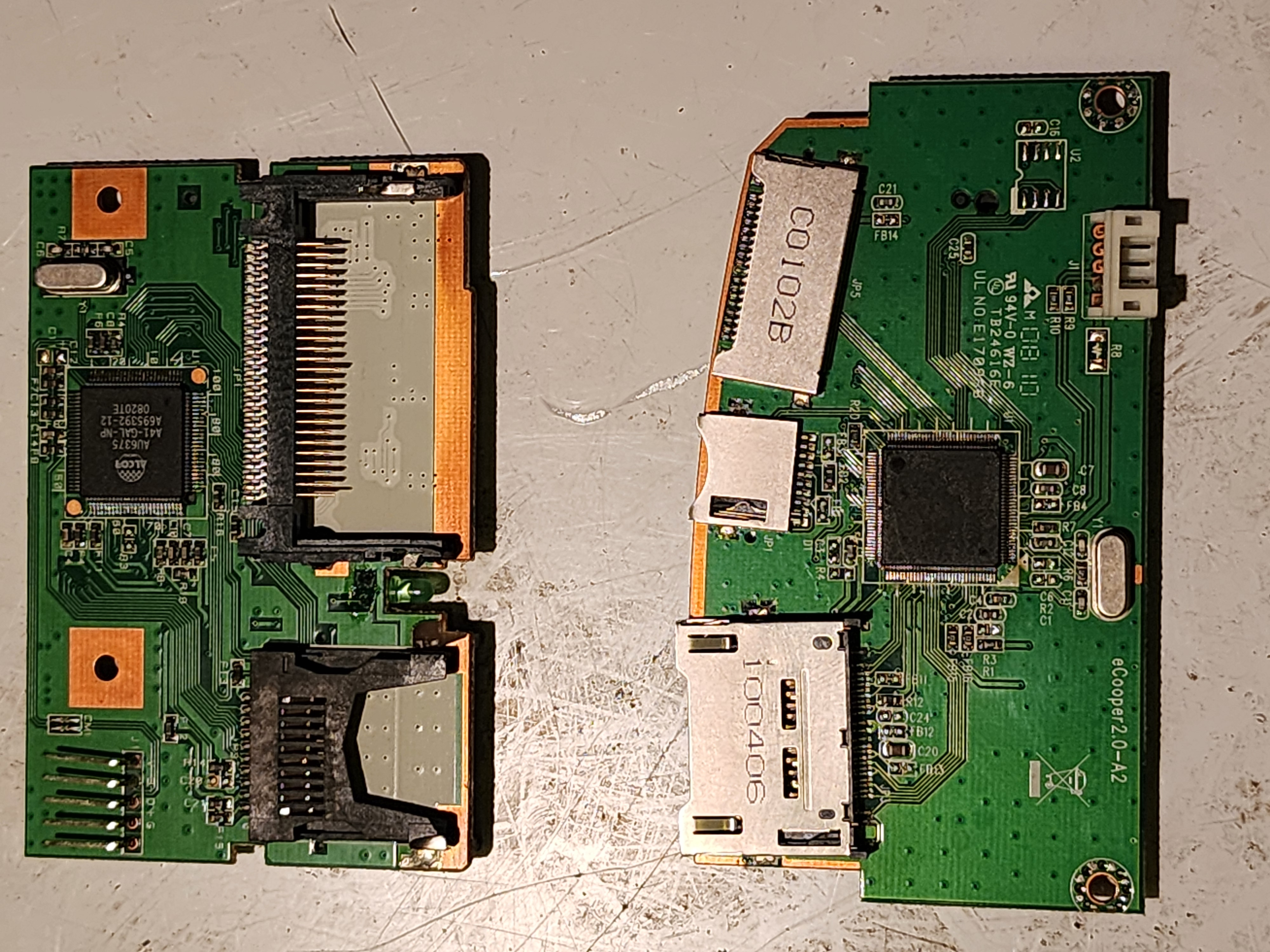

Oscar is giving me a different answer every time. Tearing down my old dead towers
Cd drives have 2 boards on them the upper is easy but I don't know if the lower is still considered the same. Pic attached with 2 of the lower sections. One I removed shielding of the port that wasn't soldered on.

Typically low peripheral
PostPosted: Mon Jun 30, 2025 1:41 pm
I would go high peripheral on those.
Tab corner ICs and gold pins

Cat is right again. use the source photos and videos and Oscar first.
But when you find a conflict with Oscar, always feel free to post here in one of the more senior users would direct you
I definitely do high peripheral in both of those two boards without a doubt given their extreme lightweight and population. You have no issue there.
