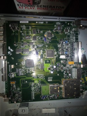

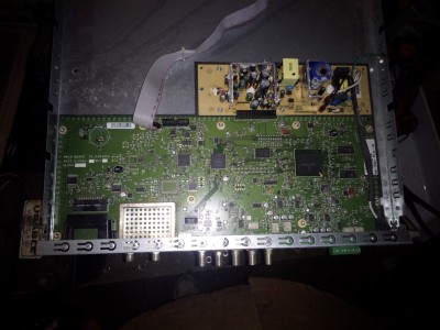

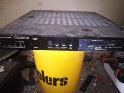

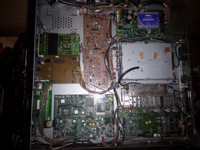

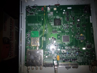

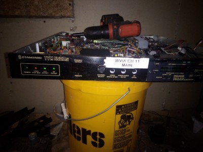

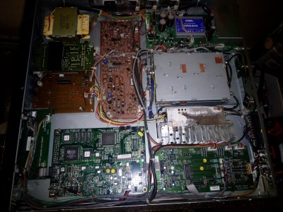

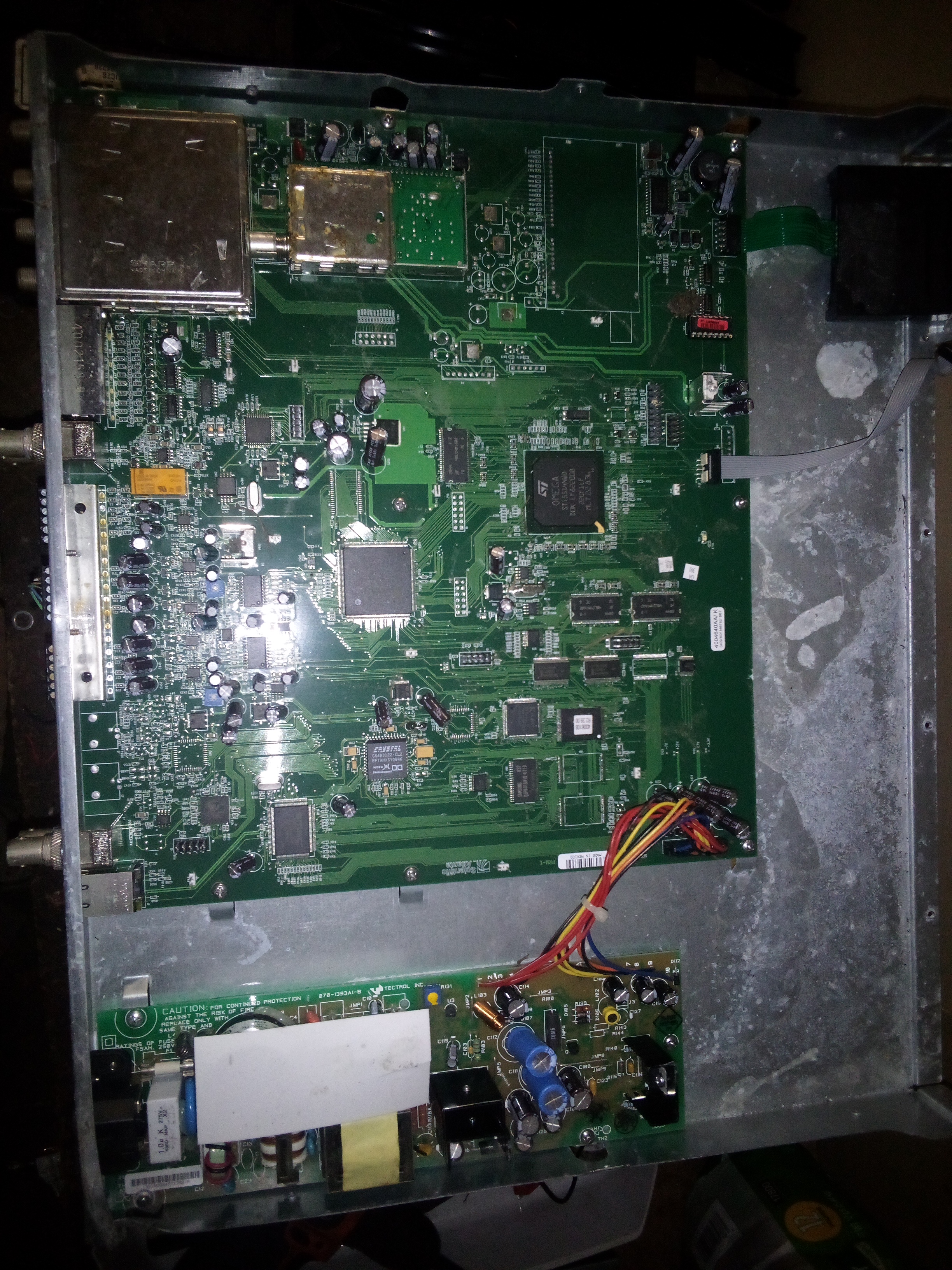

Hi I came out there about 10 years ago I brought a big load out there to you. Well I have another big load in the works and have a question. I have probably one hundred of these boards. These came from the cable company. However they are not from those little cable boxes these are from rack mounted servers that controlled the channels. They upgraded and I was fortunate and privileged to get them. How would you grade these if you would please. Some good stuff in there. This is just part of the load I have. I have a monster load I'm working on probably coming out there early spring.

My guess off hand would be high peripheral.

In picture #19 and #15 there are some low grade boards that will disconnect from the high peripheral board. Also #21 has a large transformer that you can remove and break apart for #2 copper.

Good eye: yes, detach the power boards.

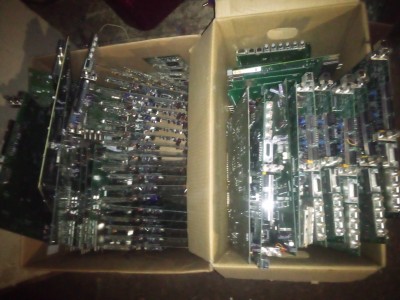

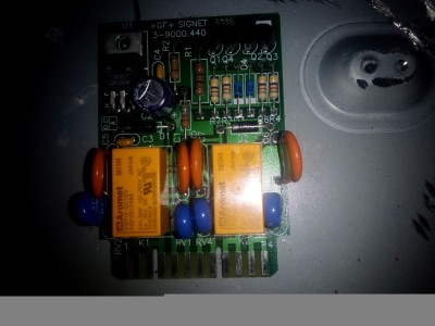

I forgot to add that I also have a lot of boards from the milk plant here they upgraded and basically just gave me all there old equipment. They are from milk testing equipment and other milk plant machines. Looks like some quality old school stuff I'll be putting some pictures up here in a little while so check back later thanks : )

These are from the milk plant equipment.

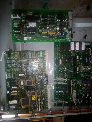

pick oo3 has a dallas switch that has to be removed. you will get better responses if you can post individual pictures of each board, after you have fully processed them to where you think they need to be. that way we can more easily grade them and tell you if there are more things that need to be removed from them. thanks
