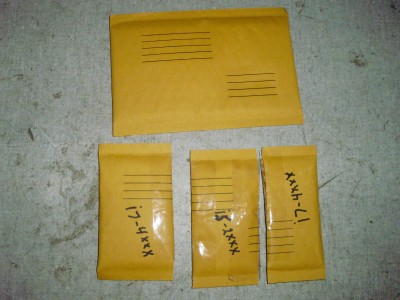

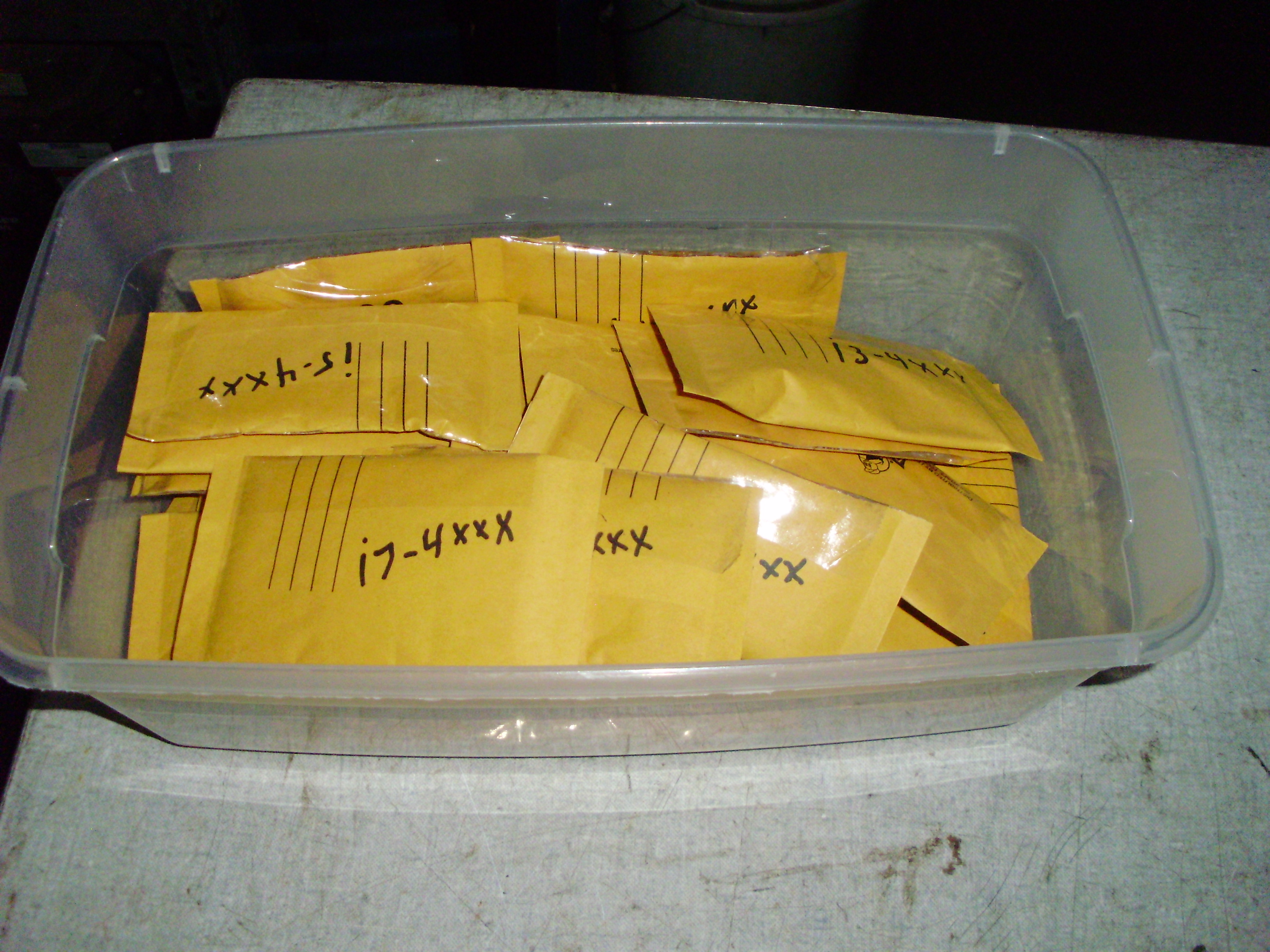

I buy the small 4x7 bubble envelopes at wally world and cut them in three then tape it shut. Having a 2+x4 bubble wrapper to put the cpu in. I mark the outside with the cpu # and then when I am ready to send them in I just have to go thru and fill out the list. I already have them packaged and I know what is inside.

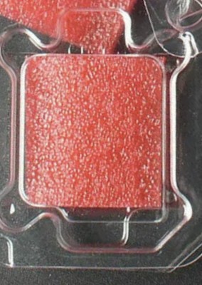

Clamshells work for individual CPUs. They run around 10-15 cents each.
There five standard sizes.
Large pin (pentium era ceramics, black fibre, modern AMD)
Small pin (486 sizes)
Wide pin (pentium pro, opteron)
Large LGA (sun, HP)
Small LGA (core, I series)

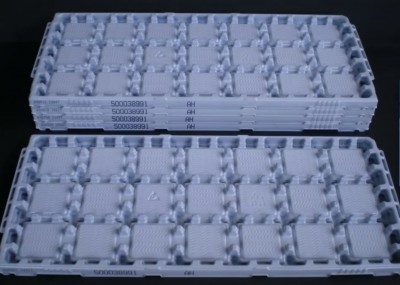

Trays come in 4-20 cpu sockets. In even numbers.
Small, large, and wide
Crafty people can very carefully cut double-wall trays to single chip trays.
Trays start around a filler each though. And wequire packaging knowledge.
Don’t get caught up in “designed for xxx cpu”. No generic trays are designed for any specific processor.

Cpu trays are nice for storing but not practical for shipping. We use many trays in-house, but we would never ship cpus in a tray. They would immediately all fall out and the trays are not designed to be "locked" together, even with tape. Don't use trays. Customers who have were dissapointed by the condition by which they arrived.
