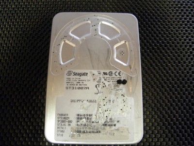

I found this HDD in a 1996 Packard Bell Multimedia D130.
Technically, I am still a newbie. But, I have opened enough HDDs to know where the “secret” screws usually are hiding under labels and stickers. I need help on this one. I was doing fine until I wanted to get at the platters, etc. And, low and behold no secret screws that I can find under any labels or stickers.
Help! How do I get this critter open without a hydraulic press or plasma torch?

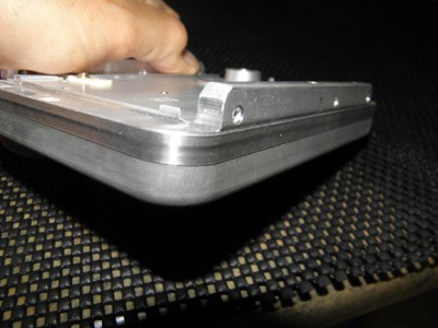

C4 works.

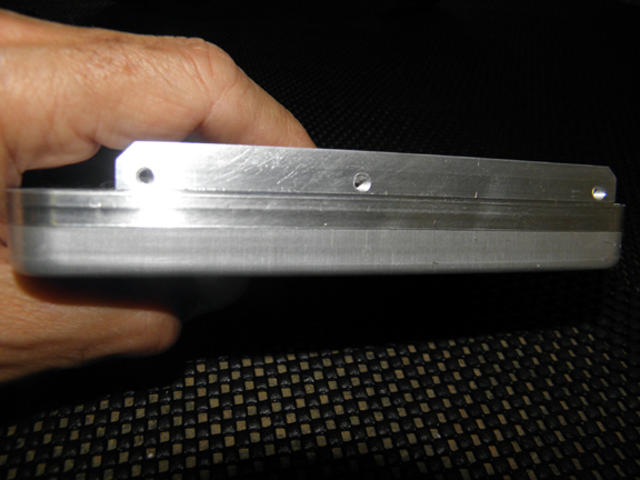

You need to pull the seam off the edge of the outside, that thin strip.
Then use a very small standard (flathead) driver to pry the case lid off. And use care with these, they tend to develop sharp edges that love nothing more than slicing through fingers.

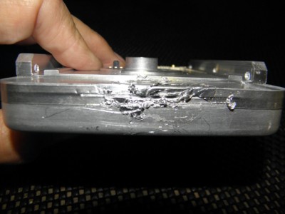

The first one had me so confused I literally ran it through a bench saw to cut it in half before I figured it out.

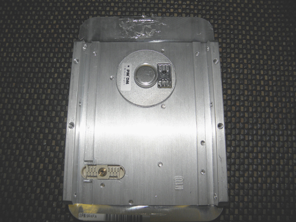

Dang . . . now that is what I call sneaky! Aluminized adhesive tape instead of screws.
However, no matter how devious these ‘puter manufacturers maybe, thanks to Mr. Lodos, my newbie education continues unthwarted!
