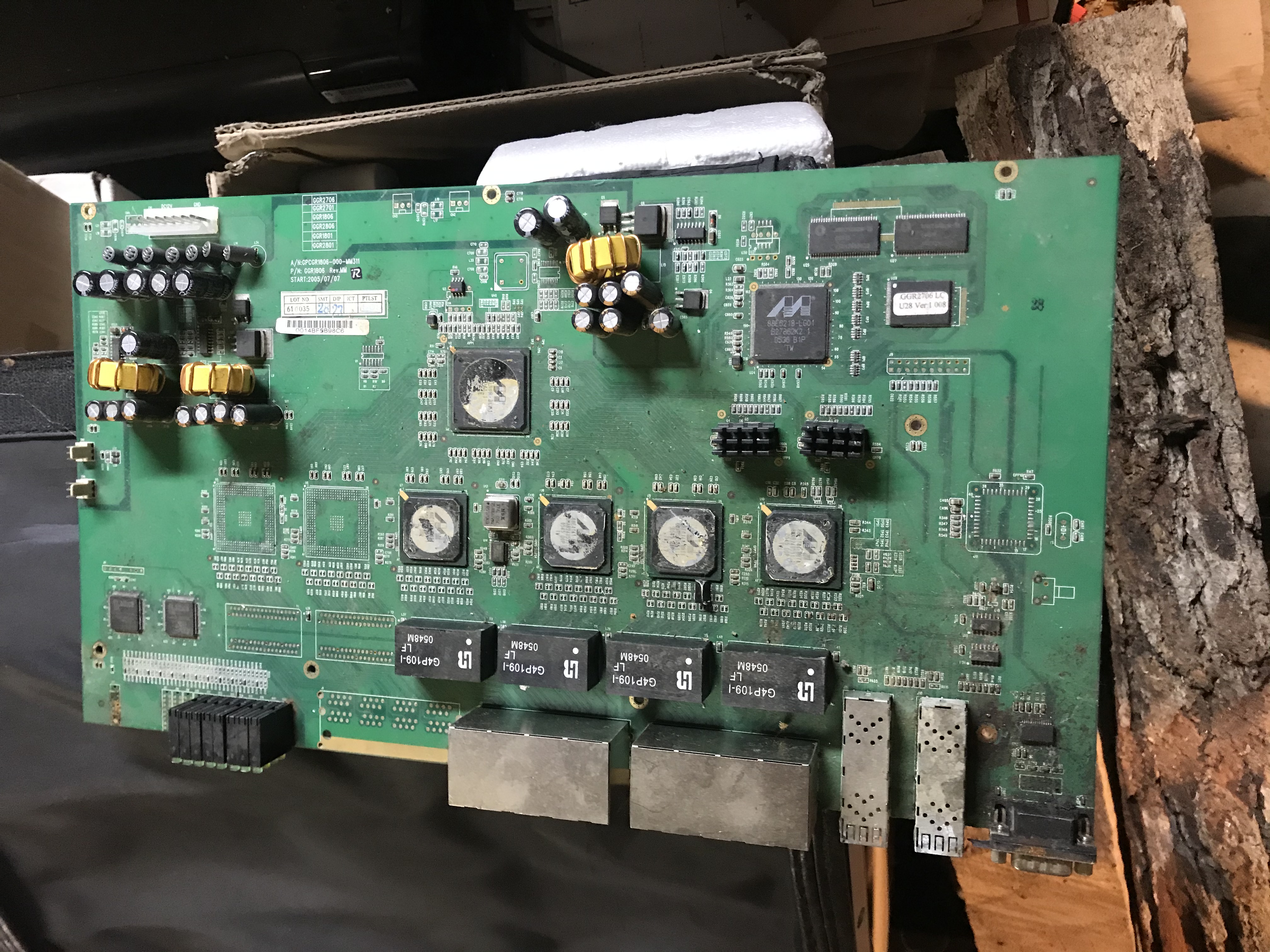

For example, in the case with this board- It weighs 27.3oz and has 5 gold tab flatbacks on it. I did the best i could and calculated how many of these chips weigh 1oz (based on ones i had already taken off and weighed. Not perfect, but you get the idea if the numbers are way different). If this board was graded Peripheral, it would be about $3.84. Without the flatbacks, its about $3.64. Though this particular one would likely be downgraded to Mid after removing the flatbacks so its about $0.51. The price of the chips that were removed add to about $1.61.

I figured I was likely over thinking it. Would you consider this a peripheral board, as is? I had it ID'd but not by any admins.

This one's high peripheral.

It's missing two chips but looks like they were never installed. the dual controllers run the I/O bank and the missing bank was clearly not installed. So I'll go with this not being modified.

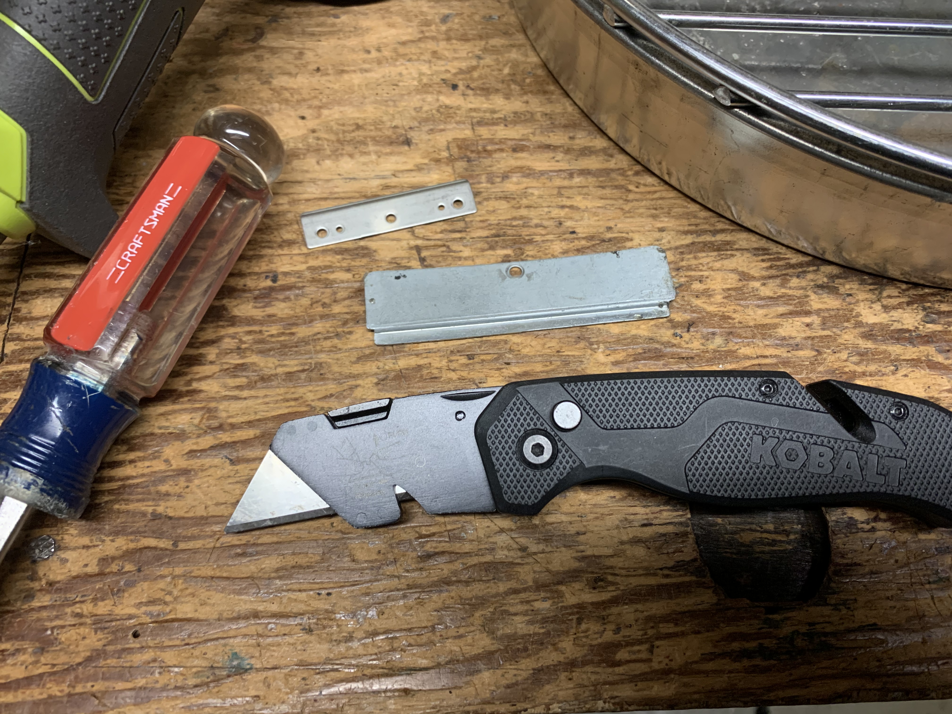

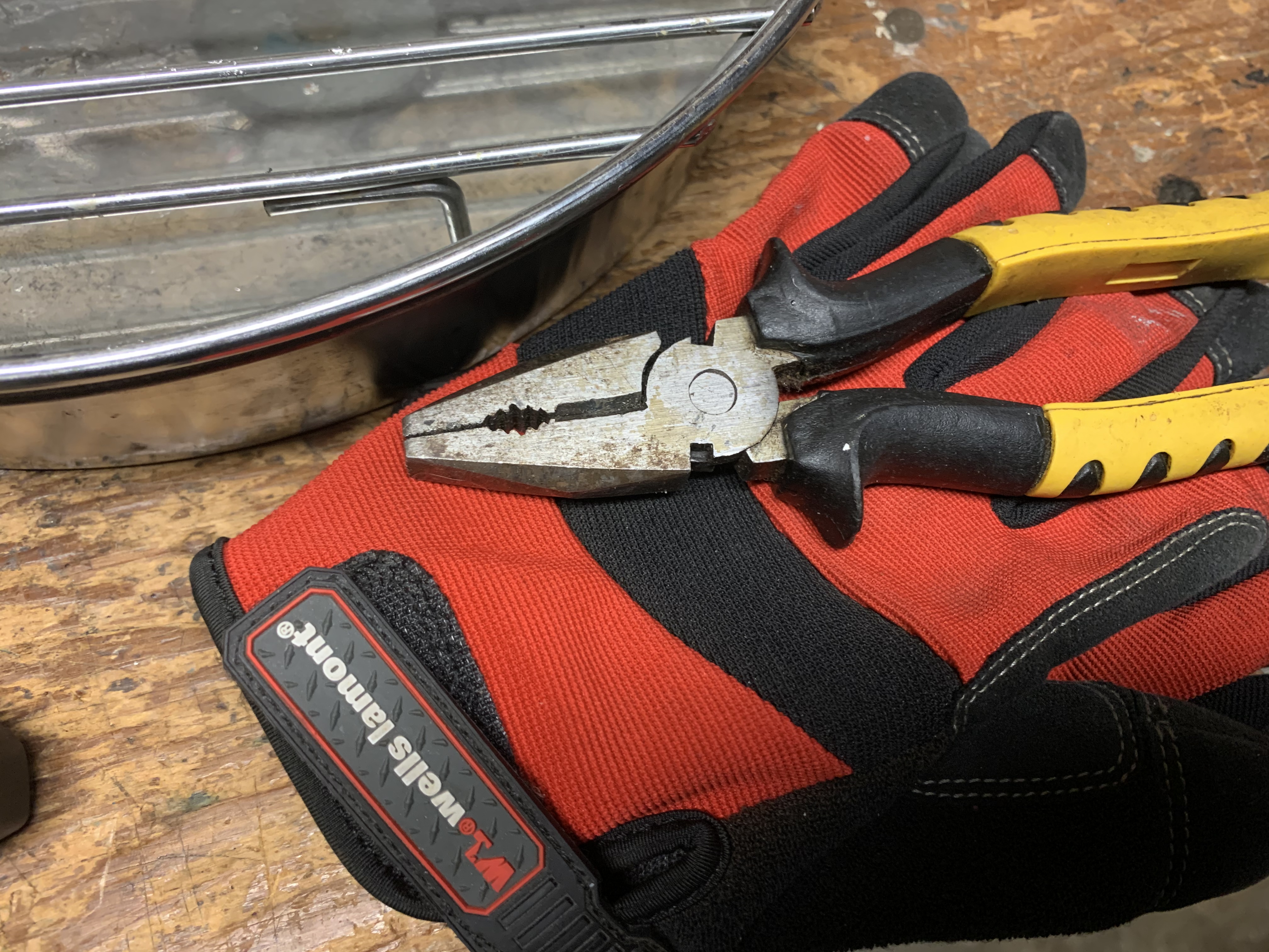

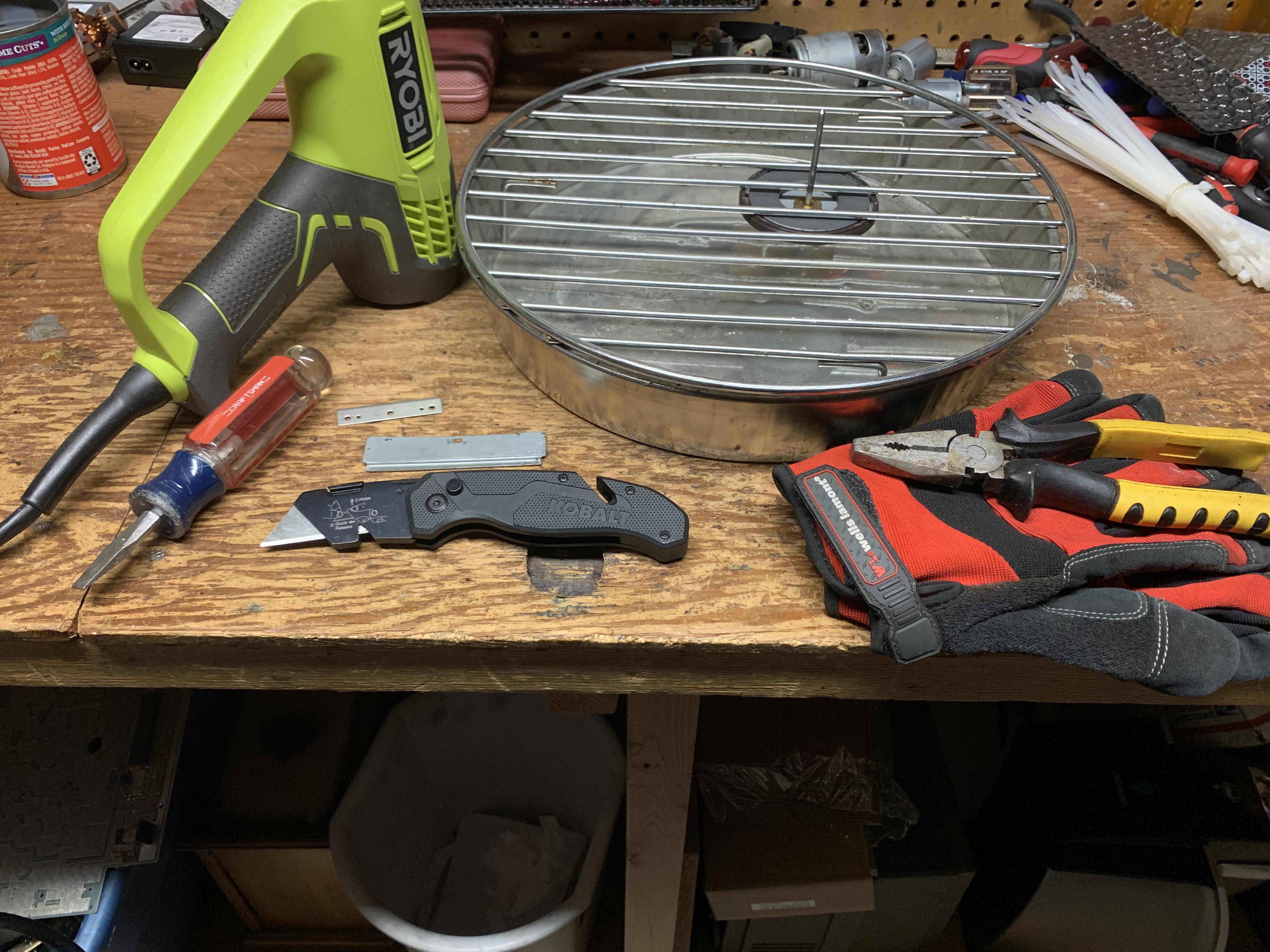

Most suggest an air chisel or electric chisel.
That definitely works and quickly: but it’s destructive and you should still remove liquid/oil canister capacitors first.
There’s no fumes in this method so a plus there.

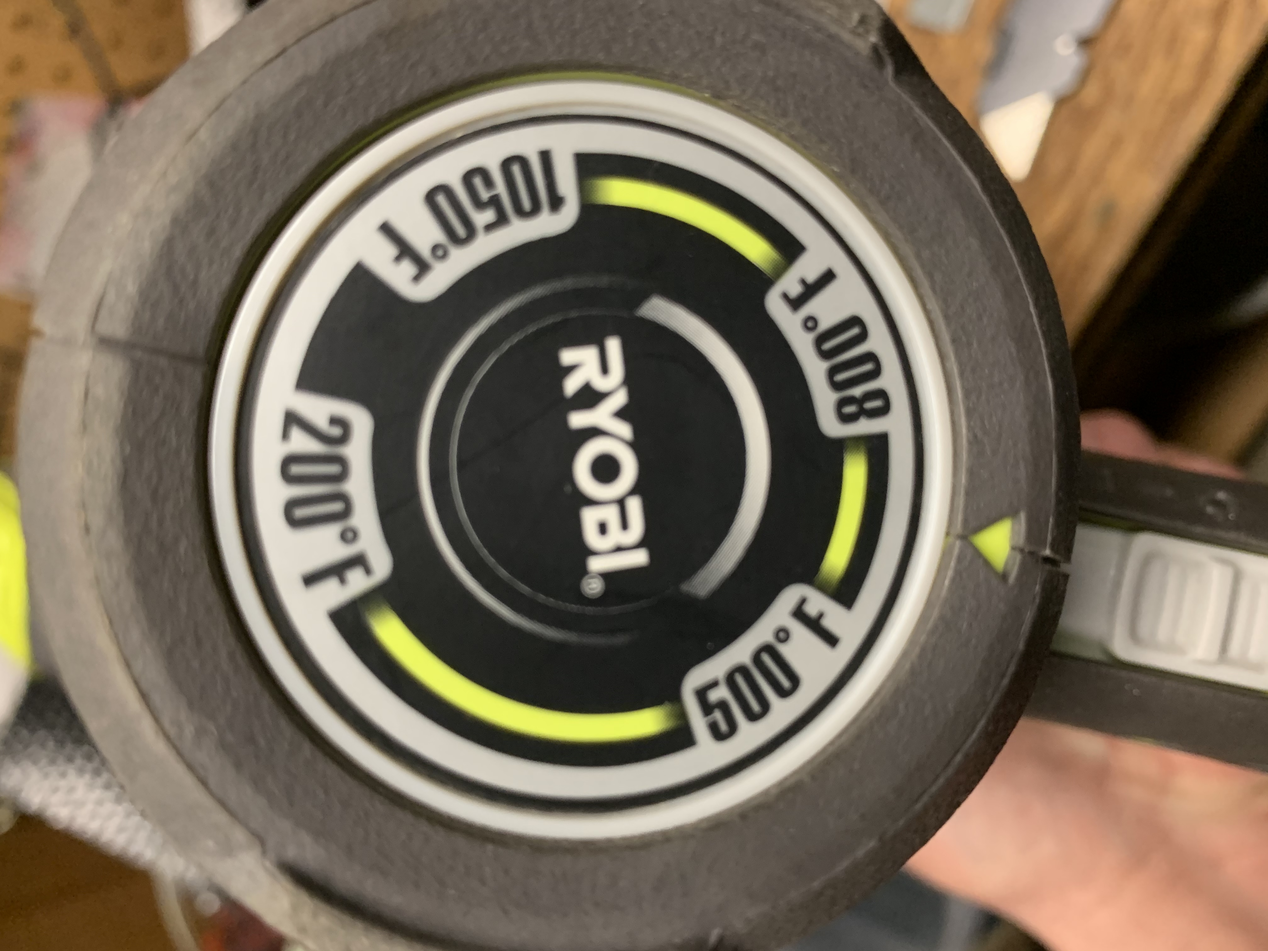

Personally I prefer a heat gun. Each gun is slightly different but generally somewhere between 750-850 is just right to melt solder at about 6” distance.
You can go higher for faster removal but you start melting plastic components. Anything above 900• and you can set the board on fire easily.
If you use a heat gun do so outside or, if inside, with good strong ventilation, preferably with a commercial air purifier. You will make fumes.
