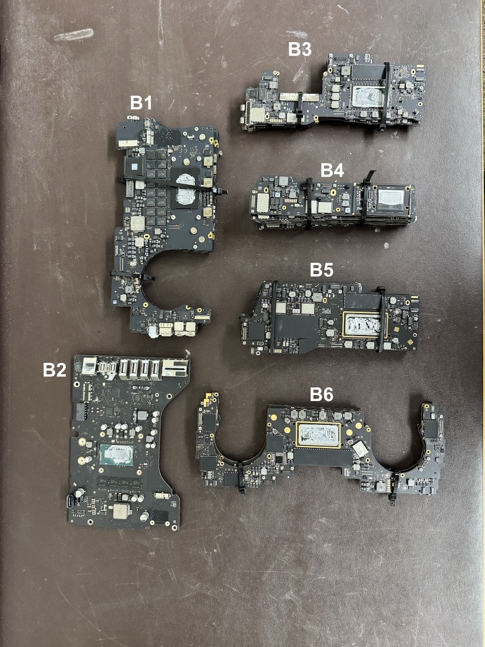

I am sorting the best I know how but I have a question on integrated boards. I many boards that are what I would consider integrated boards. however, I noticed some of them have a gold ring around the chip. Seems like that would be work more than an integrated board. what do you think?
See B5 and B6 in the photo
