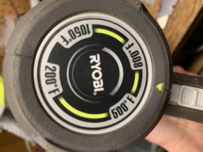

Personally I prefer a heat gun. Each gun is slightly different but generally somewhere between 750-850 is just right to melt solder at about 6” distance.
You can go higher for faster removal but you start melting plastic components. Anything above 900• and you can set the board on fire easily.
If you use a heat gun do so outside or, if inside, with good strong ventilation, preferably with a commercial air purifier. You will make fumes.
