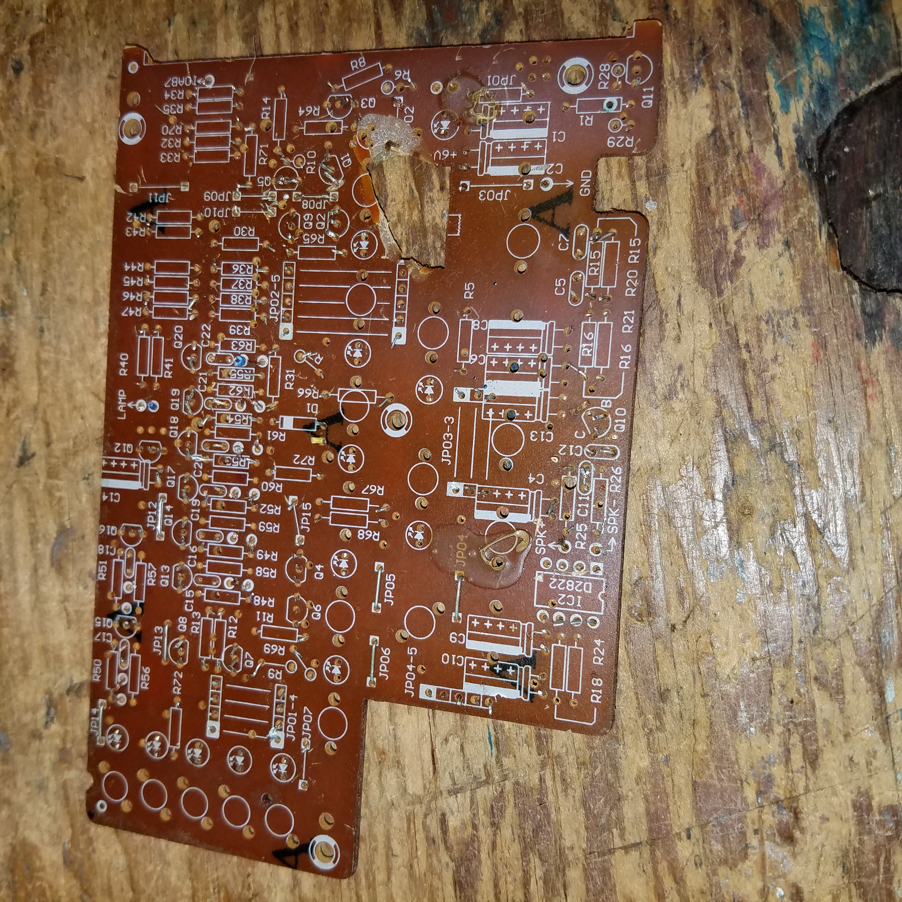

PostPosted: Wed May 18, 2016 1:10 am
Posts: 10618
I cut them rather than pull them now.
I cut them AT the board level as opposed to pulling them out. when I'm done the board is (relatively) smooth. Anything inside... stays inside.

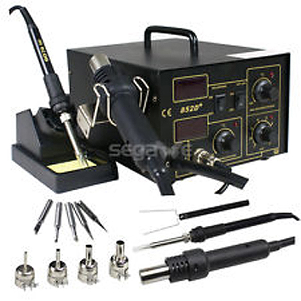

Anyone ever try one of these to depopulate with the hot air nozzle?
Hot Air Temperature: 100C to 480C
Air Pump: Diaphragm Pump
Capacity: 24L/min (Max.)
4 Nozzles: (Ø3mm, Ø5mm, Ø7mm, Ø10mm)
I know that using one of these is not exactly mass production, but, I like the idea of localized and controlled air flow and temp. I don't like the idea of exploding thingies when using a sand bath.
Price points range all over.
An answer to a problem that is correct and efficient yet pleasing to behold is that problem's elegant solution.
PostPosted: Wed Mar 22, 2017 3:35 pm
Posts: 10618
That's a bit of overkill for simply depopulating a few boards. That's a full solder and reflow kit

The kit cosmetal posted is very similar to the one I use for actual repair work. But I would never in my worst nightmare consider depopulating a mobo with one. You're looking at HOURS of tiny hole poking. Not even the best consumer boards are worth that kind of trouble to me.
Now a 14 inch drive controller from 1970? Maybe; with its short run ICs custom chips and solid gold pins... maybe. But not anything modern.
Unless you enjoy doing so; but you're not really going to earn your money in the time spent.
Not to mention a kit like that of any worth is going to start in the upper hundreds and the best climb 6 digits.
