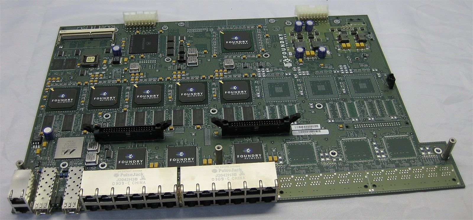

I did not want to take them apart unless they are worth taking apart,as they are worth 20.00 the way they are, but very hard to sell, they would have to be telecom price at least, i was hoping most 24 port switches would be telecom,let me see if i can get a old pic from the factory.

[img]
[/img]
 Post subject: Re: what grade
PostPosted: Fri Sep 12, 2014 4:03 pm
That would be telecom grade given the flat pack population on the board and number of what appear to be tantalum capacitors present.

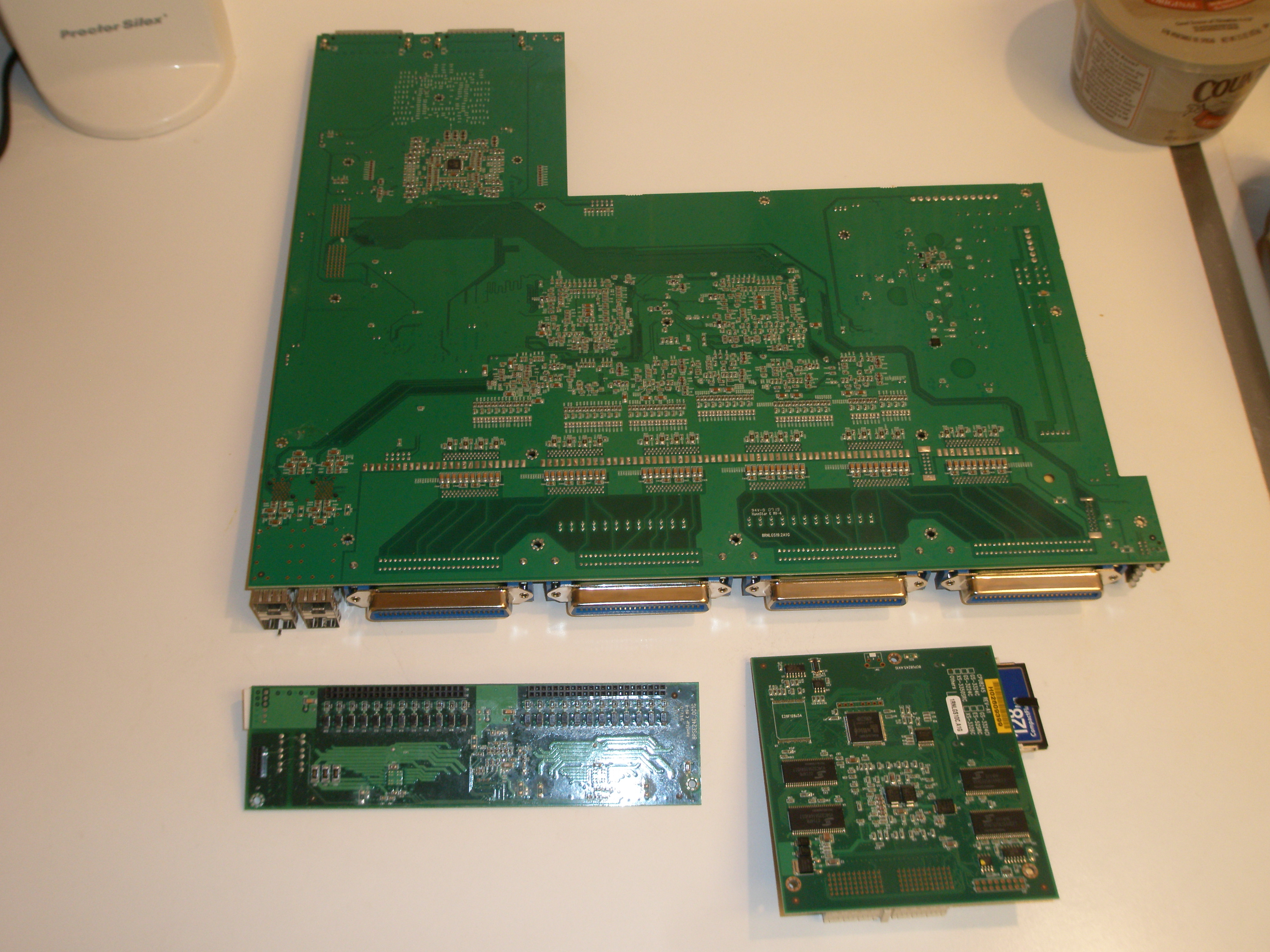

[img][img]

tyvm for the very fast reply, i took 1 of the Enterasys apart, there is 3 nice boards(view pic),i only have 4 of these units, but on the great side i have 160 of the foundry motherboards lol, are the Enterasys telecom as well?
PostPosted: Sat Sep 13, 2014 8:01 am
This other router you have doesn't appear to have the IC density that the Foundry switch has. I would consider it as a small socket motherboard since it has a soldered CPU and gold pins.
