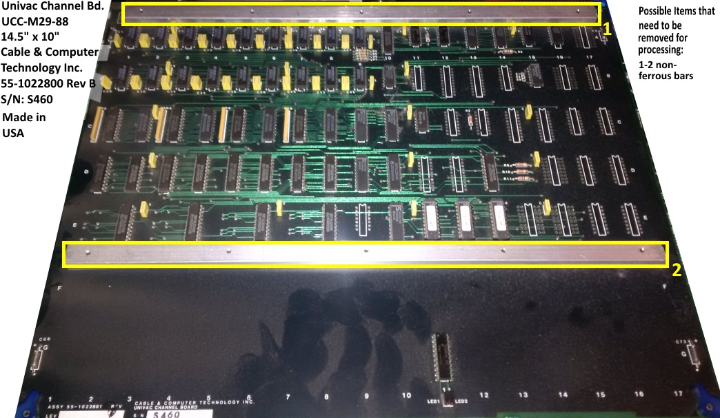

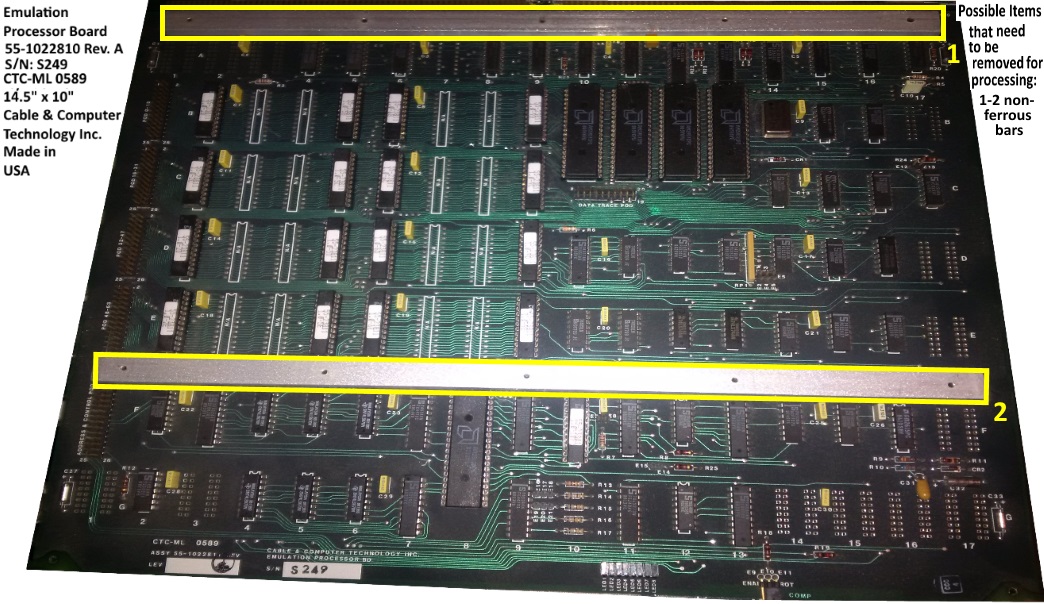

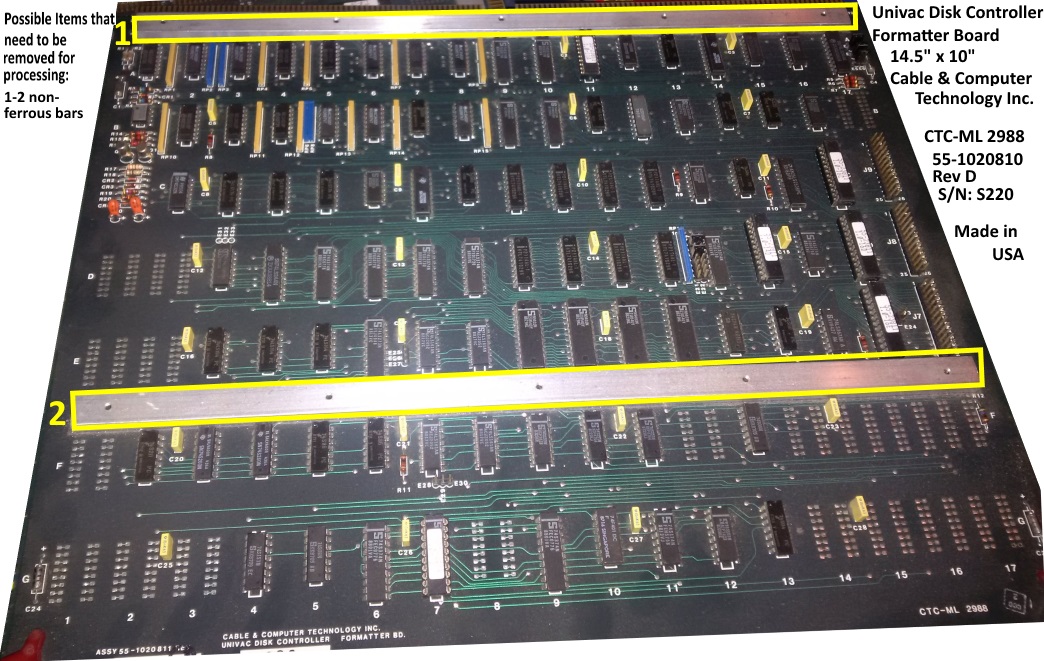

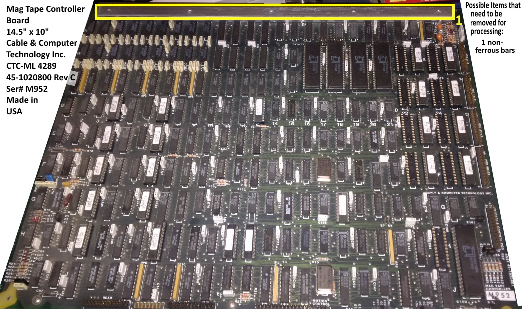

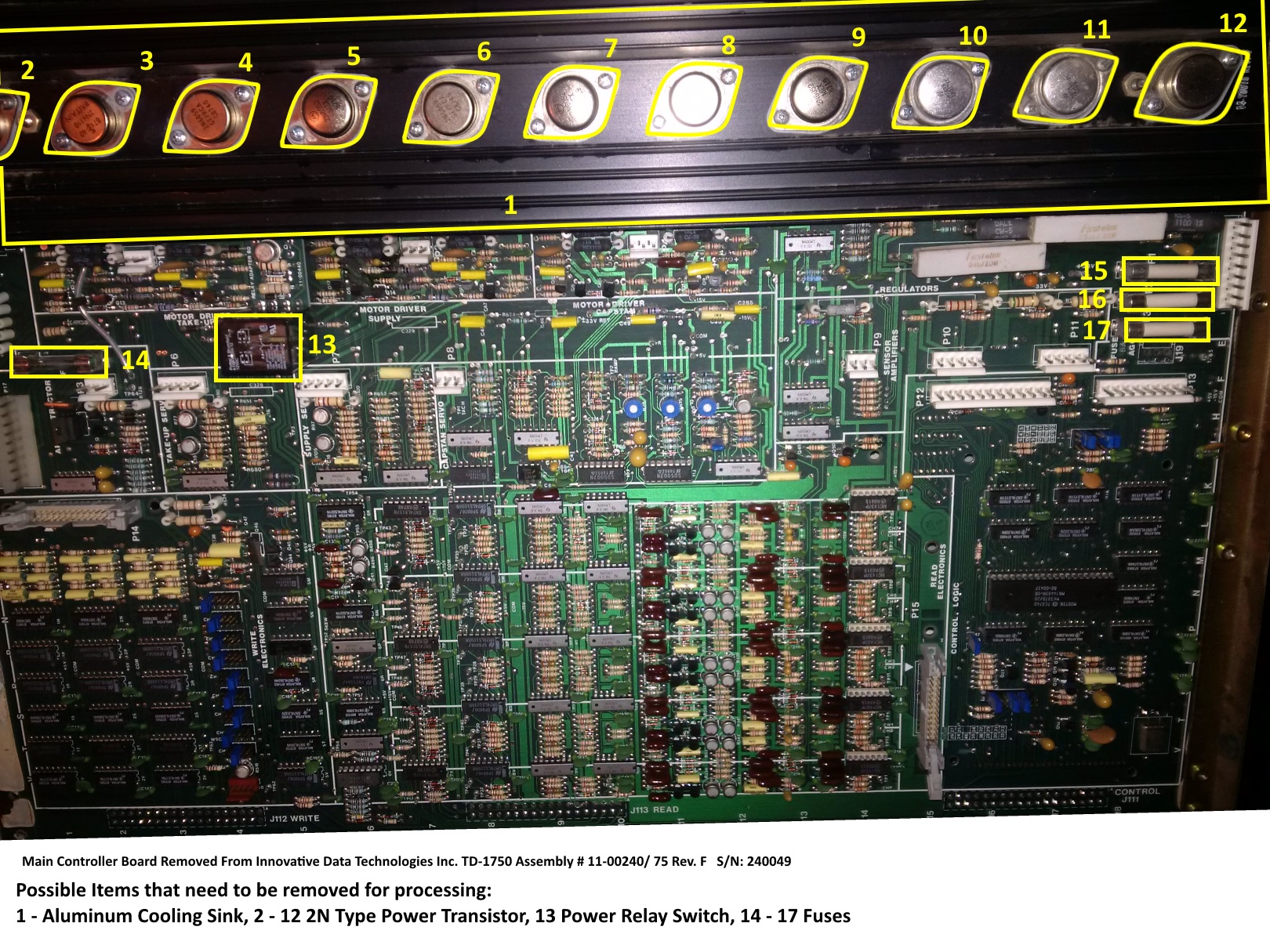

I salvaged a number of system boards from an Innovative Technologies Inc. TD-1750 9-Track Data Storage System. The boards are large 14" x 10" or larger so I would like to know if I would loss any value cutting them up. I have highlight bits that I think Boardsort would want removed. The main controller board has an Aluminum heat sink with 12 2N Type Power Transistors that I'm not sure how to remove unless I cut it off the board. It was a real interesting salvage, it appeared to be hand assembled in the Silicon Valley, all the board say "Made in the USA". I've included part and serial numbers where available. When new these suckers weren't cheap, I found an old article announcing its release in 1984 starting at around $10,000.

The main board will go as peripheral or large socket depending on the type and quantity of actual CPUs and controllers used.
Rest is telco.
Don't worry about pulling soldered and riveted stuff. If the fuses are socketed though I'd pull them they're usually a silver nickel tungsten fuse with silver nickel caps on the ends at that age and are worth around $7-10 per lb as scrap. If soldered they're almost certainly nickel caps and worth about the same as the peripheral rate for the boards.
Nice pick!
Ps your question about cutting you're ok snapping them in half but I wouldn't go for quarters or smaller.
