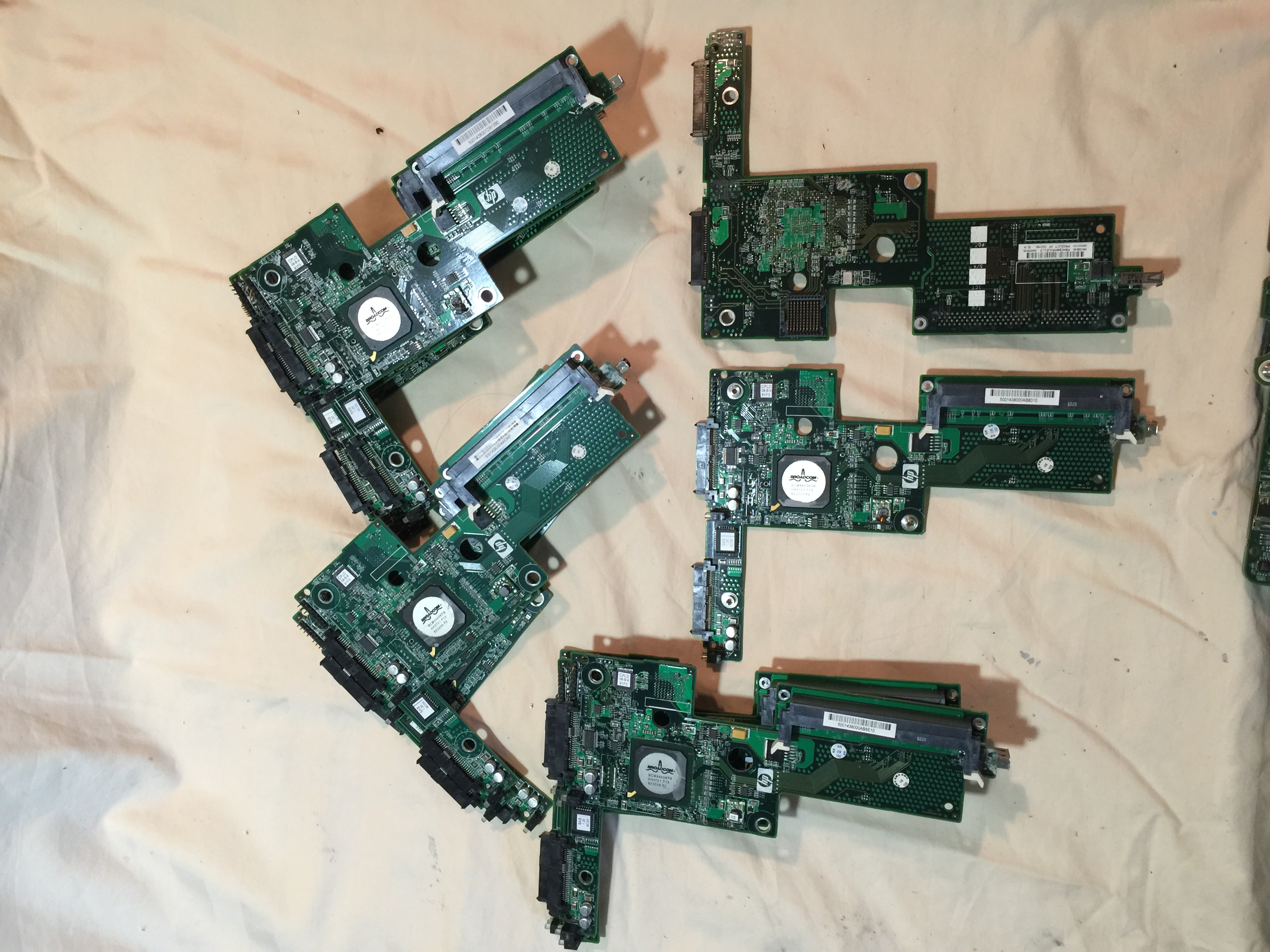

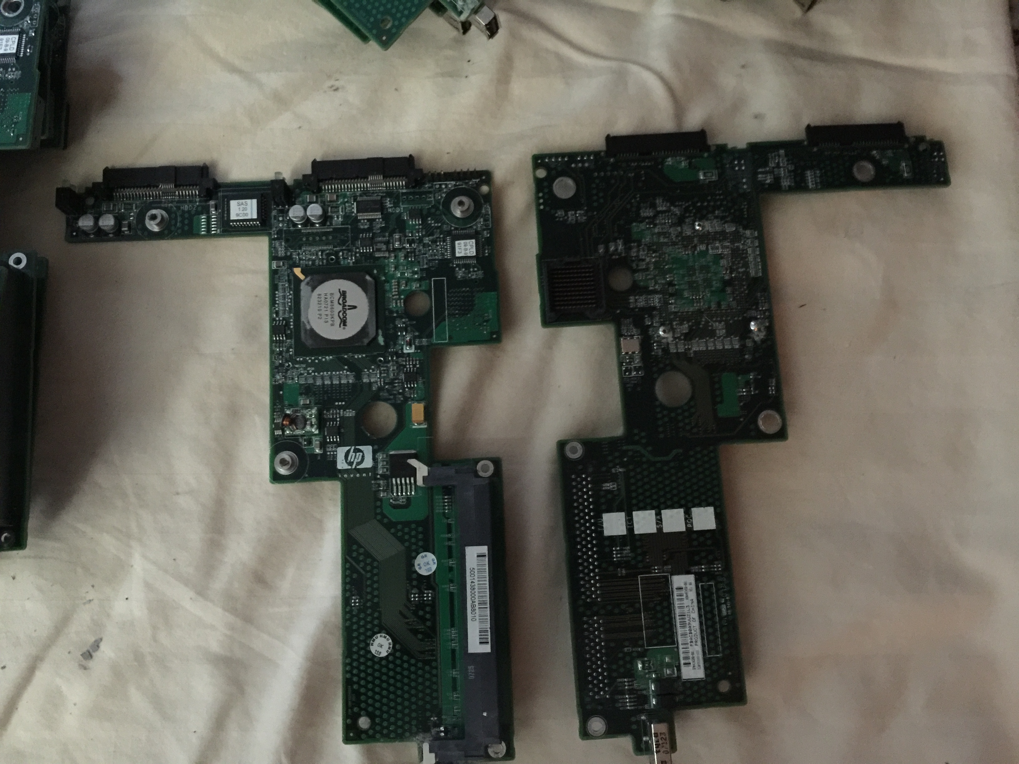

Hello All. I'm new to the sight and could really use some help , I'm trying to sort some scrap boards to send to Chris at Boardsort. I have a bunch of stuff that I'm not sure where to place. I did send Chris an Email with some pics a few weeks ago but I have not heard back. I would like to get this sent out so I was hoping that maybe you guys could help. I have been reading the posts and It looks like you guys know your stuff.
Thanks For Any Help
Genia

He's a few weeks (months?) behind in emails after the move.
All small socket

Can I safely assume that if they would normally qualify for peripheral boards but have the gold cornered chip on it that it makes it a small socket? OR does the board have to have gold pins in the for of connectors PLUS the gold cornered processor? I, also, am learning and figured WHY clutter the board with more posts... thanks in advance.

In order to make the small socket rate with an integrated CPU (soldered) it must have a ram slot or soldered ram, multiple io ports, a full CPU and a bridge chip (gold corner flat pack).
Soldered CPU motherboards usually should be verified.
PostPosted: Fri Aug 26, 2016 1:25 pm
Posts: 10630
In this case you have three external ports. Ram on the board. A ram socket. The Broadcom CPU, two I/o controllers, and a memory controller. Motherboard.
