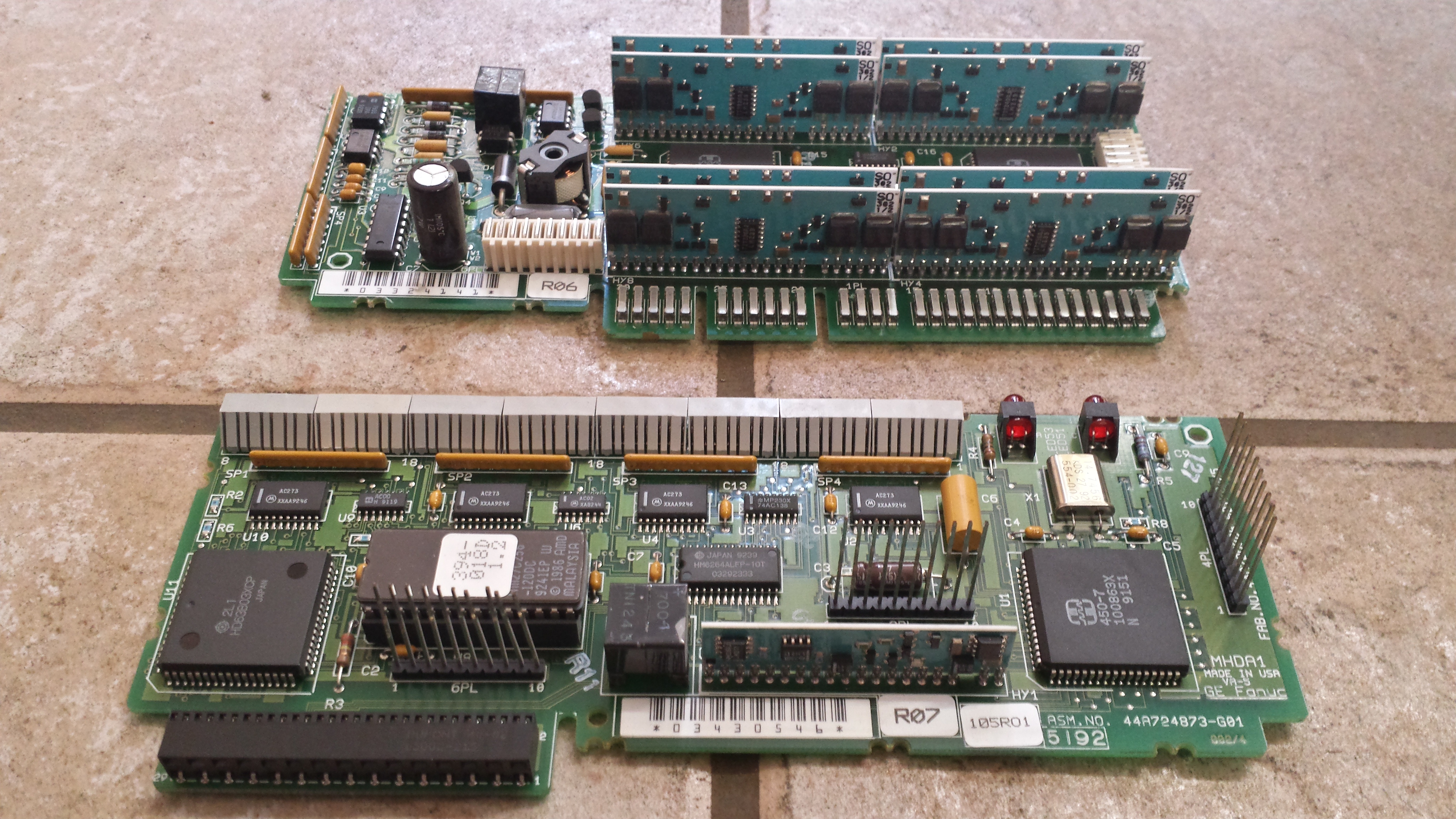

1:
gold finger card
mid grade or cable end (only pins and pin sockets on board)

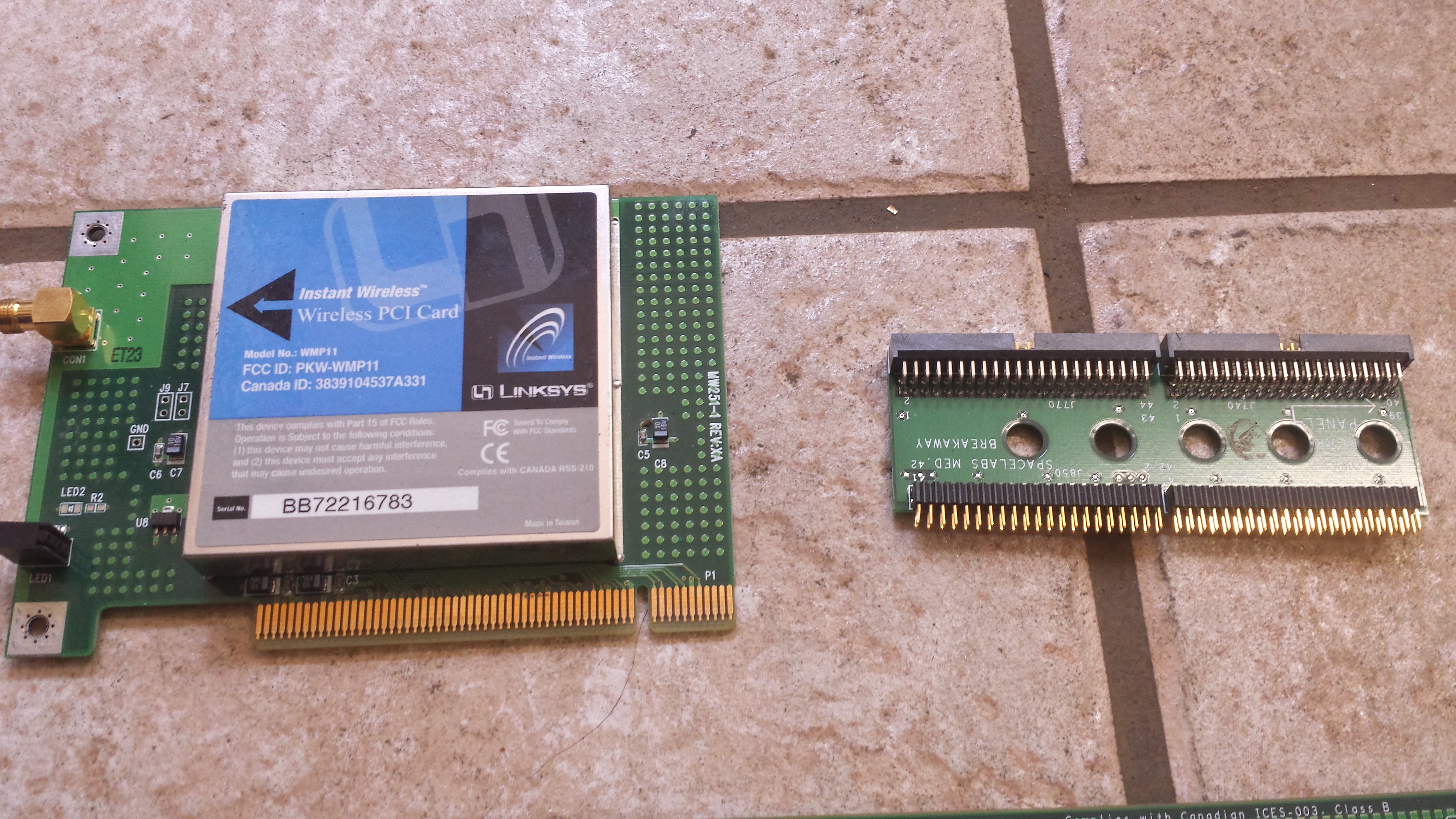

2 (other two boards not in #1):
gold finger card
peripheral

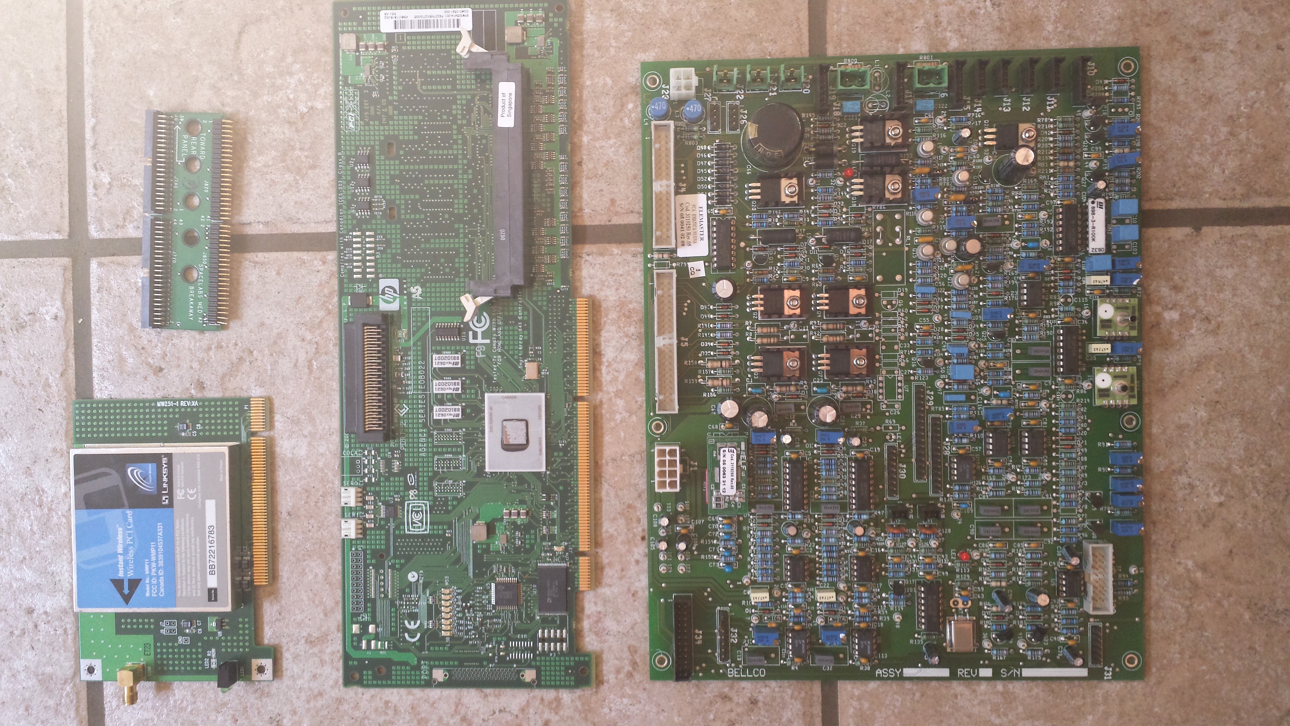

3:
small socket motherboard
small multi-socket motherboard

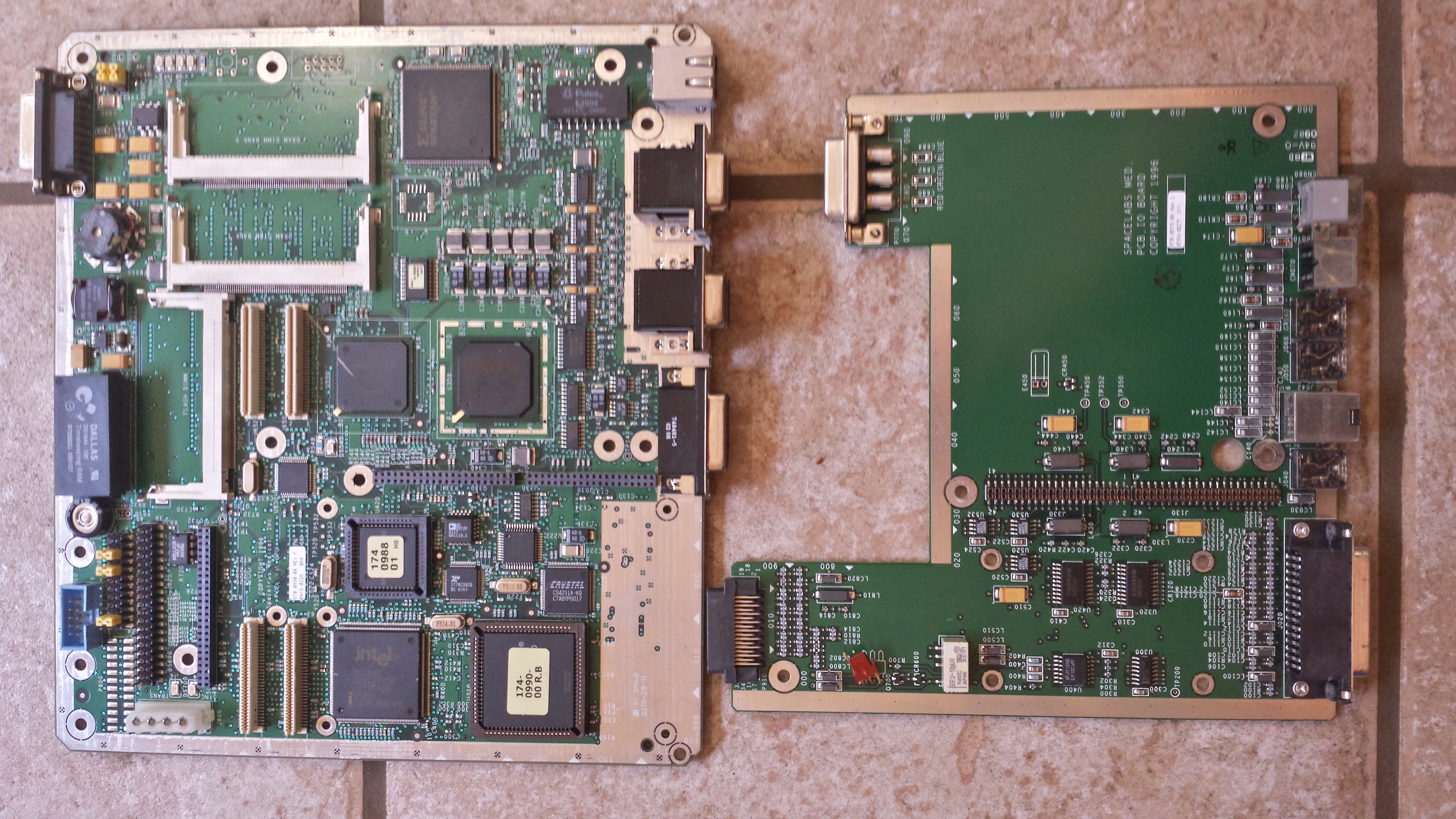

4:
peripheral
peripheral

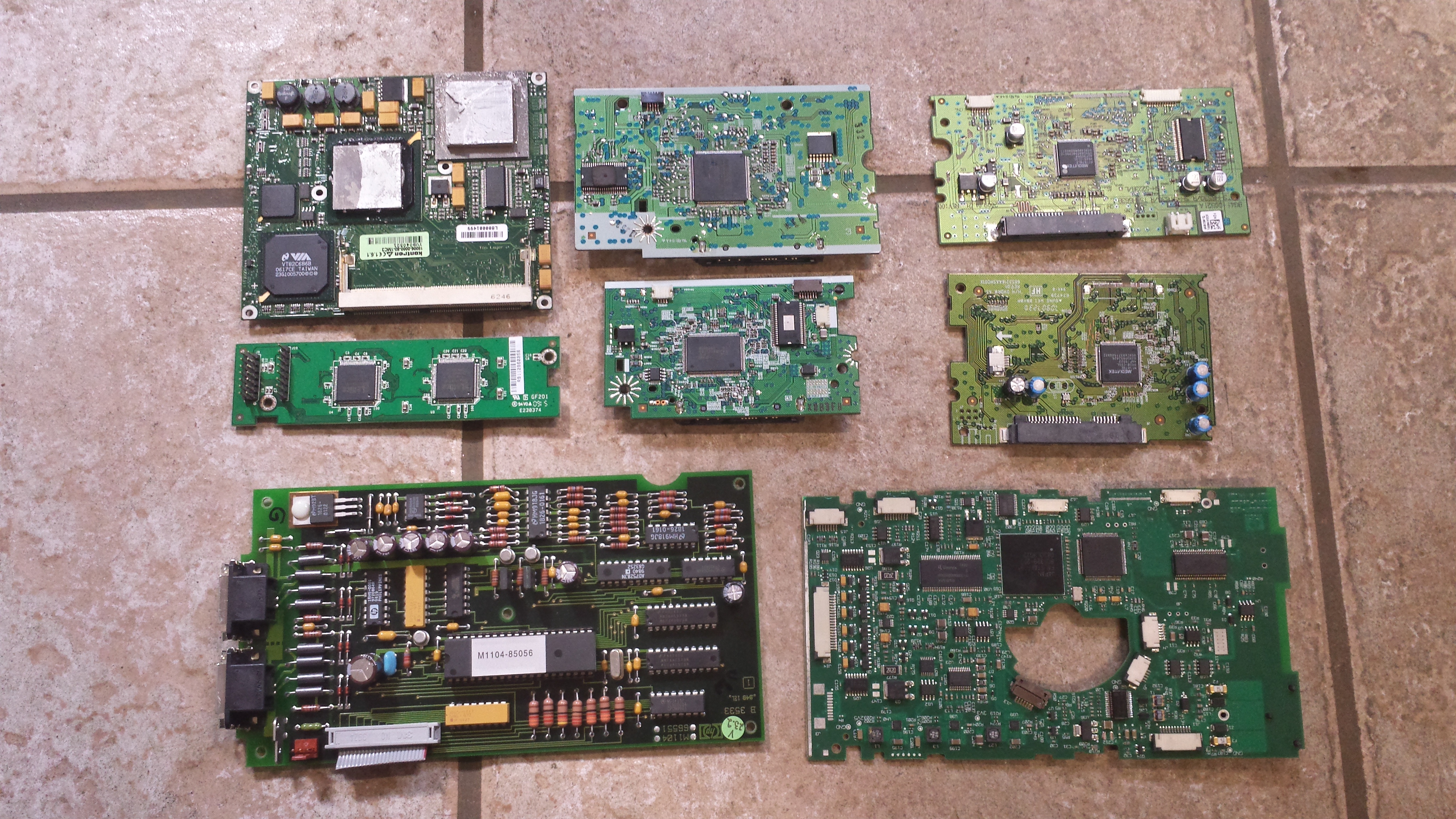

5:
mid grade
mid grade
CD/DVD board

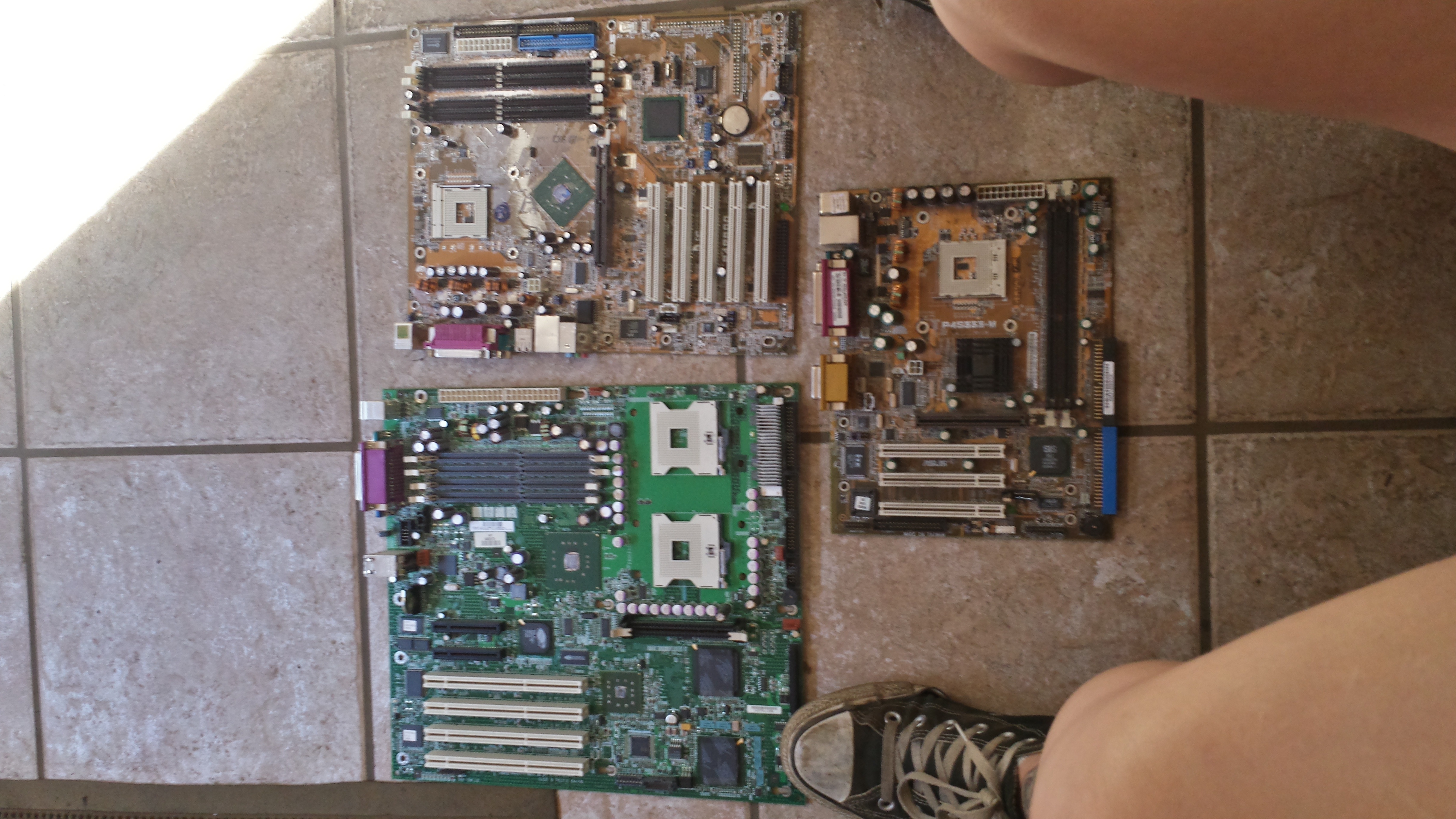

6:
peripheral grade
small socket motherboard (contains what appears to be RAM slots and processor chip is soldered to the board)

First pic your safe on peripheral there on the adaptor. No metal so Better than cable end.
4) is put the one with pins and IC chips only, not the one with the vertical boards, into telco class; leave the ics in the sockets
6) remove the Dallas box
