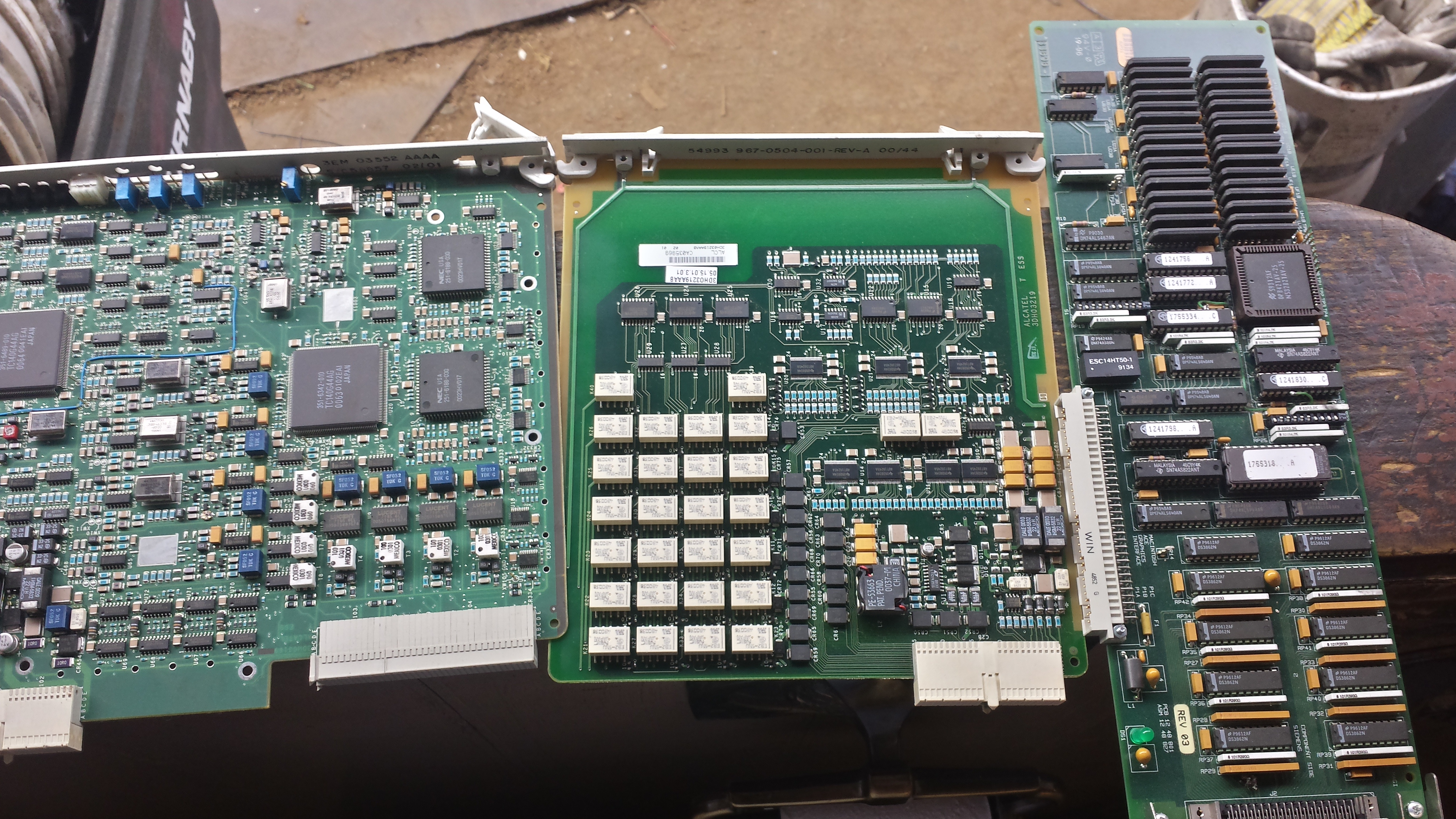

Totally new to the forum and escrap in general but I am very passionate about it and enjoying every moment I get to spend disassembling and grading everything; I am now at the point of starting to grade and separate everything we have amassed and so I am hoping you guys will be able to help me figure out the commodities I am not so sure of.
These boards, would they be considered telecom? If not, which grade should I be separating them into?
Thanks in advance for all the help and for all the future help I am sure to be asking for!

First may be telco.
Second looks more like a peripheral board, not enough ICs and a lot of relays.
third probably telco.
Again, wait for lostinlodos to make sure

RCM's assessment is how i would grade them as well

Left is large (old) multi socket or telco. Leaning on motherboard side.
Middle peripheral
Right is Telco
