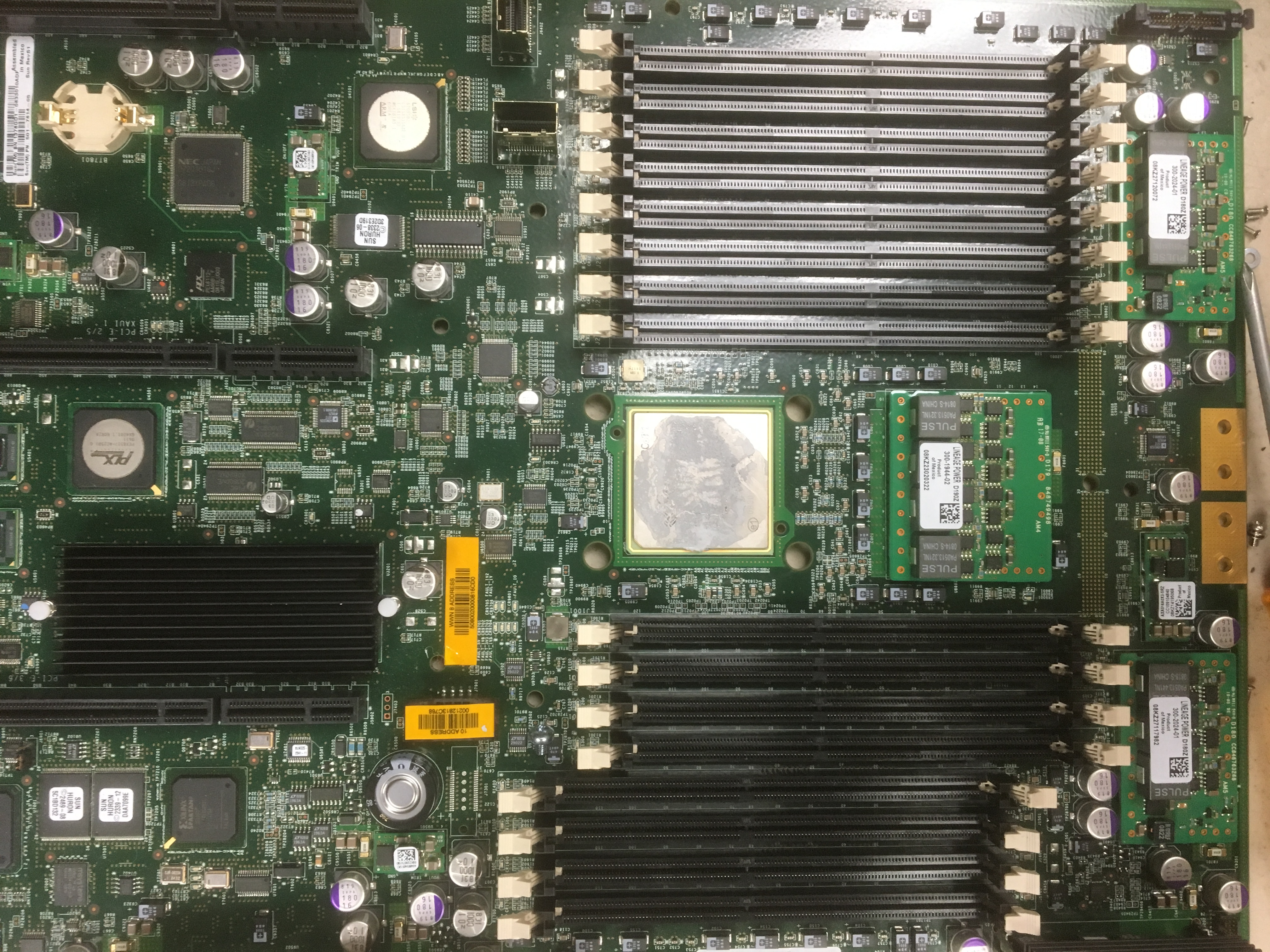

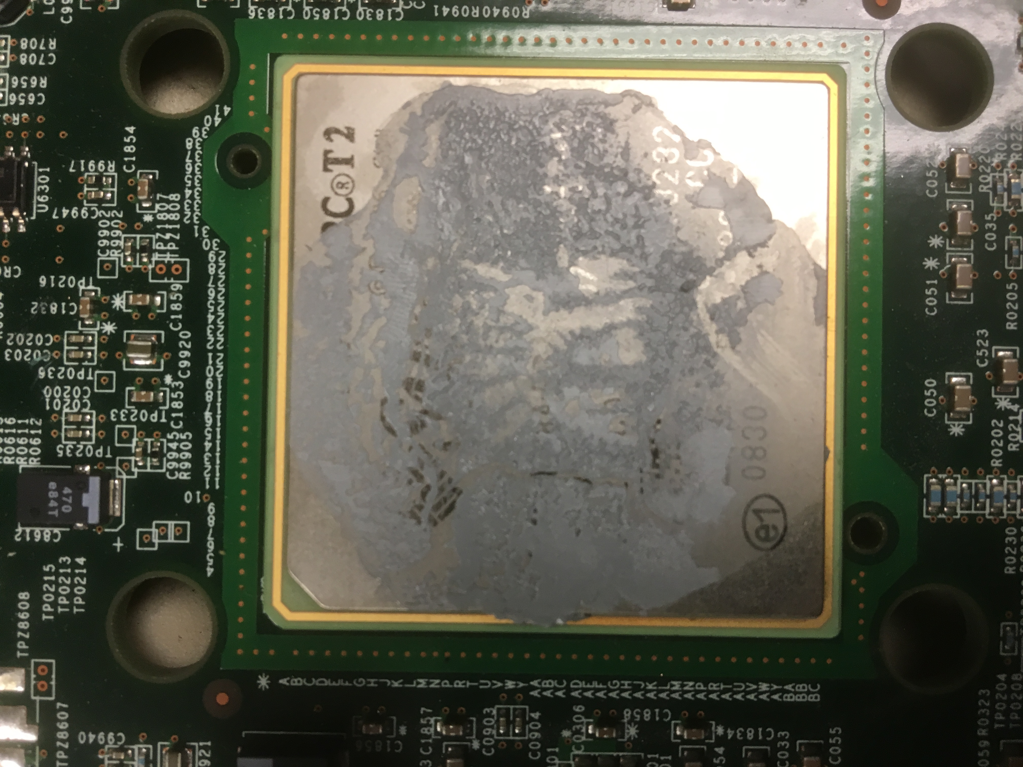

Hello,
Attached is a pic of the ceramic cpu.
Thanks,
Joe
PostPosted: Tue Jul 19, 2016 9:19 pm
Posts: 467
dont remove it... i think you have a better chance of getting a higher grade with it on there. at best it would go as a no pin processor (since you said you cant pull them off) and your board will probably go as small socket server board. With it on, i think you are going to get a large socket server board (at worst) and telecom (at best).
PostPosted: Wed Jul 20, 2016 12:11 pm
Posts: 10630
That's a nice CPU as is.
Unfortunately it's a soldered SGA. Studs. And the design makes a heatgun removal a waste of energy. You'll spend more in electricity then you're going to recover.
I'd take a guess at large single sockets, or dual small socket.
And I'm leaning to dual small socket despite the single chip. Because:
I can't tell the numbers under the thermal paste but it looks like a dual CPU in a McCP. Two separate CPUs on a single die. All the other requirements are there for a multi CPU board.
You probably won't get telco for it. There's not enough IC population to push it over.
