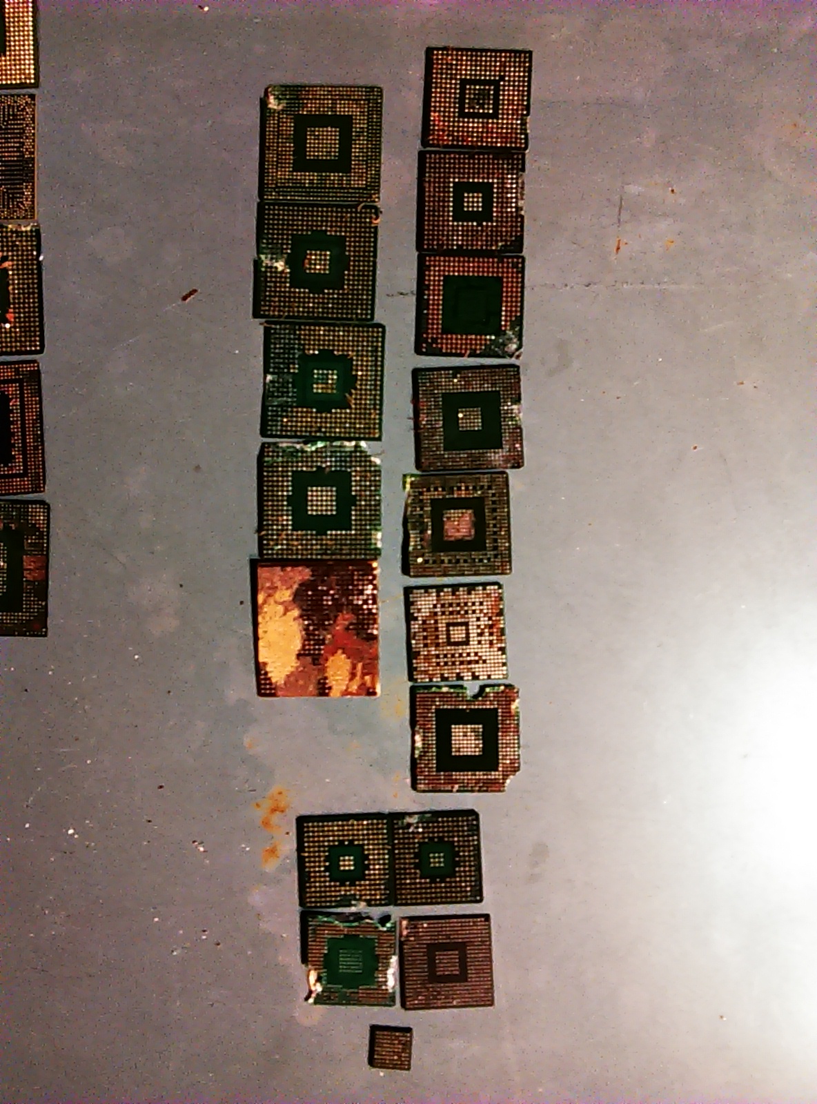

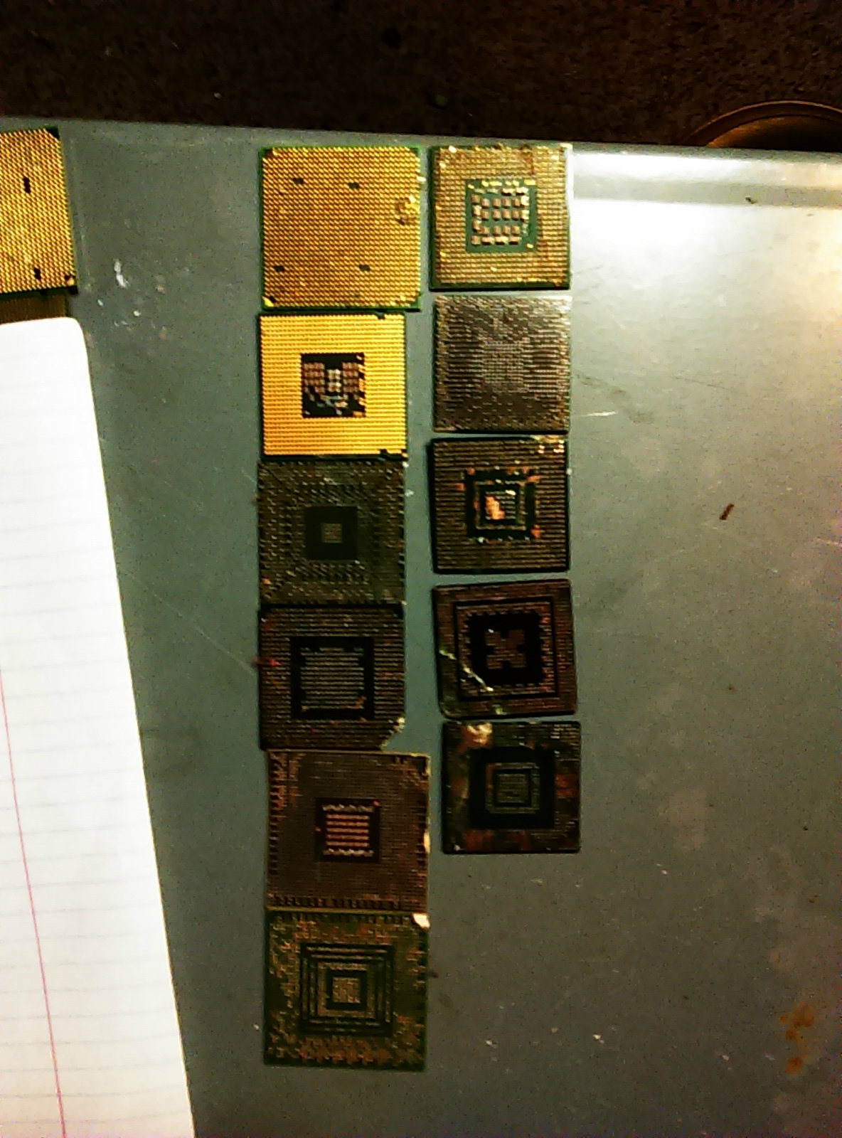

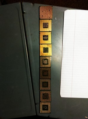

Some I may have downgraded and not sure about please help me learn to sort these better there's so many different types.
I have been keeping them separate in their own bags like I have them pictured here..

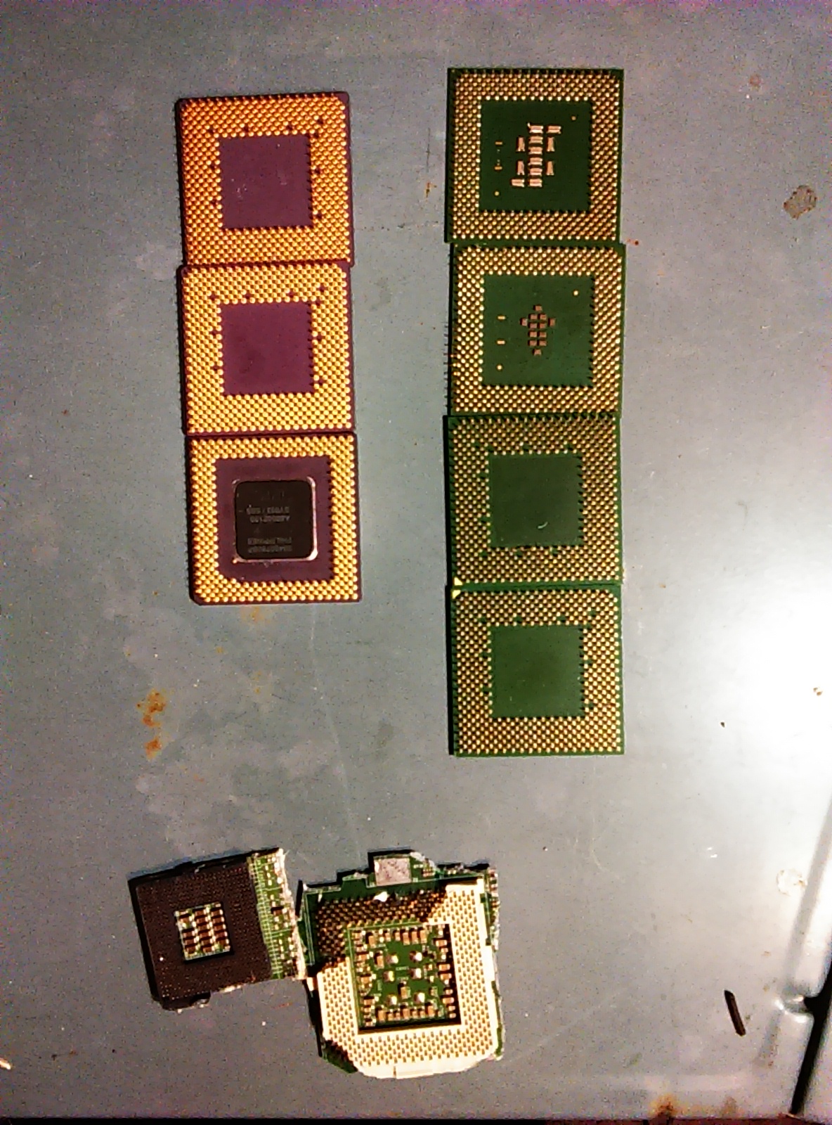

Ceramics need the top to see the classification. The greens are green fibre no metal. The cpu sockets: black one gold pin connector, white one in peripheral
If they have pins green fibre no metal. The 3 chewed up ones are still ohkay.
Green fibre with metal and pinless.
Any cpus with no pins in these photos will go pinless cpu.

Flip them over and re photo them. They range from $22-100/lb so worth sorting correctly.

Idk if I should bother you for the I.d. two say amd and one says intel Pentium. Thanks to you guys I think I matched them up right in the gallery.

The amd chips go in amd ceramics. The Pentium would be Pentium ceramic.
PostPosted: Thu Jun 23, 2016 11:02 am
Posts: 10630
And thanks, lol. I thought those were amd k6 or k7 ceramics but didn't want to call it without the top. Good test for my eyes/memory.
