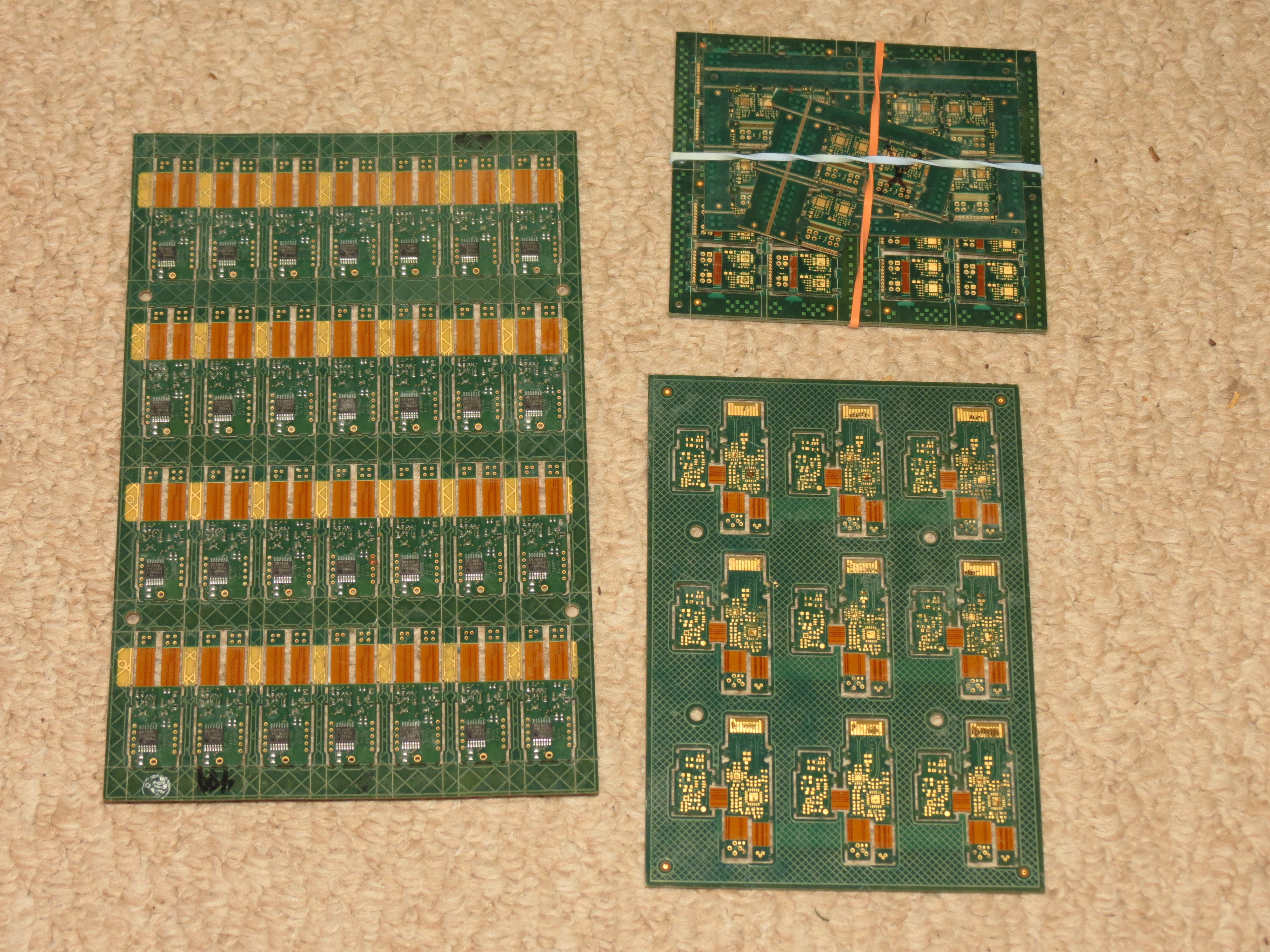

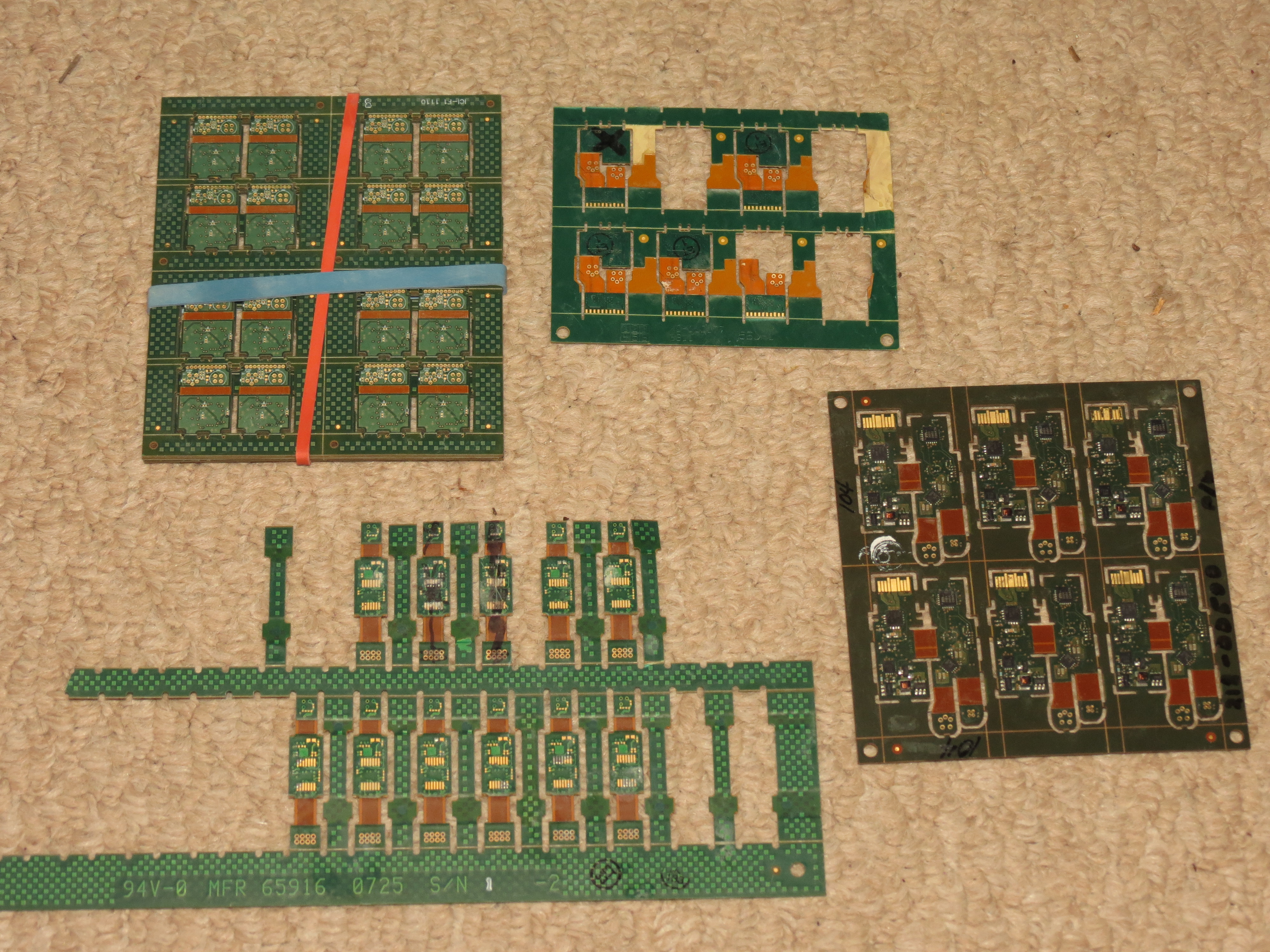

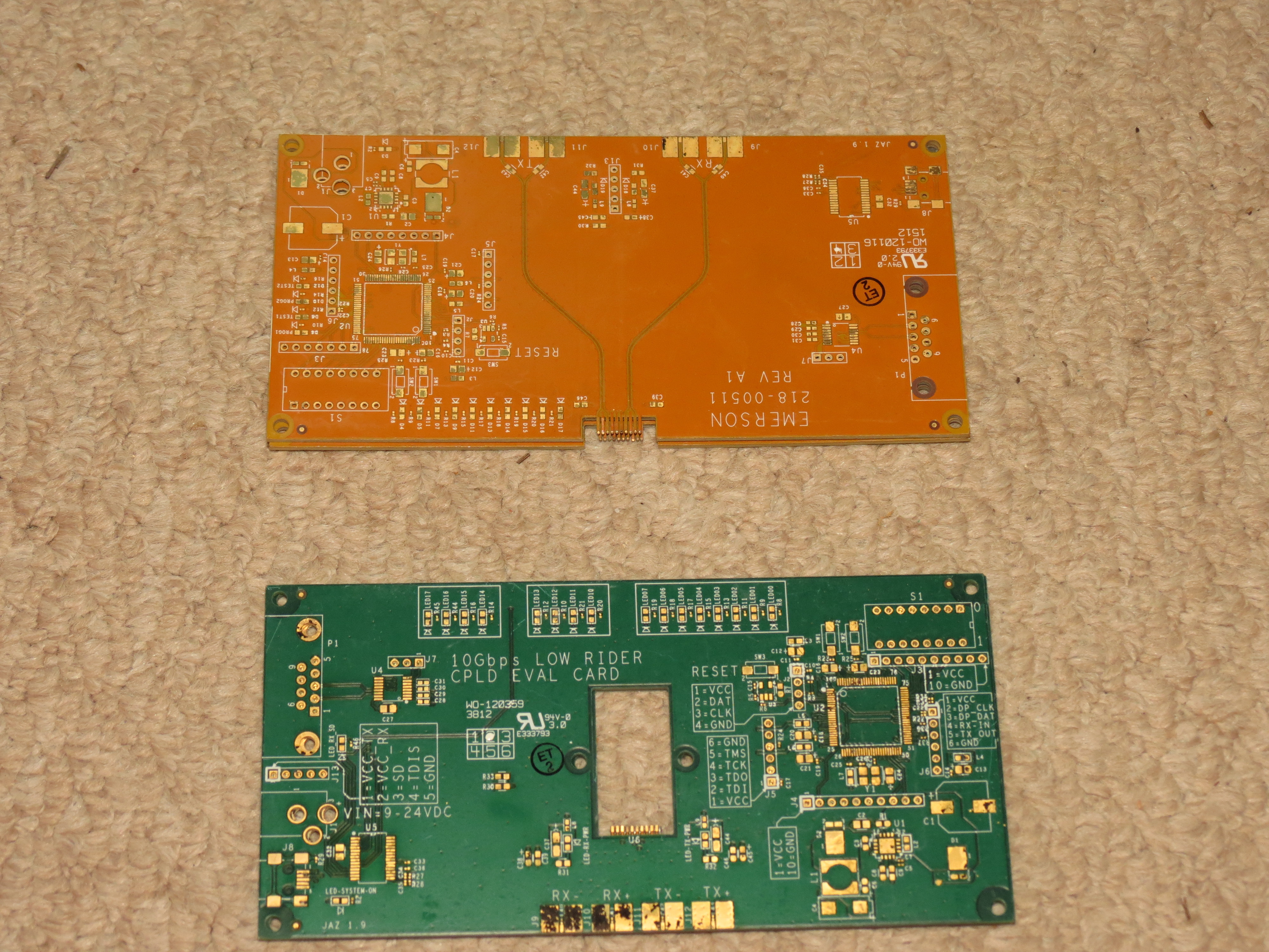

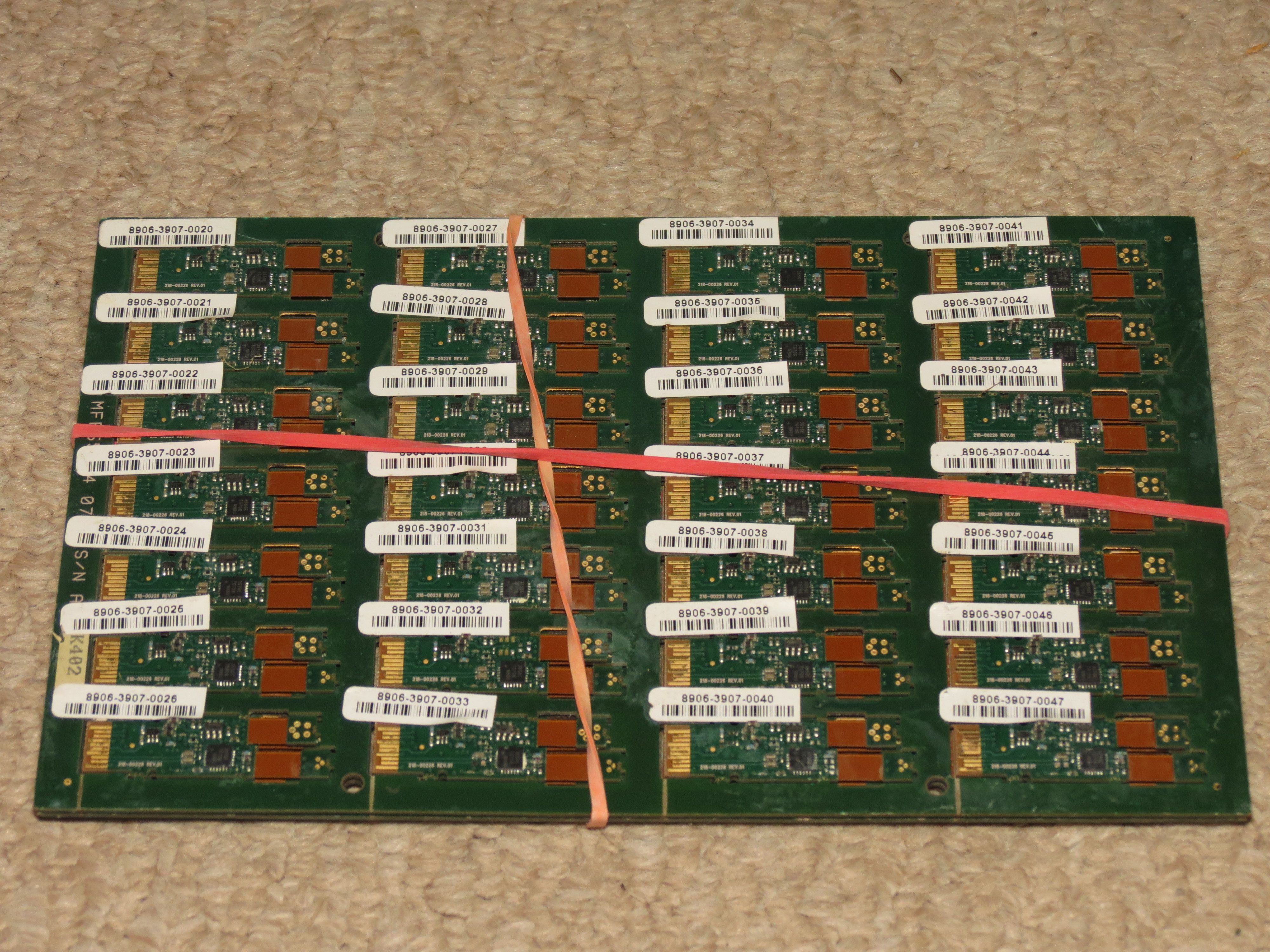

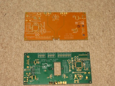

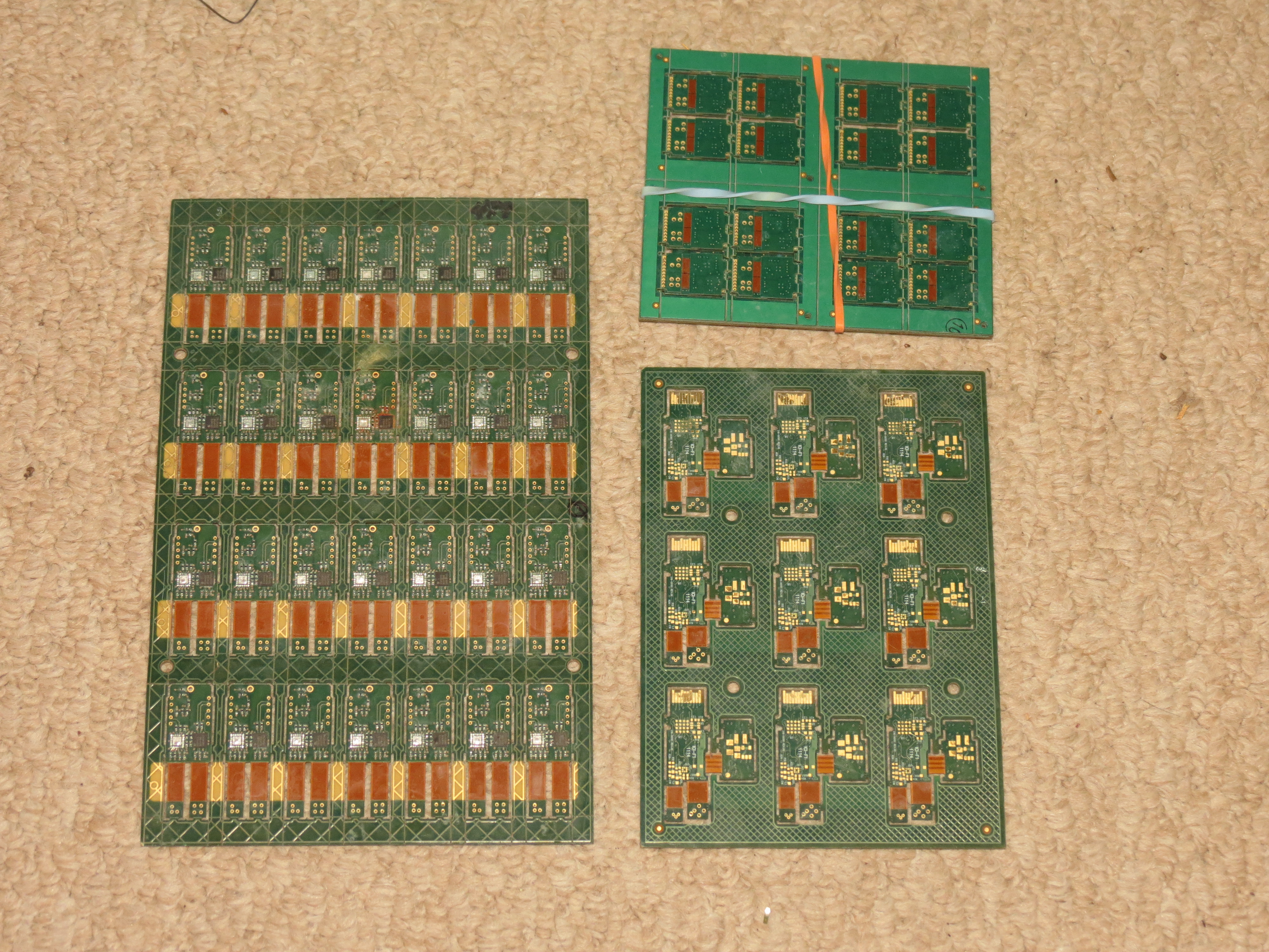

Help with grading these too please?
PostPosted: Tue Mar 22, 2016 10:59 pm
edit see below
PostPosted: Wed Mar 23, 2016 12:04 pm
1/2) Peripheral
3/4) Big sheet on the left telco, big right peripheral , small sheet telco
5/6) Peripheral
7/8) Peripheral make SURE they are in a separate bag or spot in your shipment. And note it in the comments point and send a picture with your quote so they know ahead of time and you don't have them swept into brown board low grade out of habit.
