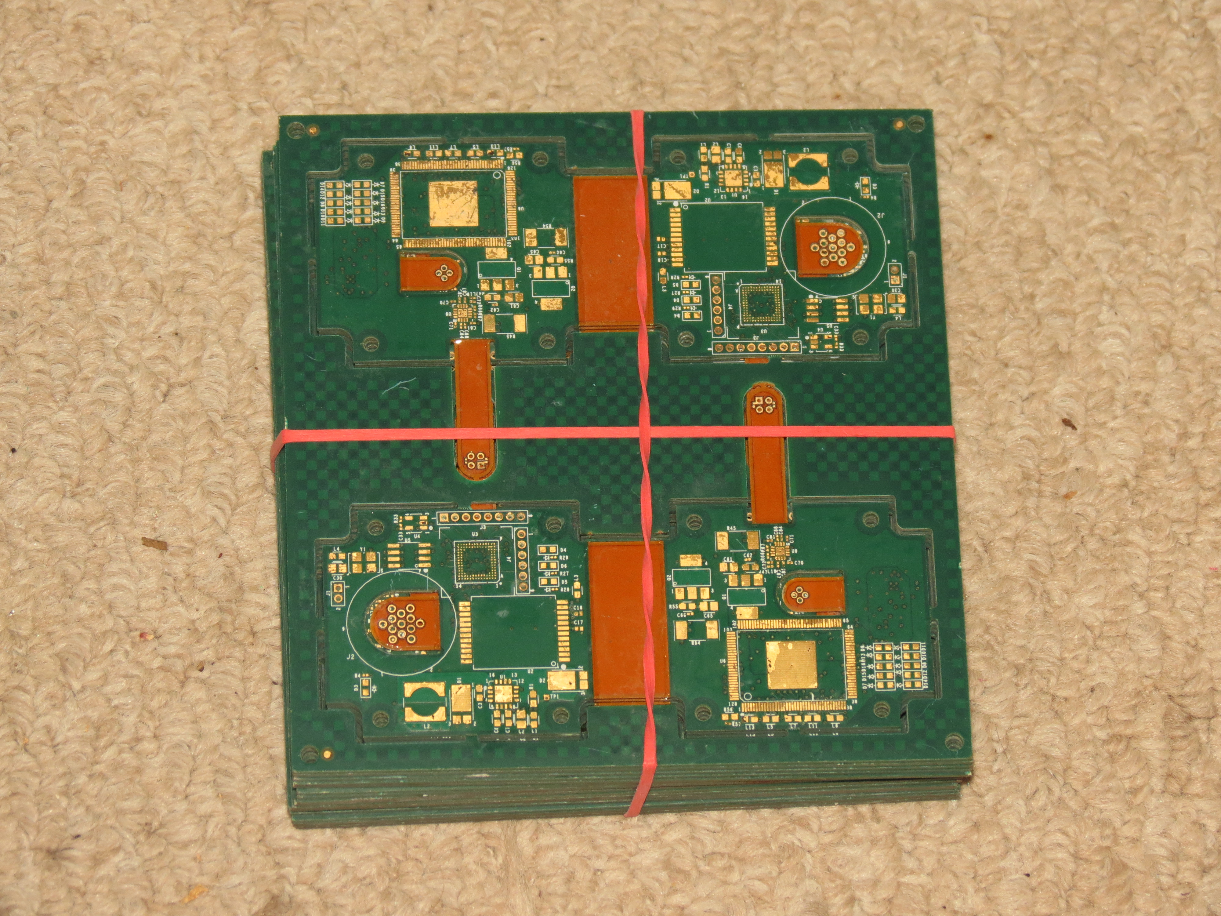

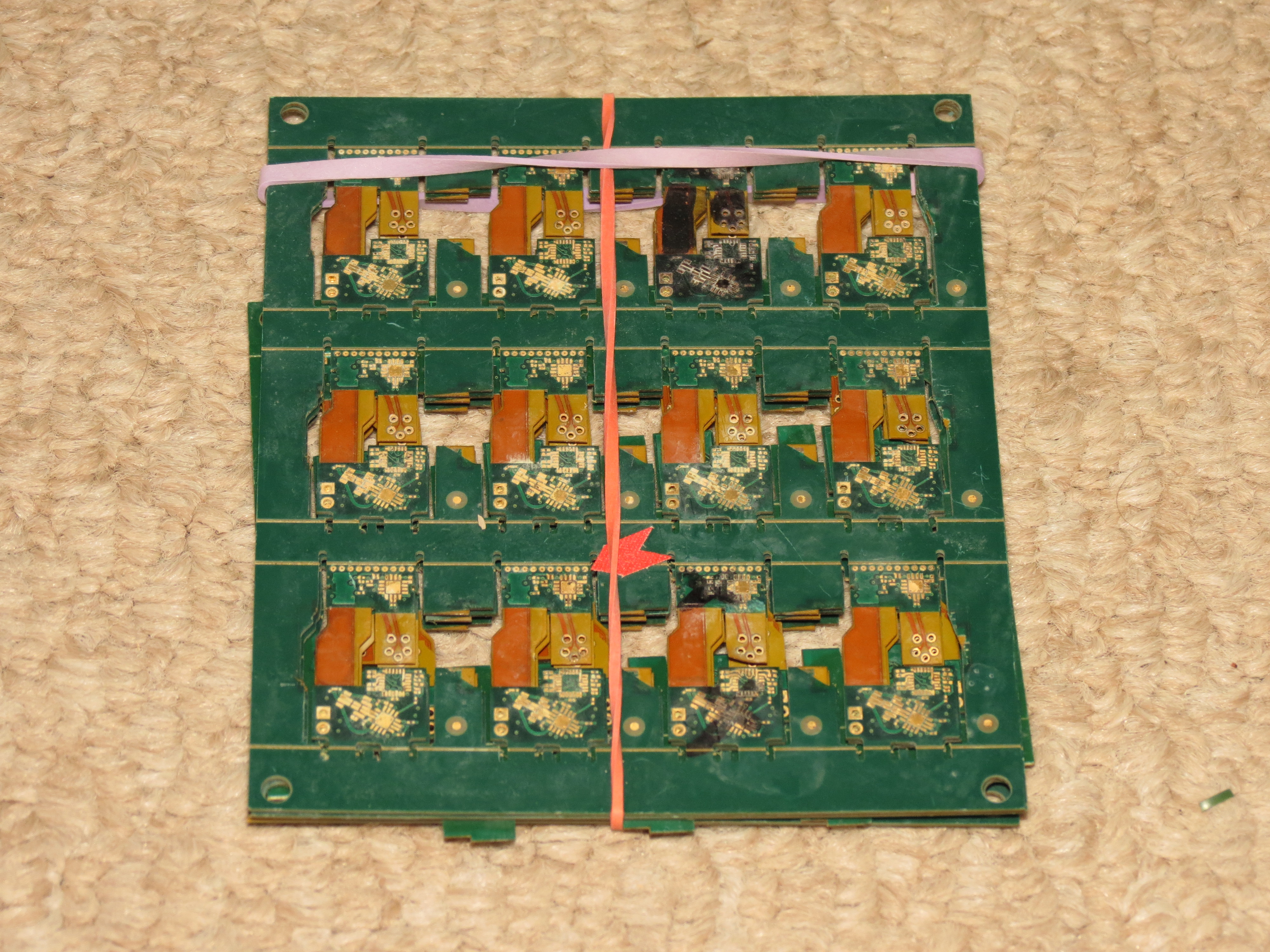

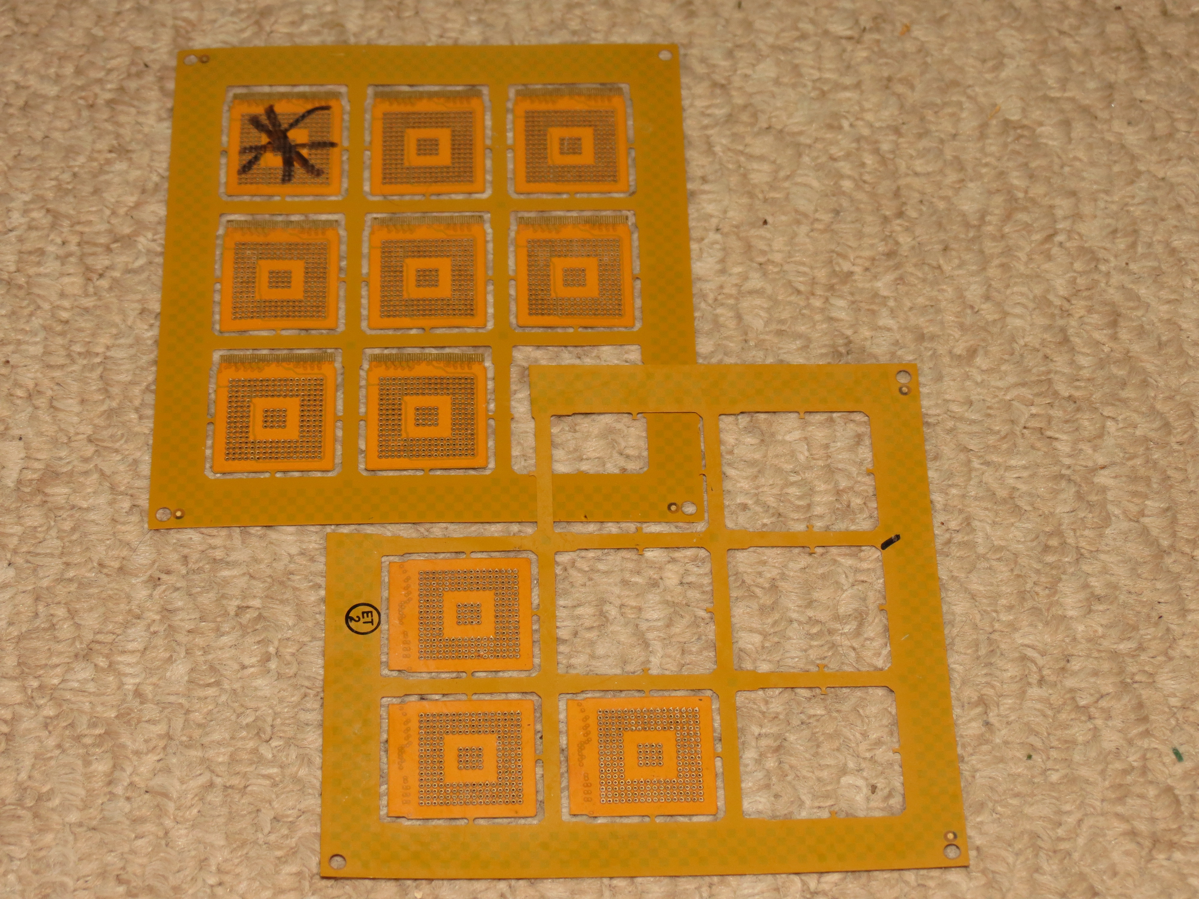

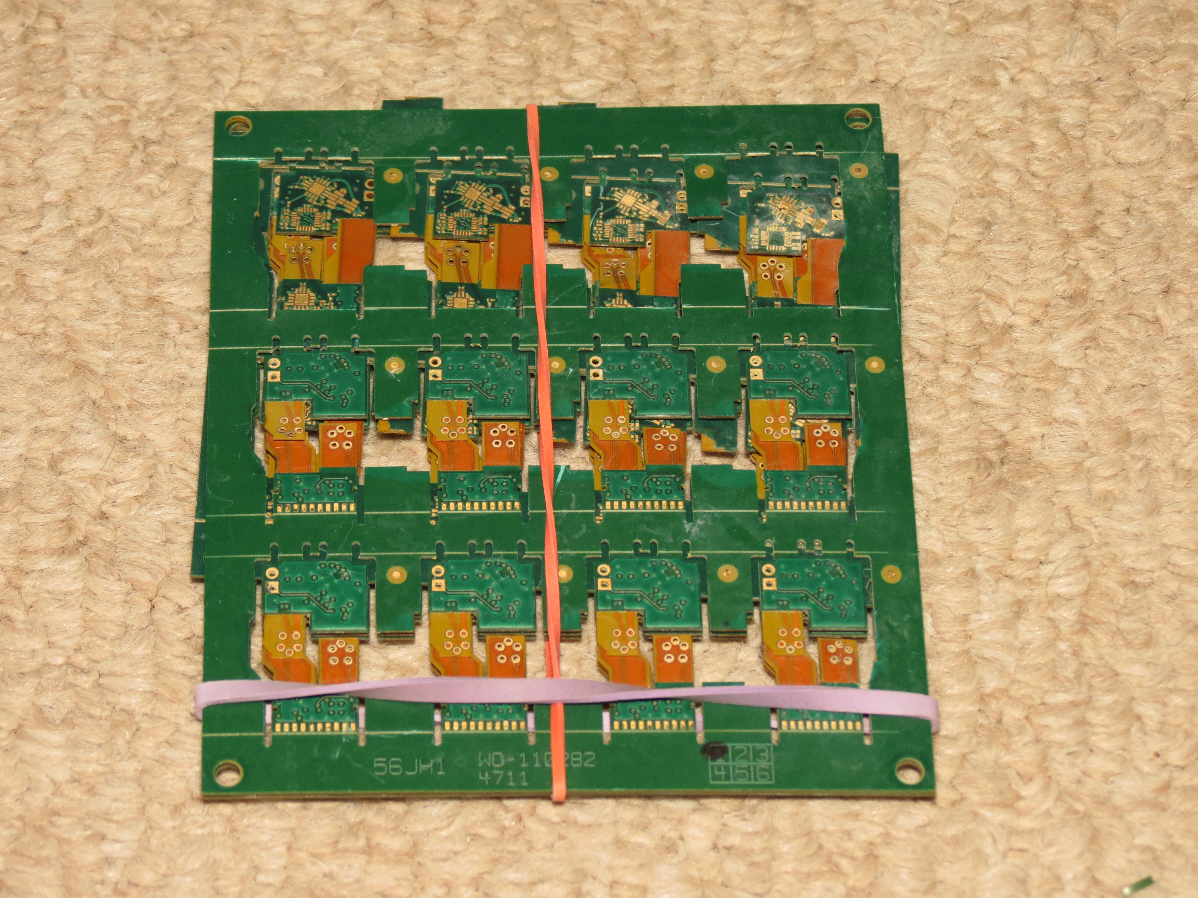

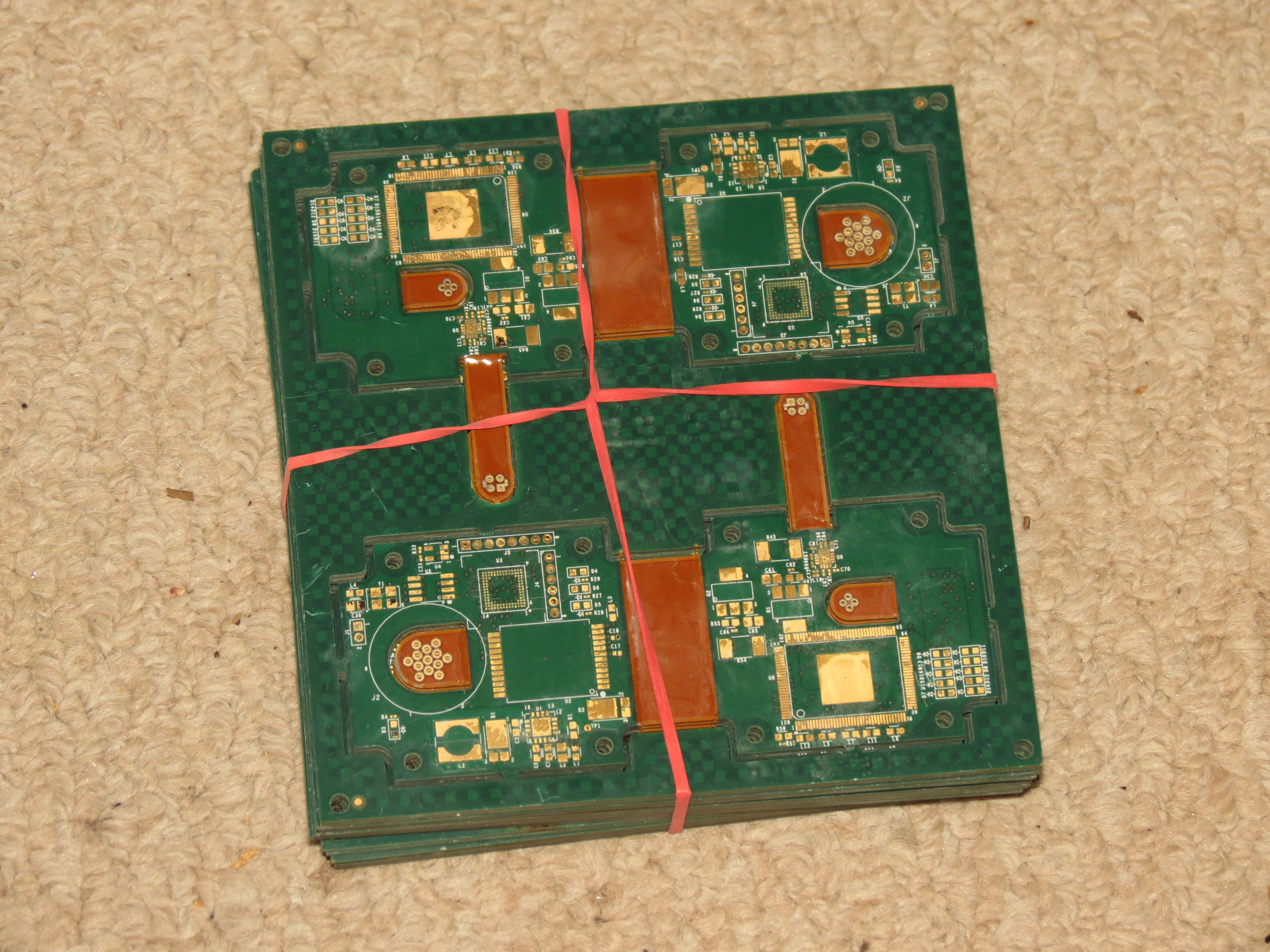

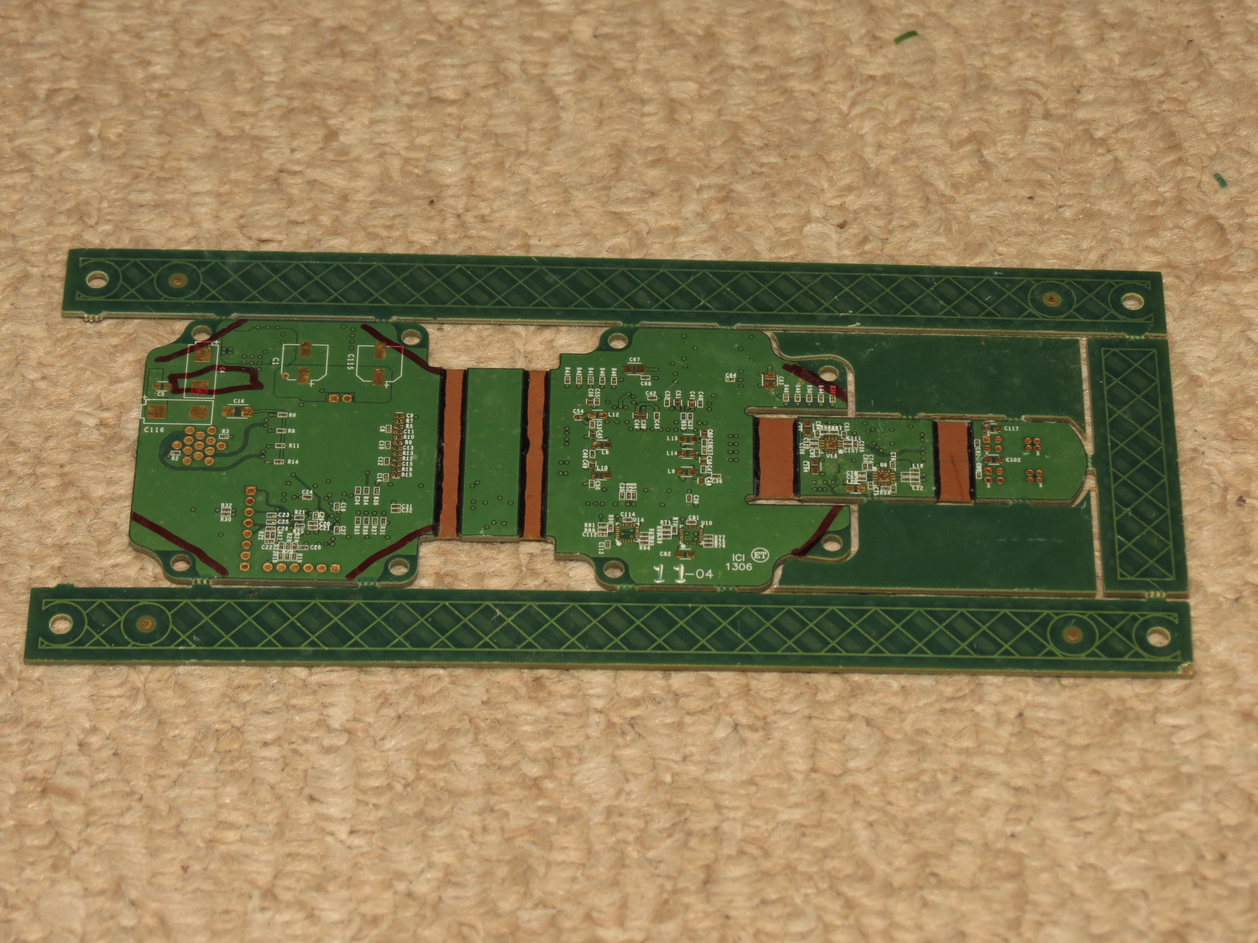

Can I get some help grading these Blanks please?

I would send an email to Chris, but I don't think you are going to get very much for them (including the boards in your other posts)... Do not be surprised if you get peripheral or lower for the ones with no surface mounted devices. All the gold looks nice, but in reality it is an extremely thin flash plating that is a fraction as thick as the layer on regular gold fingers.
Most of the precious metals recovered from e-scrap is in the surface mounted devices. The board itself contains mostly copper and epoxy/fiber filler with only trace amounts of gold.
If you were to take a normal gold finger card and strip it if all its components, you would downgrade it peripheral or worse... essentially that's what you have with those blank boards.
I did notice you had a few with components on the boards... I would expect you to get peripheral at the least for those with an outside chance of getting something better.

Ill go through each of those 3 threads with a fine tooth comb in a little while. But yes, truly blank cards will usually go peripheral. Once you get the components on there things start to go up.
PostPosted: Wed Mar 23, 2016 11:54 am
Posts: 10496
1) Peripheral
2/3) Peripheral
4/5) Peripheral
6/7) Peripheral
