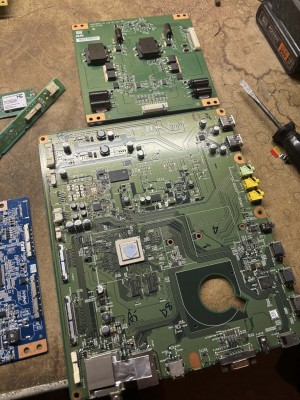

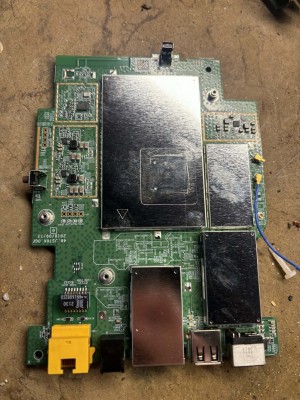

1st & 2nd Pictures - Those boards came out of computer monitors.

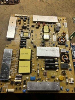

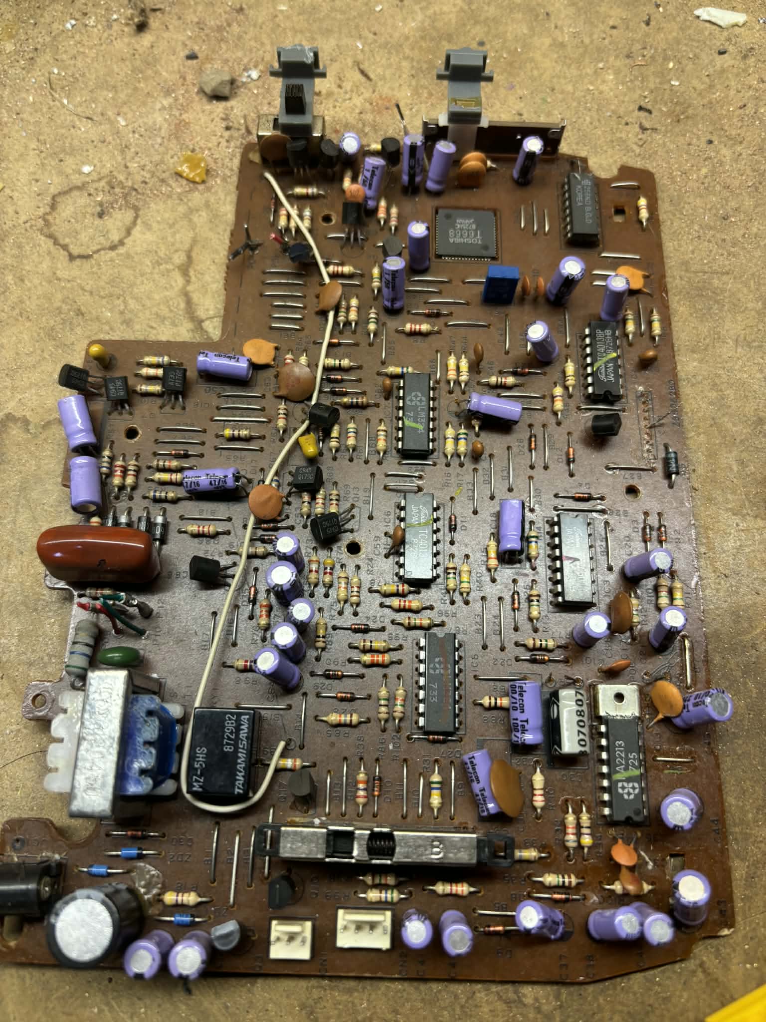

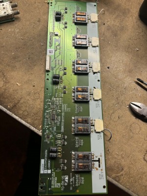

3rd, 4th & 5th pictures - All boards pictured came out of an Flat screen TV

Are brown boards strictly low grade or can they be of a high grade?

Brown boards are almost always low grade. The ones you posted are. The rest, referred to by image name:
yTvX9Ym: high peripheral
EyNwU: Blue is high peripheral, long skinny, midgrade, top is some kind of communication module without fingered connection, I think boardsort will take those at an unlisted price but not sure.
VsSkggNv: larger high peripheral, smaller low peripheral
VSQCiPjg: pull the shields off, likely high peripheral
CKklBbCG: leaning high peripheral, might be low
Q1DlaoHs: pull the shields take another picture
Ge5R0FZ4: pull the top shield at least, likely high peripheral
SNKvH1IR: midgrade
