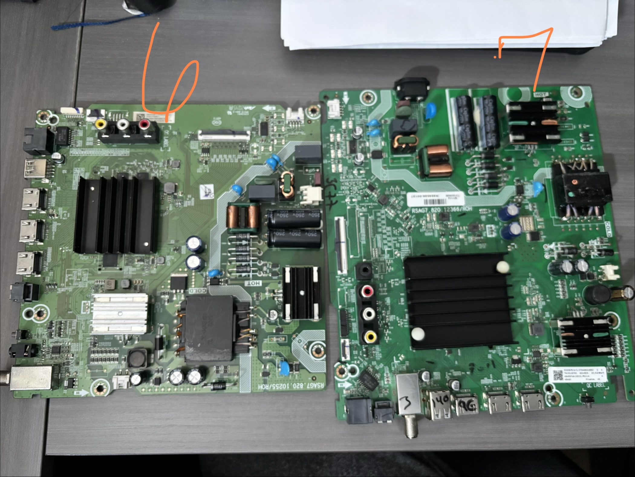

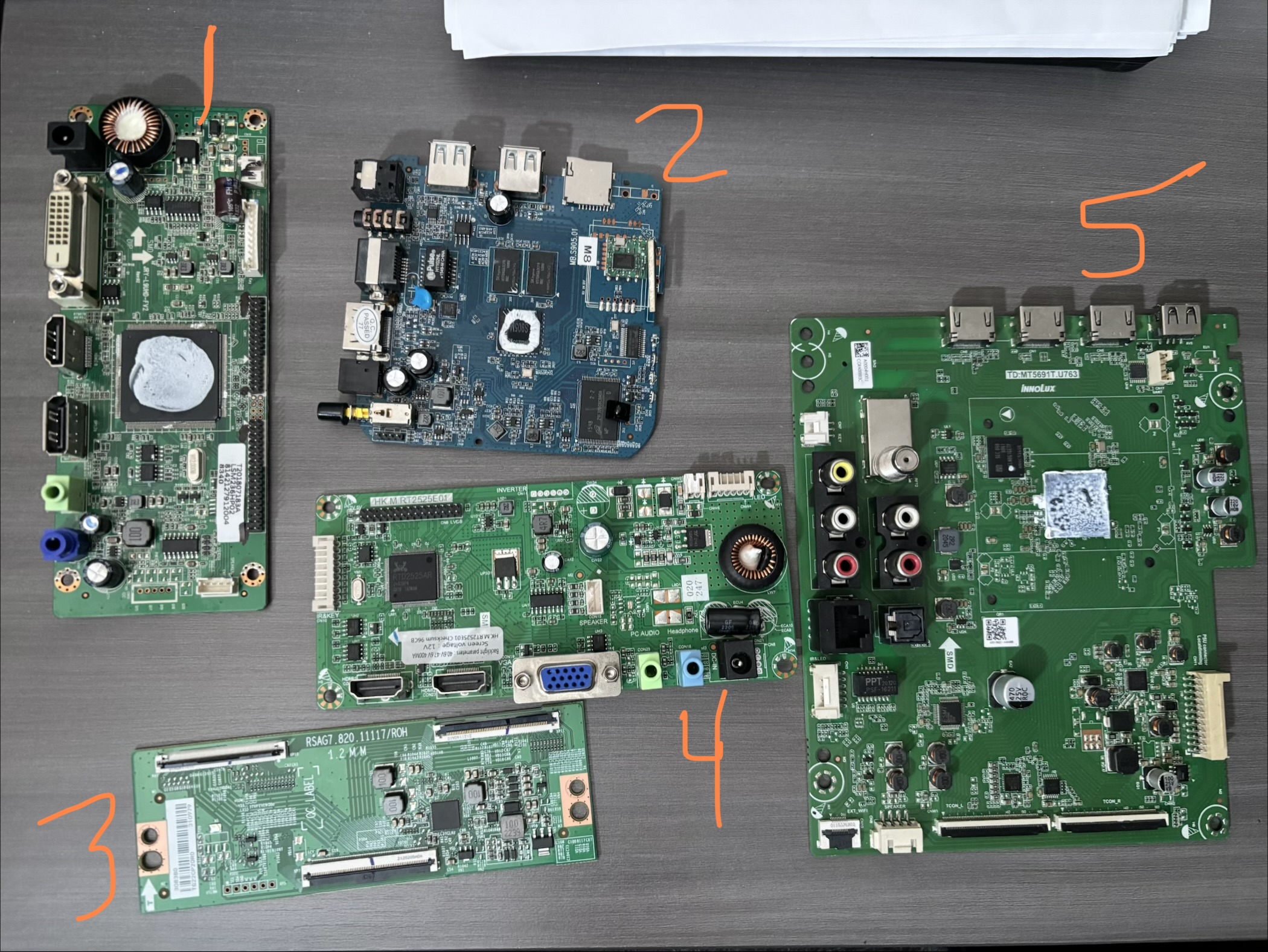

It has been a hot minute since I’ve sent this kind of stuff in (and back then peripheral was a single category) - help me make sure I categorize correctly please? :-)

Peripheral is essentially high peripheral now. Anything that you thought, "I hate to put this in midgrade but I don't think it's peripheral..." is low peripheral.
Remove heatsinks and on the two boards we've kinda decided if you pull the large transformers off the rest of the board should be okay in high peripheral. After that everything should be high peripheral

I had a lot of TV boards downgraded last shipment I sent that had been graded as high in previous loads but were downgraded to low in this one.
It was explained to me that any TV board that includes an RCA or Coax jack, but does not include a gold-tabbed BGA, will be graded as peripheral low grade.
Can’t tell what is under the heatsink in 6 & 7, both those could potentially be low if no gold bga, and number 5 would be downgraded to low
