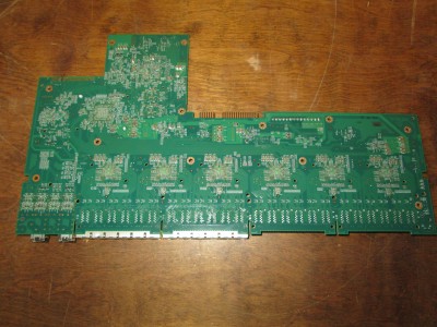

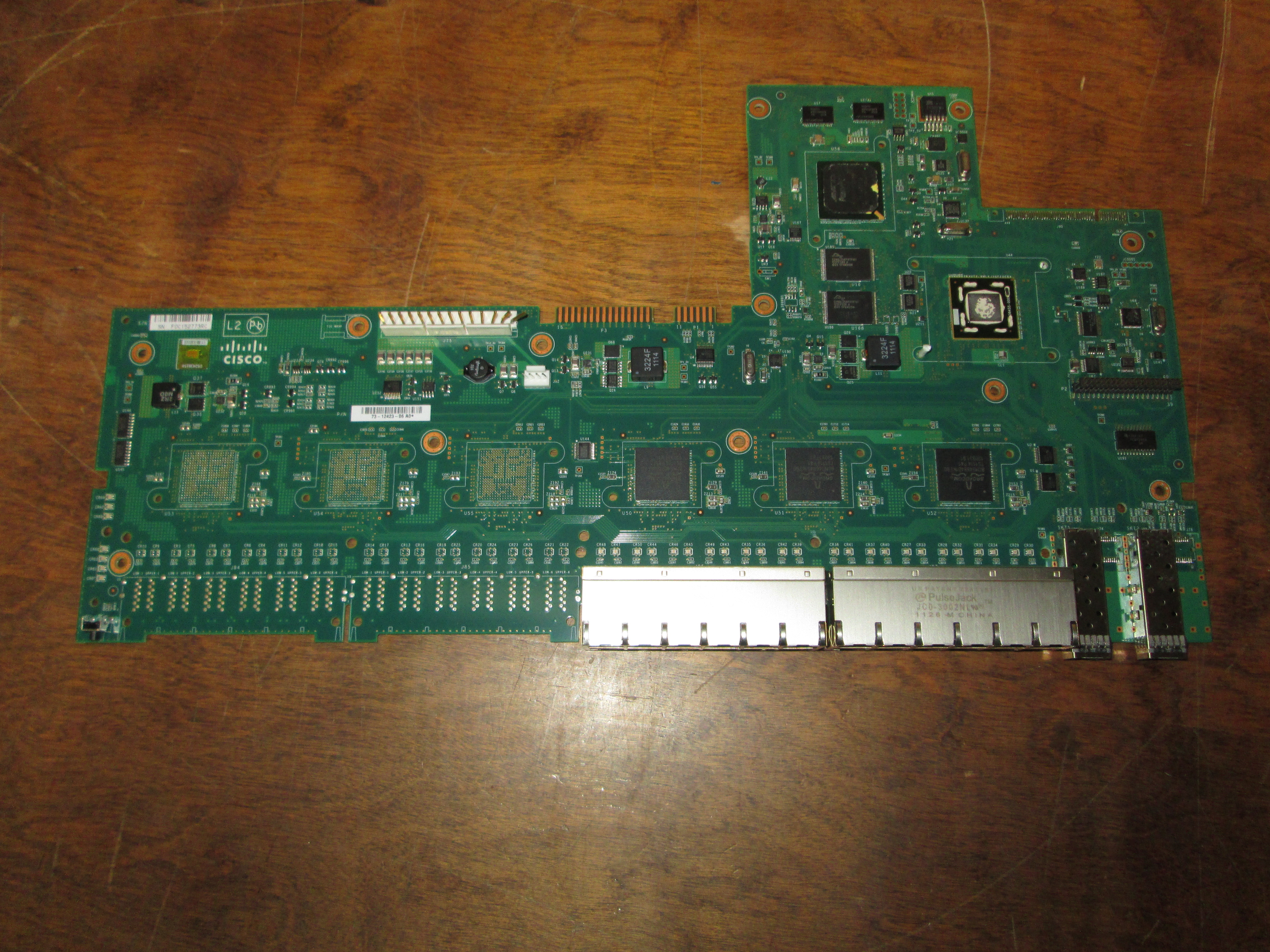

I have some network switches I want to process. I took one apart and would like some advice on what components are worth keeping and roughly their value. Any info is appreciated. I have uploaded some pictures for reference.

First off, try to organize and mark you images to make it easier to respond. You will get more replies. Generally, front and back photos of boards as well.
Everything in you photos can be scrapped for money, so not sure what you mean by what is worth keeping

Looks like you have a broadcom commercial network switch, just tore into a bunch of these myself.
The main board in commercial networking equipment is generally high telecom class.
boards in img 9327 are low peripheral as shown, but the backside could change that.

in img 9233 there is a board with a flashdrive. That board is high peripheral and the flashdrive board is also high peripheral. Very easy to peel off the case.

Generally speaking, if you can remove some screws or move a clip to remove something in electronics, do so. If something is soldered together leave it together. As you keep going you'll learn there are exceptions, some things won't be worth your time to take apart (I don't take apart PSUs) and some things that are soldered maybe need to be or make sense to remove.
Basically...pull the boards out of their housings, unplug any wires and don't just rip components off the boards.
