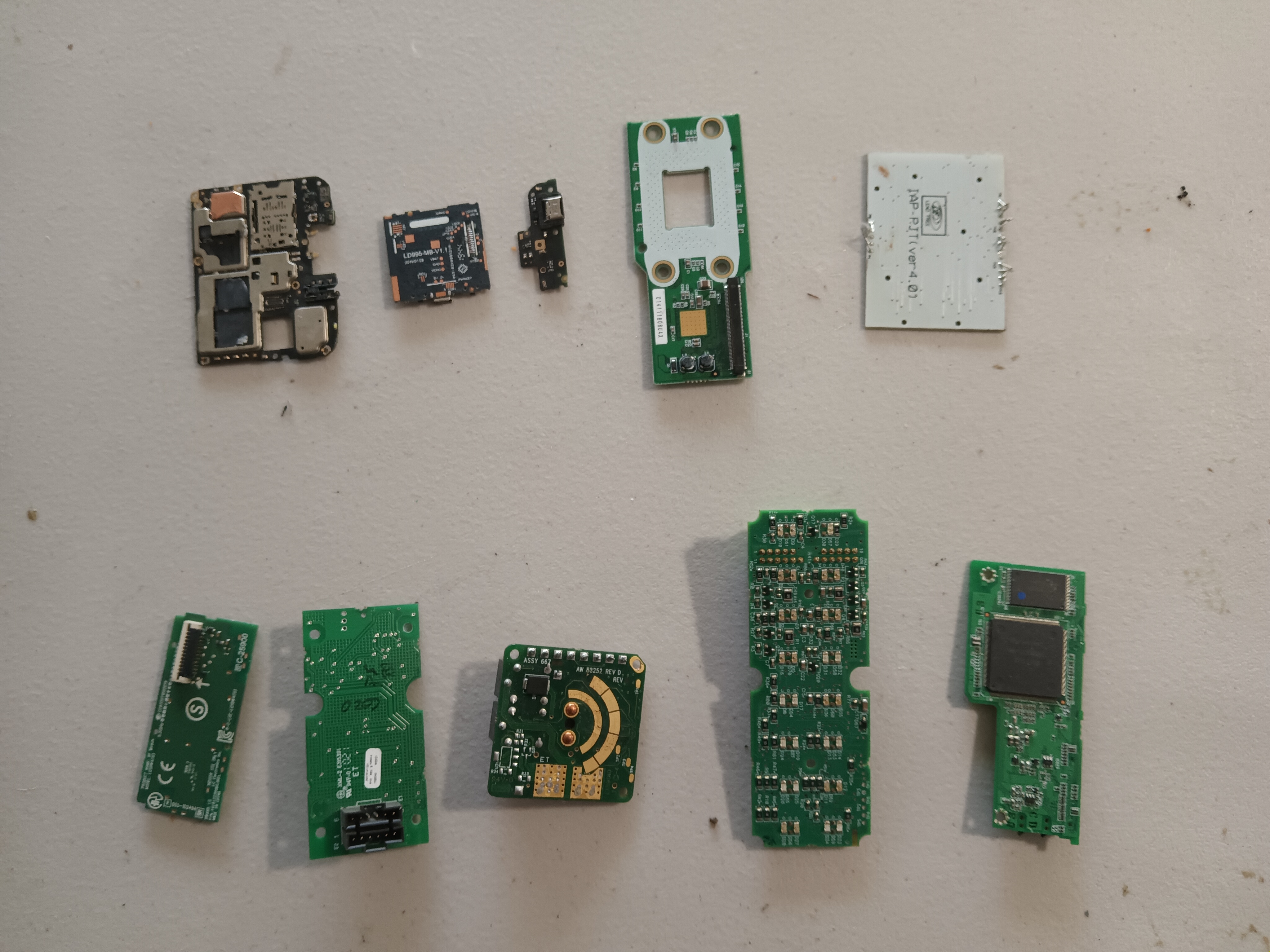

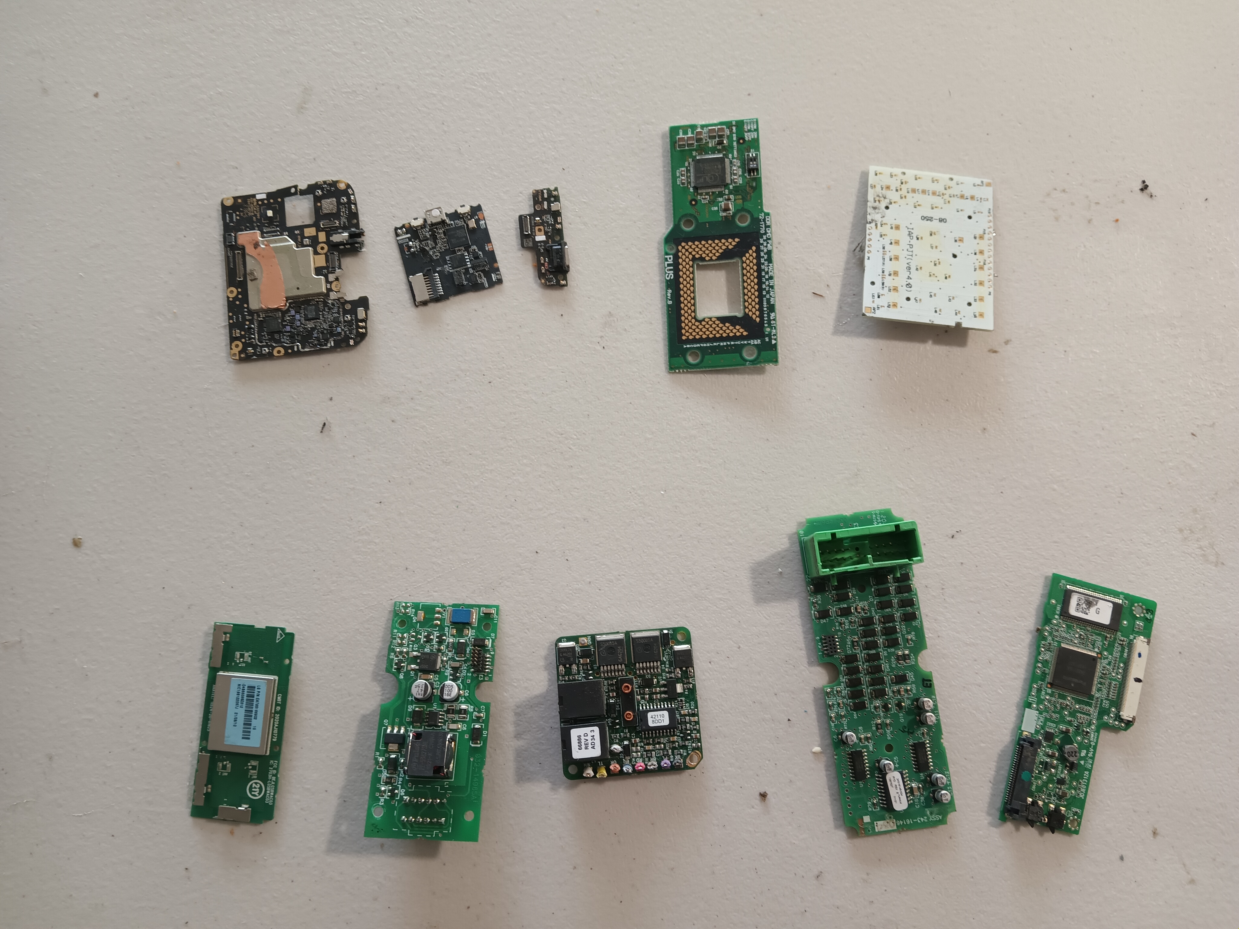

Guessing there probably not high grade boards but just wanted to check thanks

Depends on what you call high grade. The board that held a DLP chip is high peripheral as is the board with two chips on each side (may fall into a higher grade, based on chip per surface area of board and depending if those are gold connectors, hard to say with these really tiny boards). The others vary from mid-grade to low peripheral. The videos are worth watching and Chris explains a lot as to how the grades are made.

The pics reorient depending on if you're looking at them in the body of the post or after clicking on them so I'm referencing the orientation in the body of the post.
Top left, should be some sort of cell phone board but needs the shields removed if you want to get the best grade on it. As is I'm thinking low peripheral.
Next to the right, low peripheral.
Next right, mid grade (possibly low peripheral if the gold content is there)
Next right, I had two different thoughts that Renaissance was right in the middle of so I'll concur, high peripheral.
Top right, low grade unless I missed something.
Bottom left, remove the steel antenna and shield, maybe low or high peripheral after that.
Next to the right, midgrade.
Next right, high peripheral seems possible to me.
Next right, low peripheral.
Bottom right, cd/DVD board.
