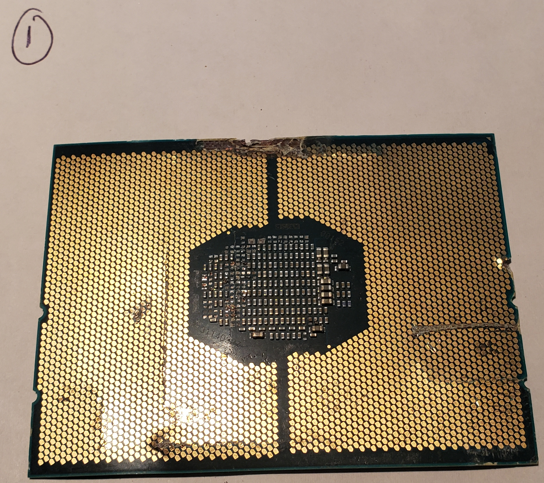

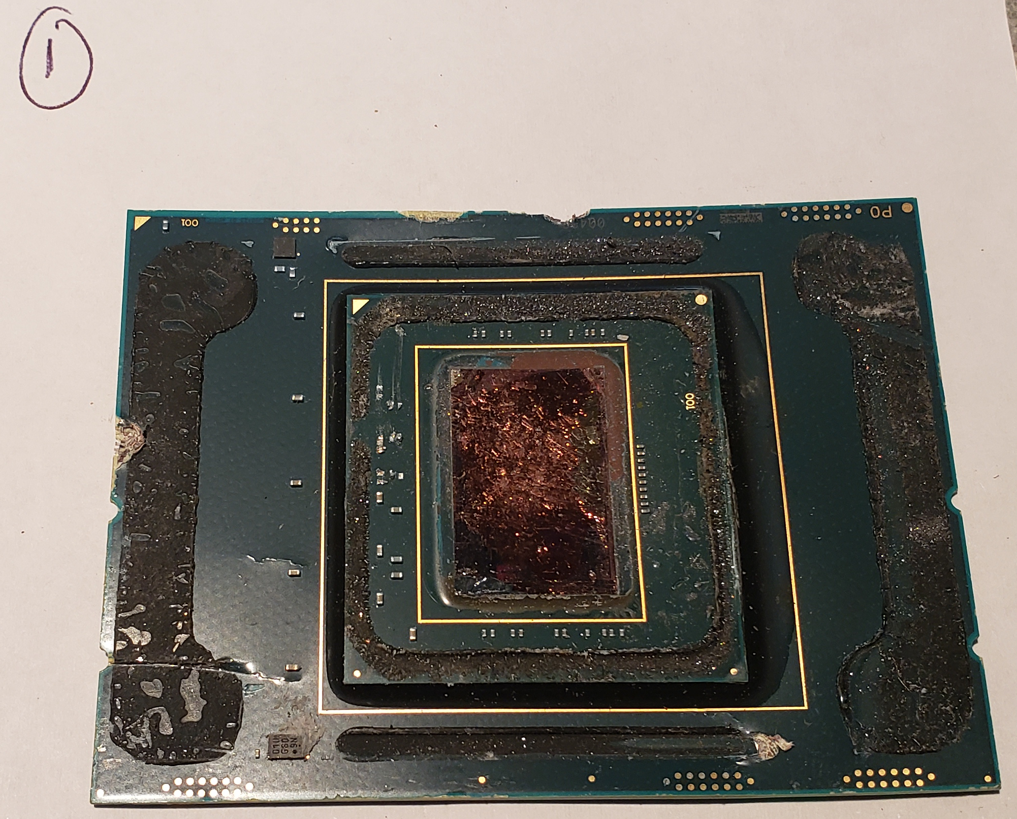

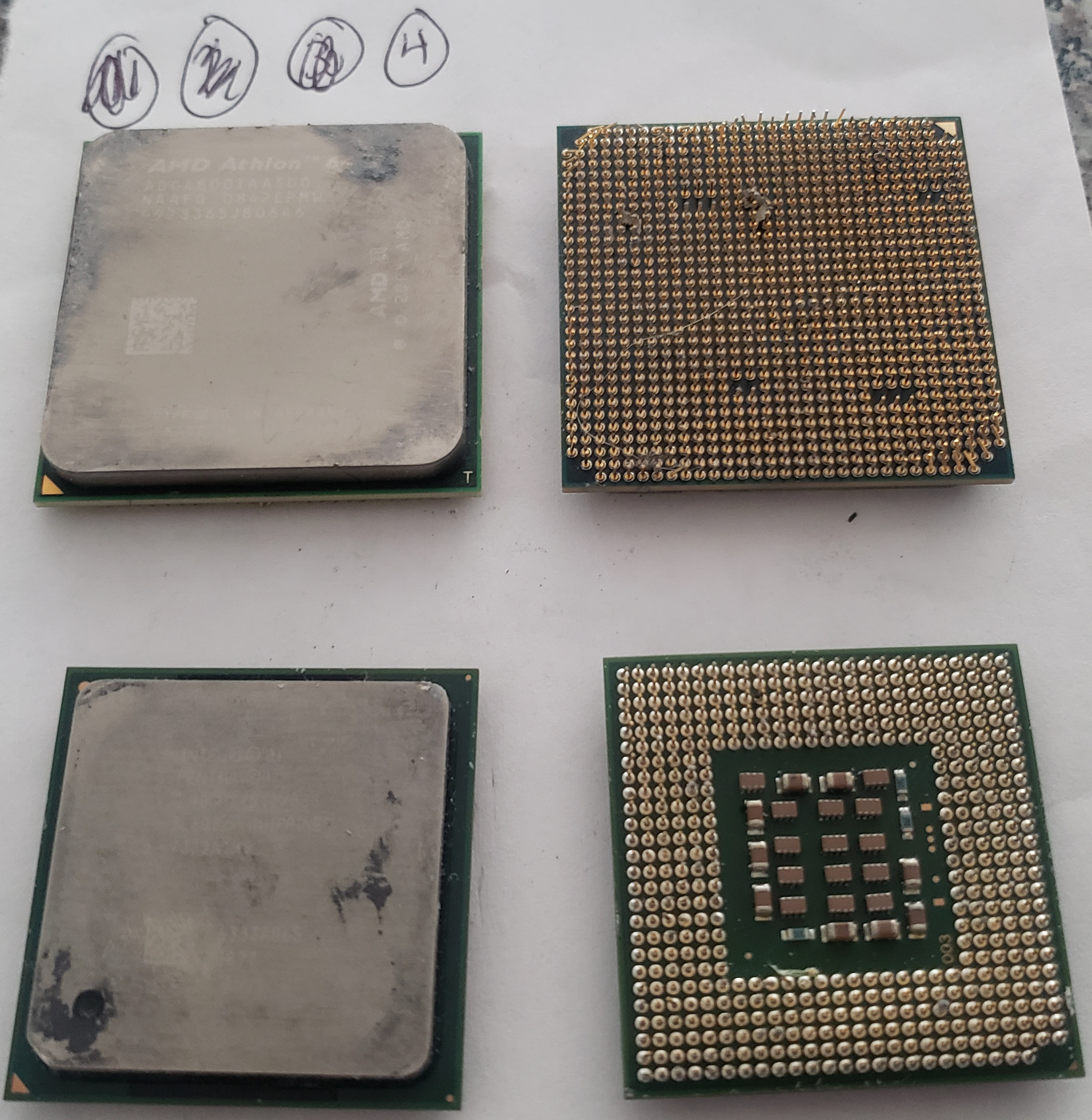

Looking for guidance on placing these items in correct categories. Ill put what category I think by the number. Any correction/help is much appreciated! Mainly do board recycling, chips are newer to me! Thanks in advance!
1) Flat pack gold tab
2) No Pin CPU

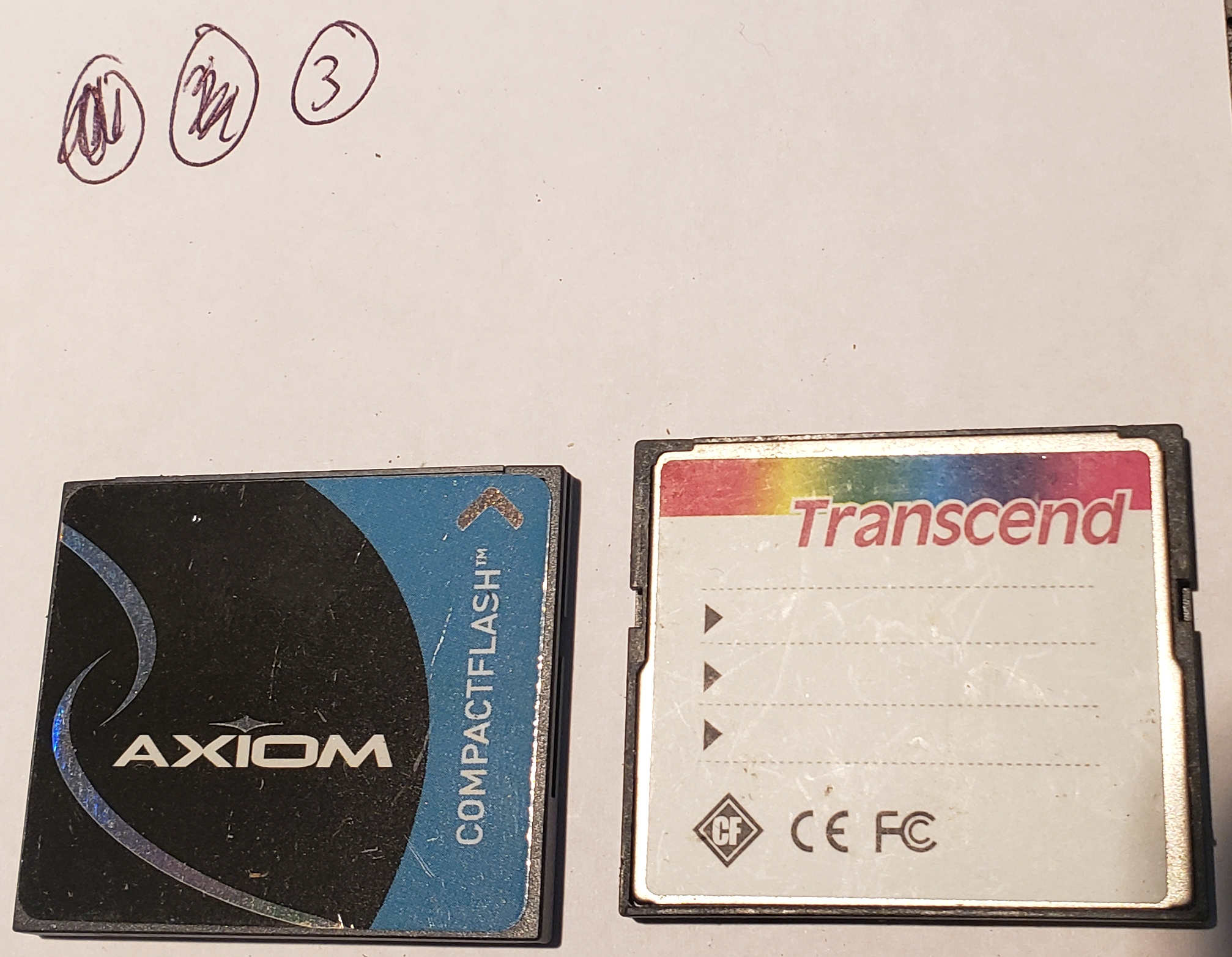

3) No clue on the compact Flash

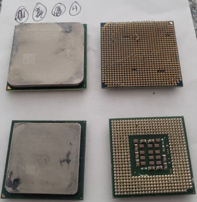

4) These are AMD but with metal, so unsure

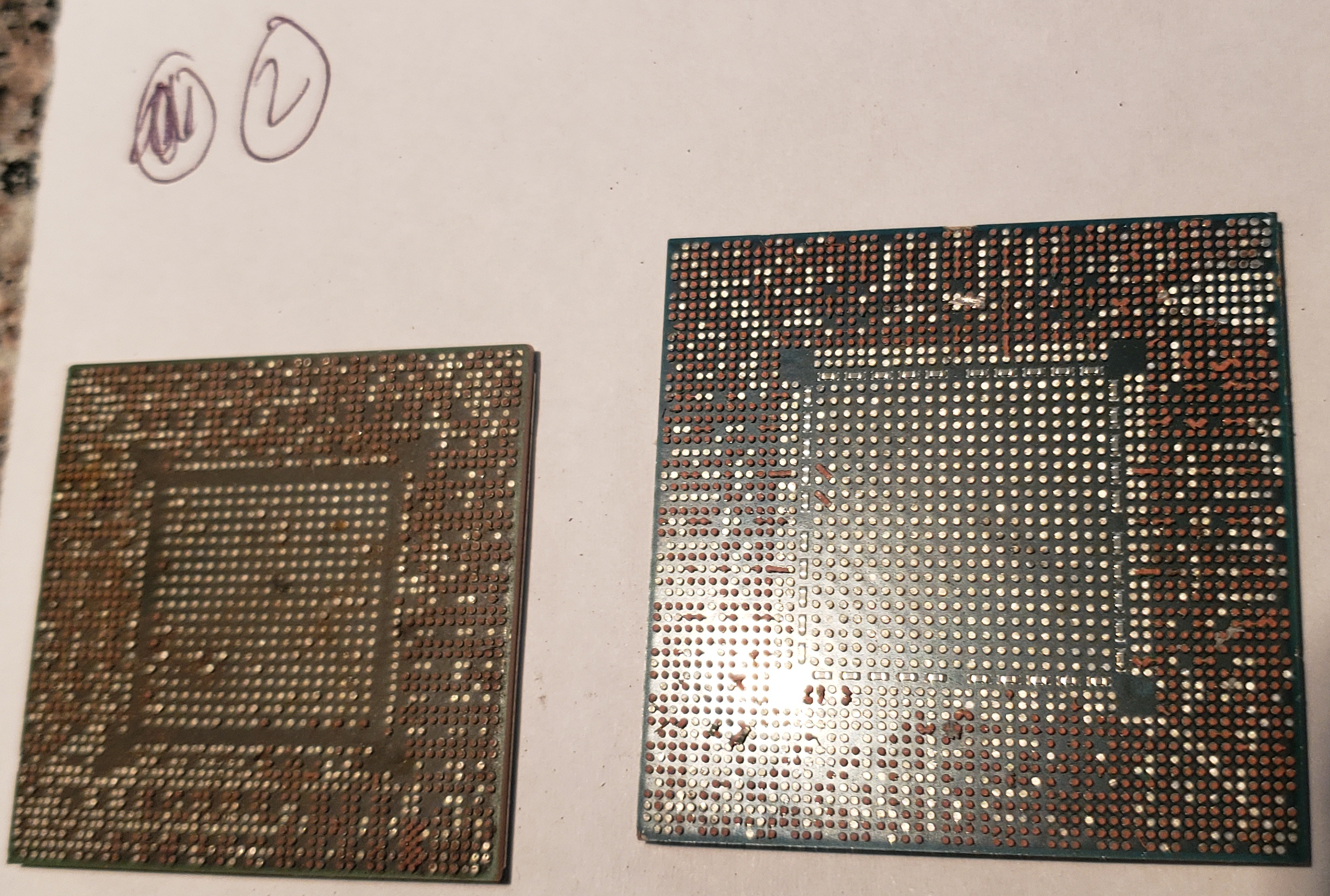

5) Green/Brown fiber, but they are metal which confuses me for category placement

1 is correct
2 looks like a flat pack to me based on the bottom but I’m
Honestly not sure.
3 You’d have to open up for the board inside.
4 Should be a no pin CPU. I believe the only AMDs in a separate category are the one with pins.
5 I’m not sure. I actually have a black ceramic Motorola CPU with silver pins that I have no clue what it falls under. I keep meaning to ask.

1. I do not believe the gold triangle is the same as a gold tab, this looks like a damaged Pinless CPU. This would be something I keep separate from my sorted material and hope for a good grade but don't expect to get paid for.
2. Flat pack; these are soldered to the board while a No Pin CPU has a socket.
3. Pull the metal off to reveal the board; should be at least high peripheral but likely a telco grade
4. P4/Green Fiber With Metal
5. I'm in the same boat, not sure I recall a grade on this type of chip and it may vary between the three. If there's no gold visible on the pins or there's solder over the gold it'll decrease the value (can't do anything about that)
