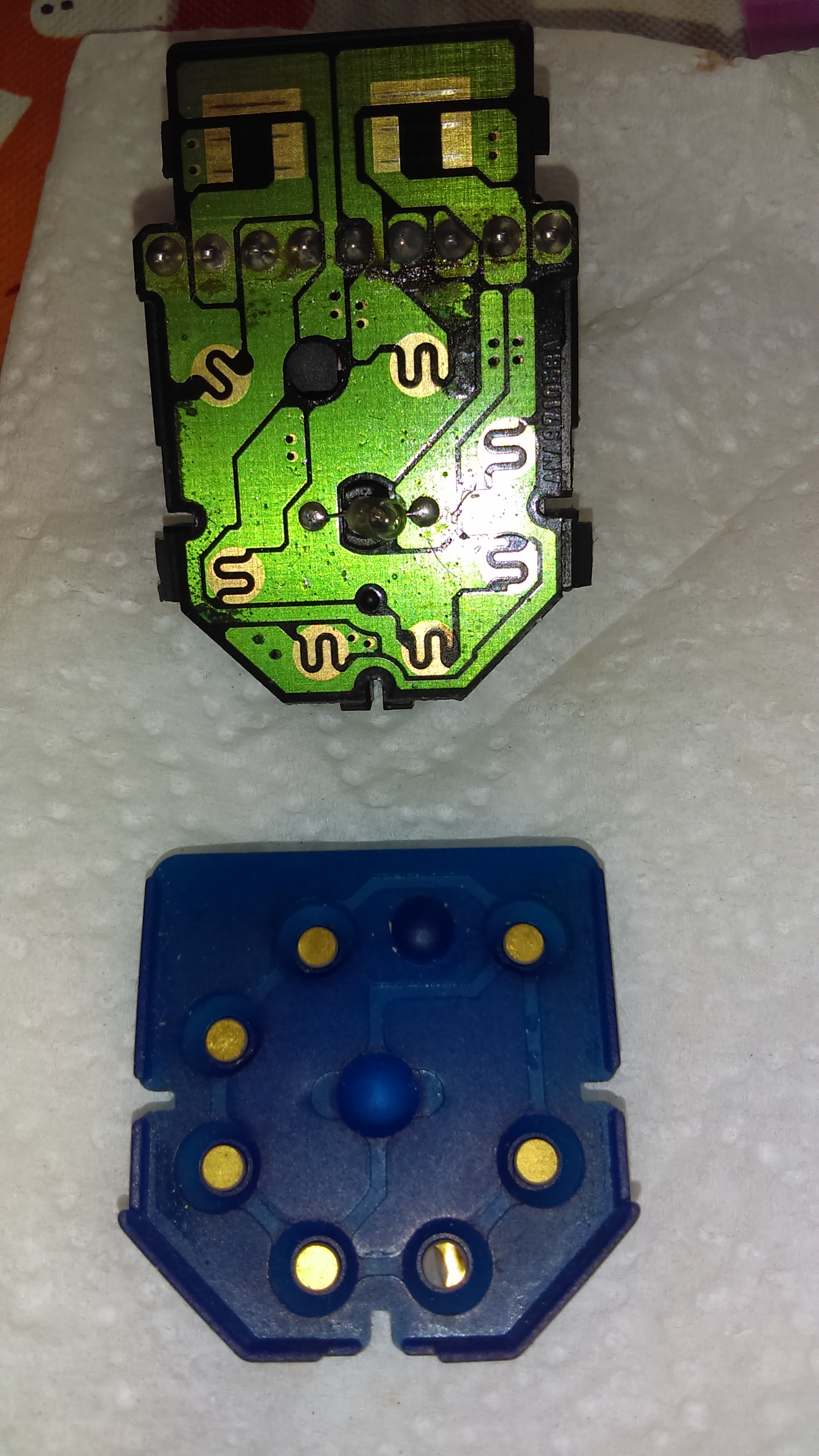

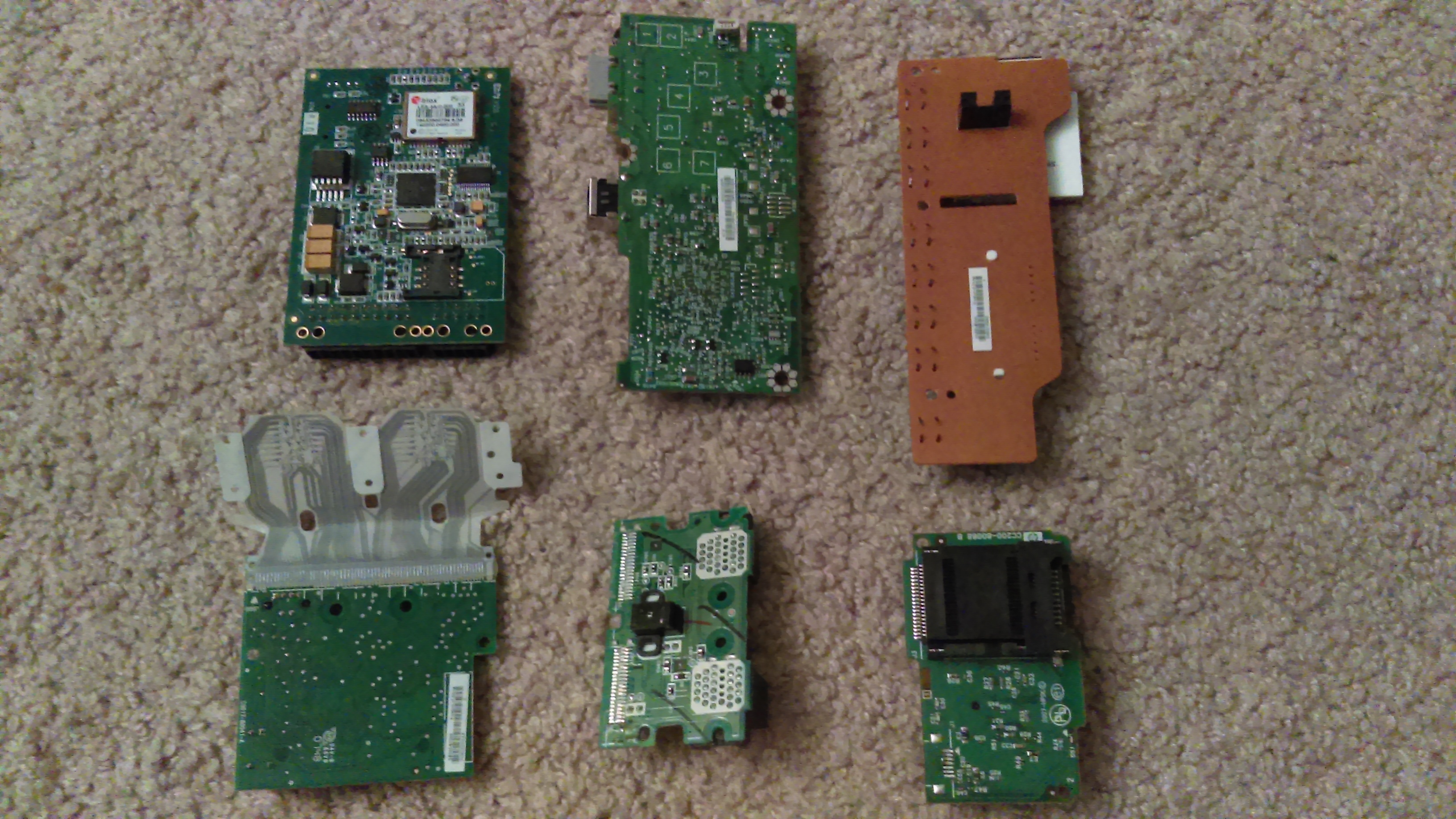

 Post subject: Re: need help grading
PostPosted: Tue Feb 16, 2016 2:35 pm

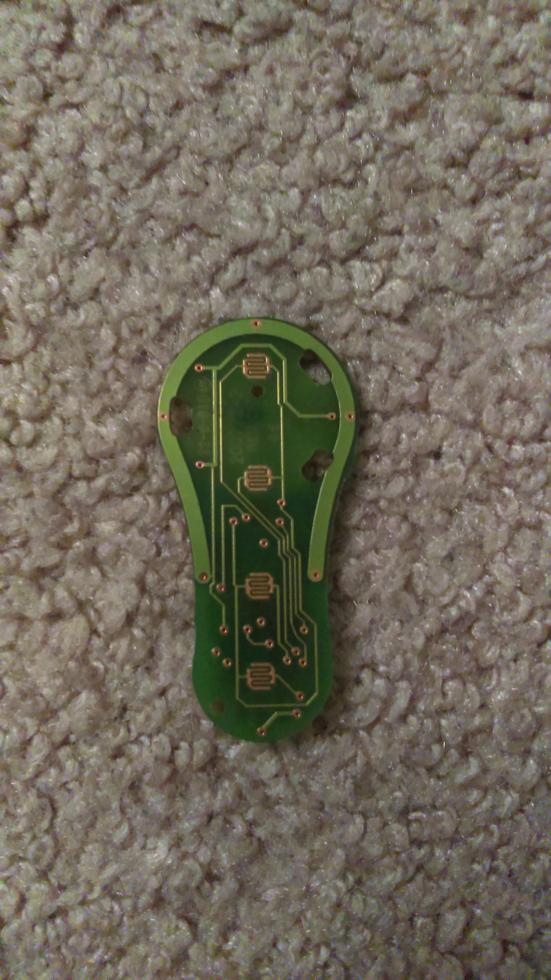

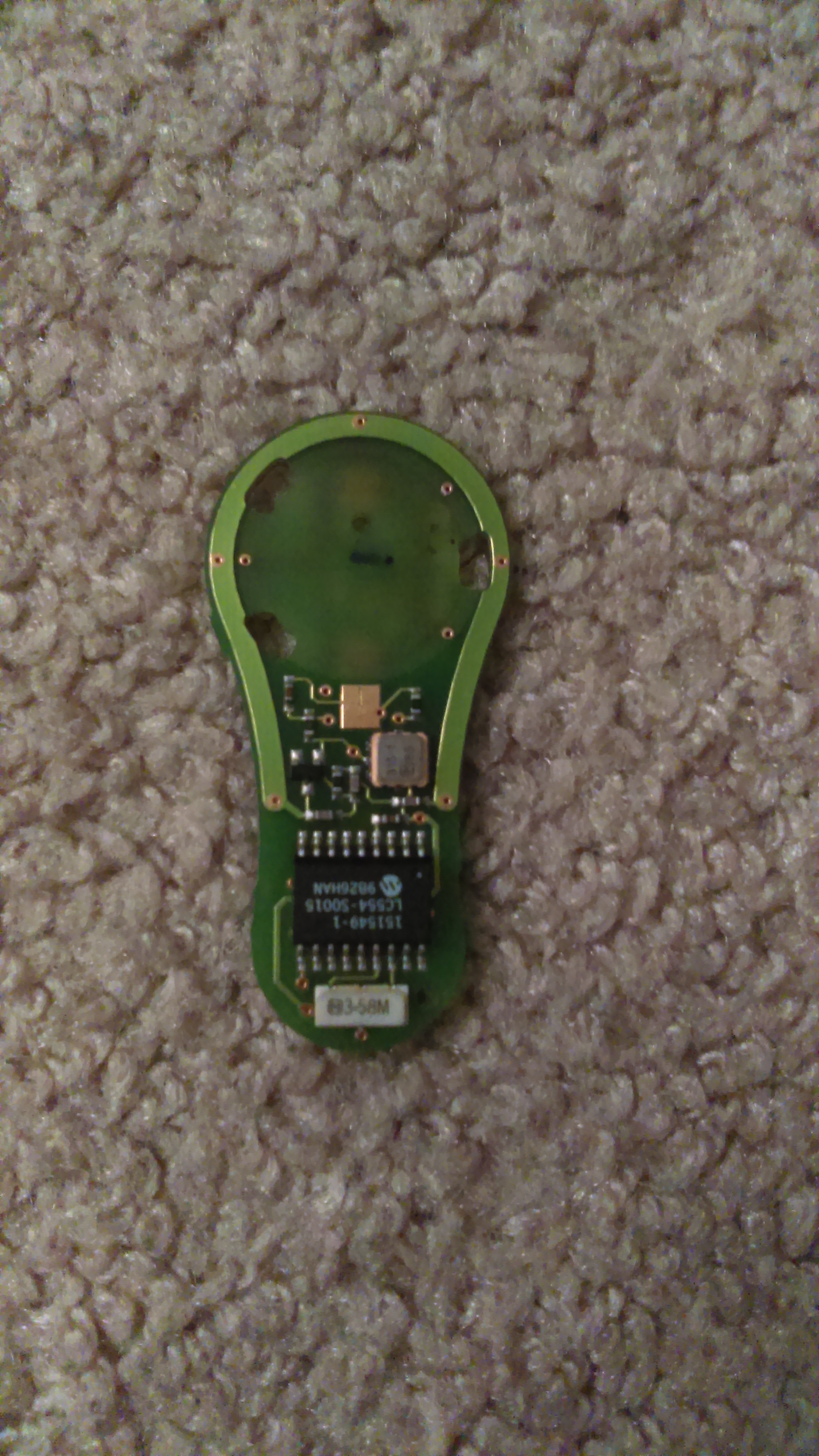

The mirror switch is peripheral

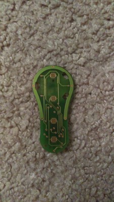

The two photos for the clicker are peripheral

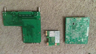

Dlp board is usually green fibre with metal

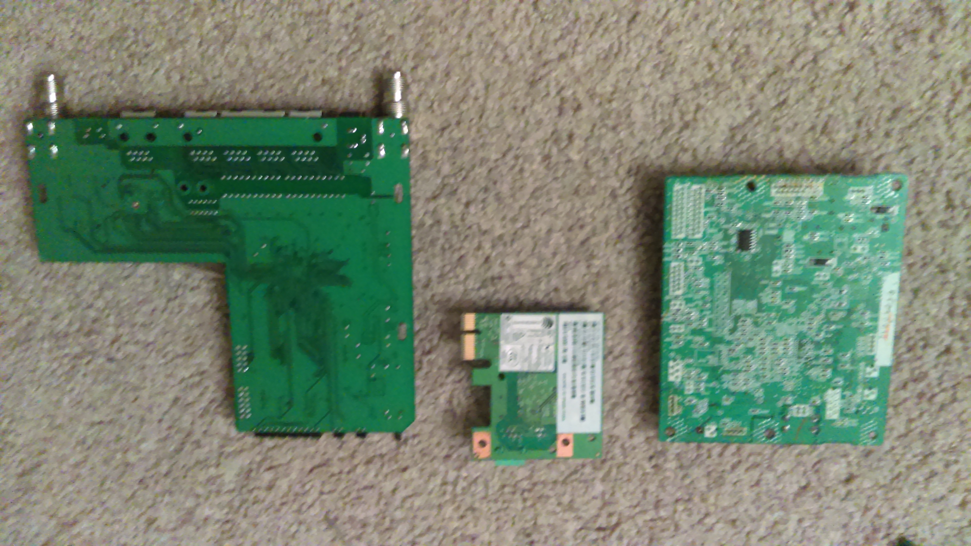

The long boards with the gold cap cpu in the middle go telco (I have a post about them) without that specific cpu it's peripheral.

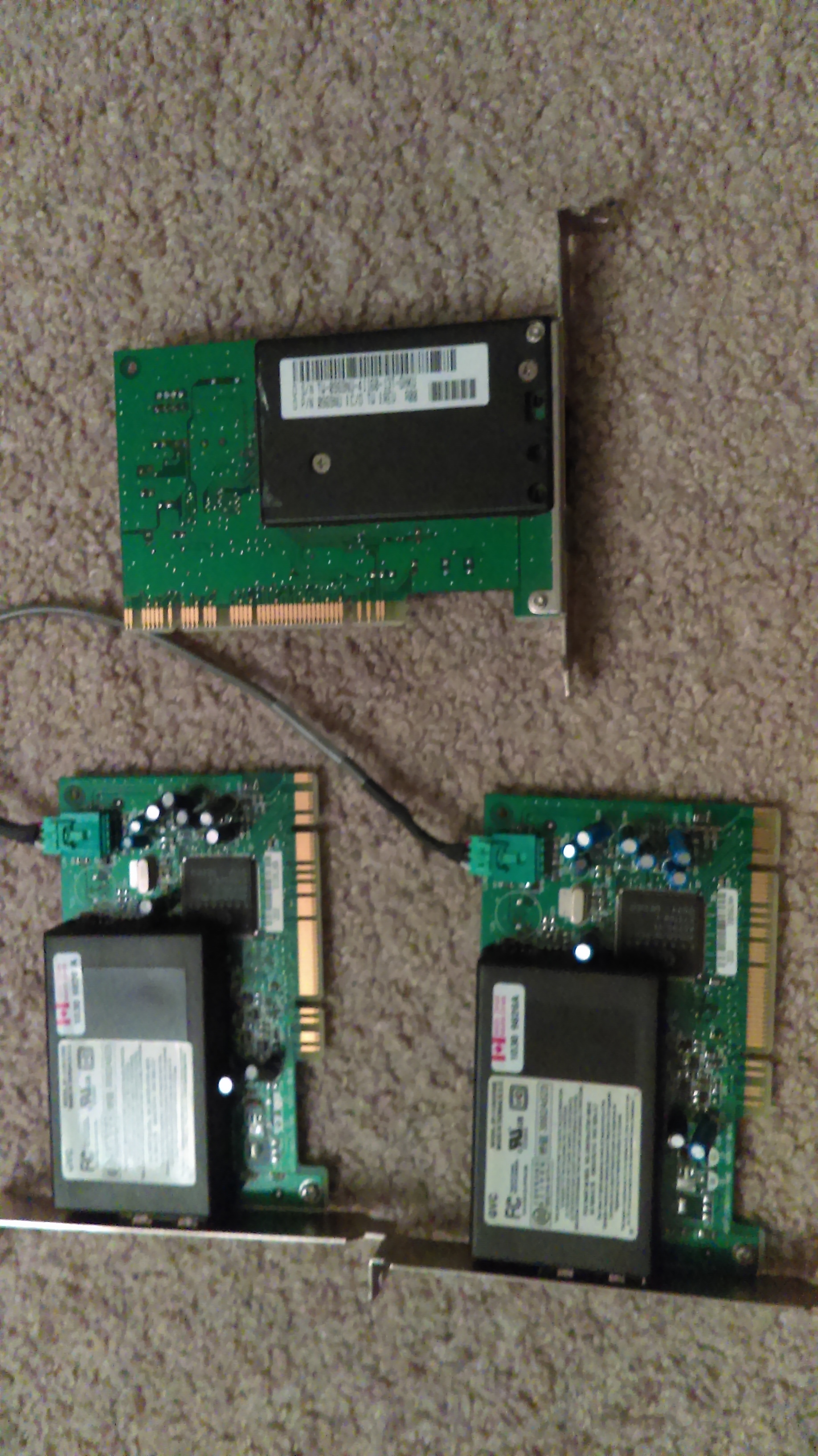

The laptop modem is good for finger card, other 2 are peripheral

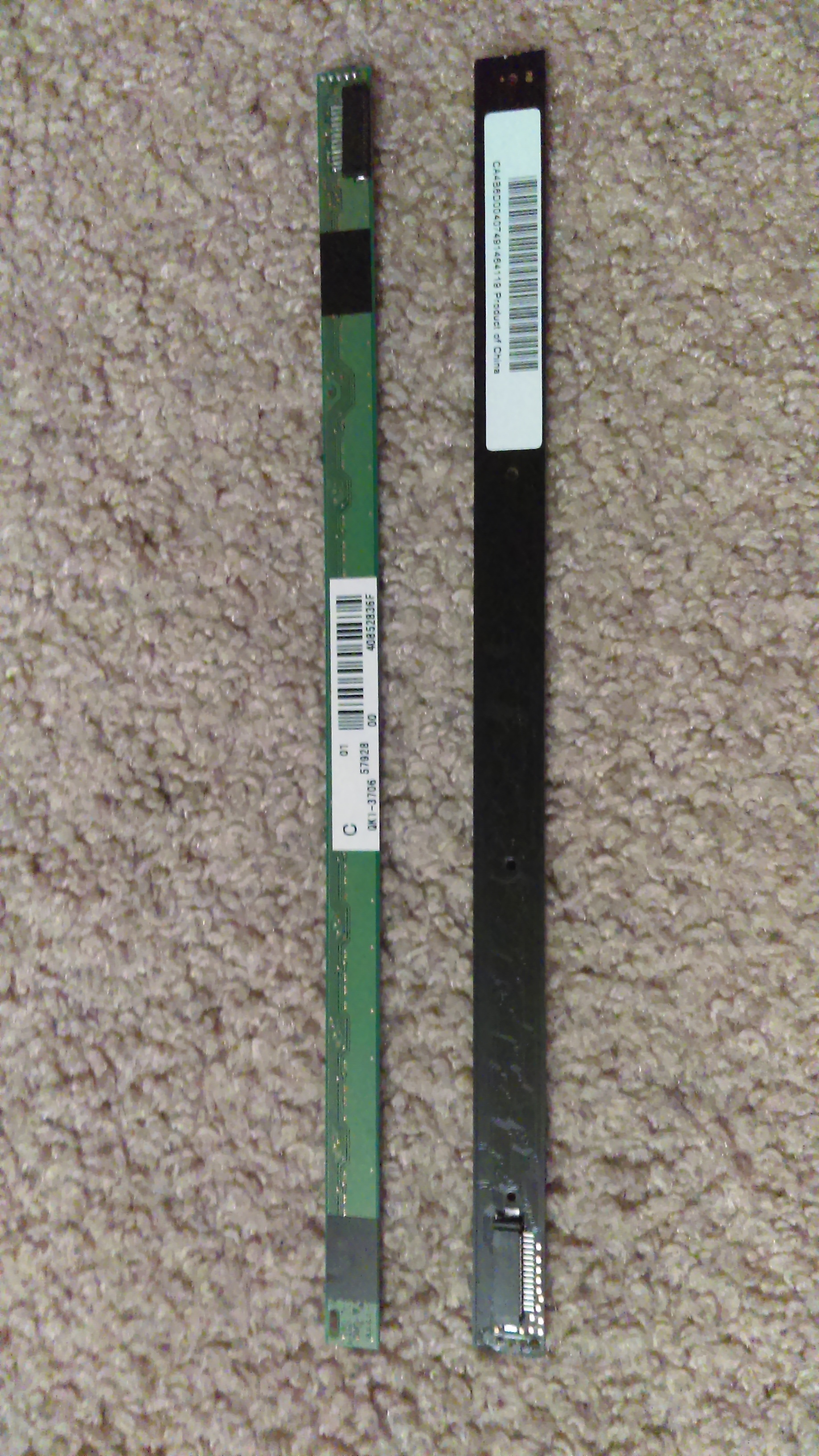

Remove the ribbon attached screen from the hp board and all are peripheral grade

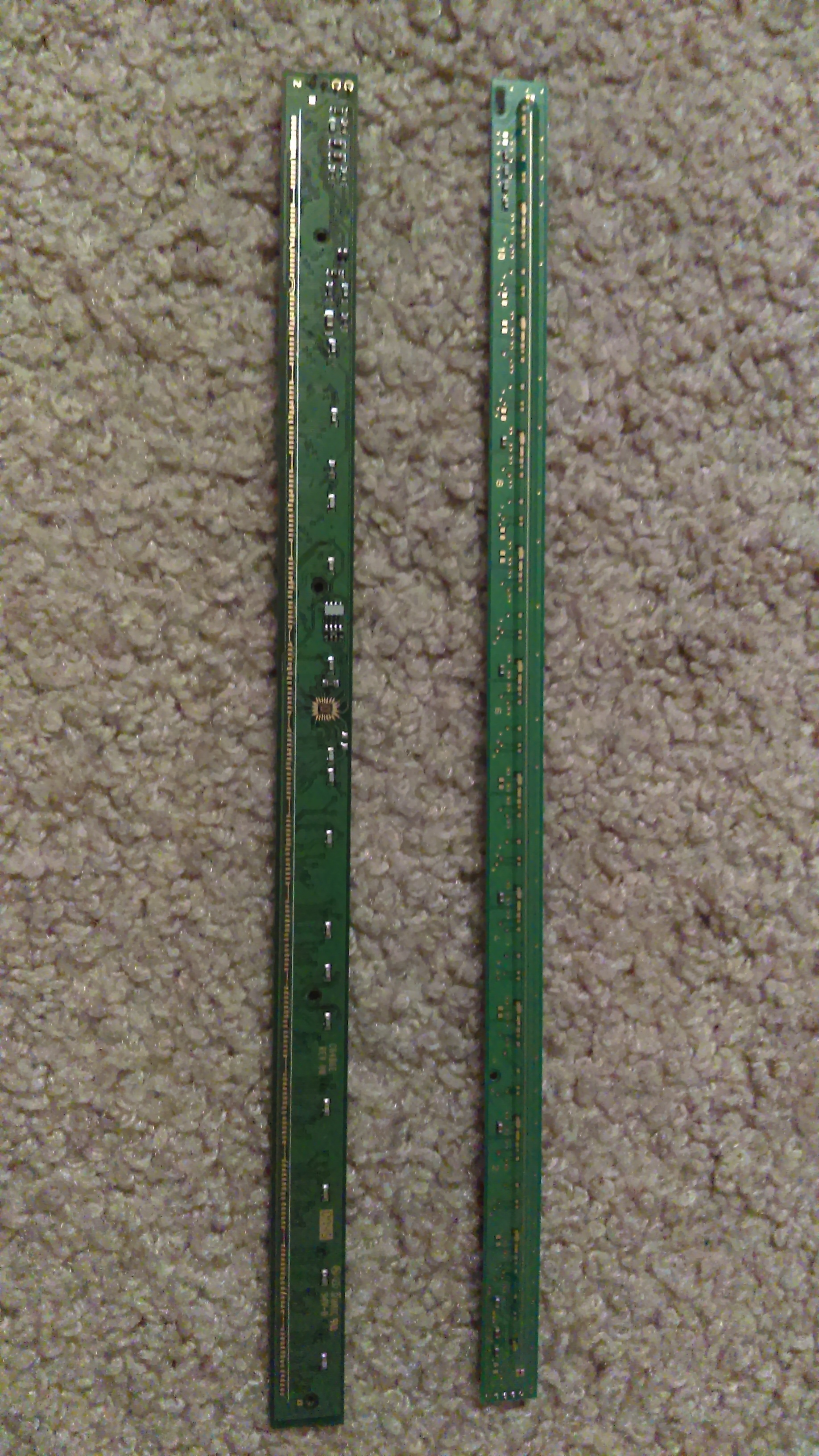

Not quite sure what I'm looking at. All three are atleast gold finger card. If they're solid state drives (ssd) then telco is likely.

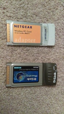

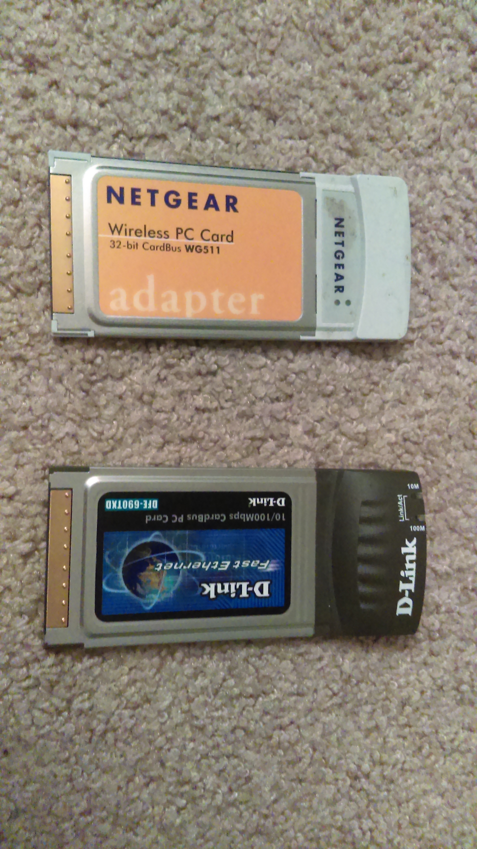

Finally remove the metal shells for an accurate grade. They Get multiple classes.
The shells have three styles. For clamped clam shell use a #1 or #0 standard (flat) screwdriver to pop them, like splitting real clams.
For clip mounts find the tightest spots and pry the edge out. And if neither method works find a screw(s) under the lables. Will be a Philips #0, a torx #5 or #6 or a hex security #6
As is they are peripheral but many pcmcia cards can fetch telco or better with the shell off.
