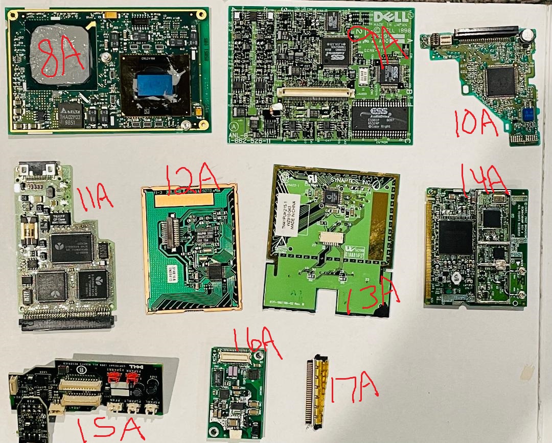

I'm a potential new customer for Boardsort and have questions about many of the same components OP is asking about. I don't know how long it takes for someone to reply with answers, but I'd appreciate it if someone did. With (1) so many categories and (2) so many, many different variations of parts within those categories, is there no easier way to identify what's what?
And yes, I've watched numerous videos and still it's baffling. Thanks.

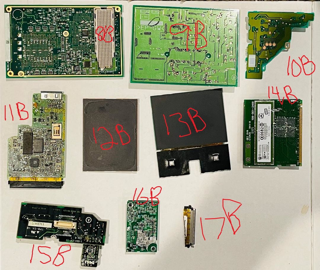

8. Apple CPU
9. Low telecom
10. High peripheral
11. High telecom
12 and 13. At least low peripheral, but laptop touchpads are often high peripheral so I'm not too sure.
14. Clean gold finger card
15. Low peripheral
16. High peripheral
17. Connector end
