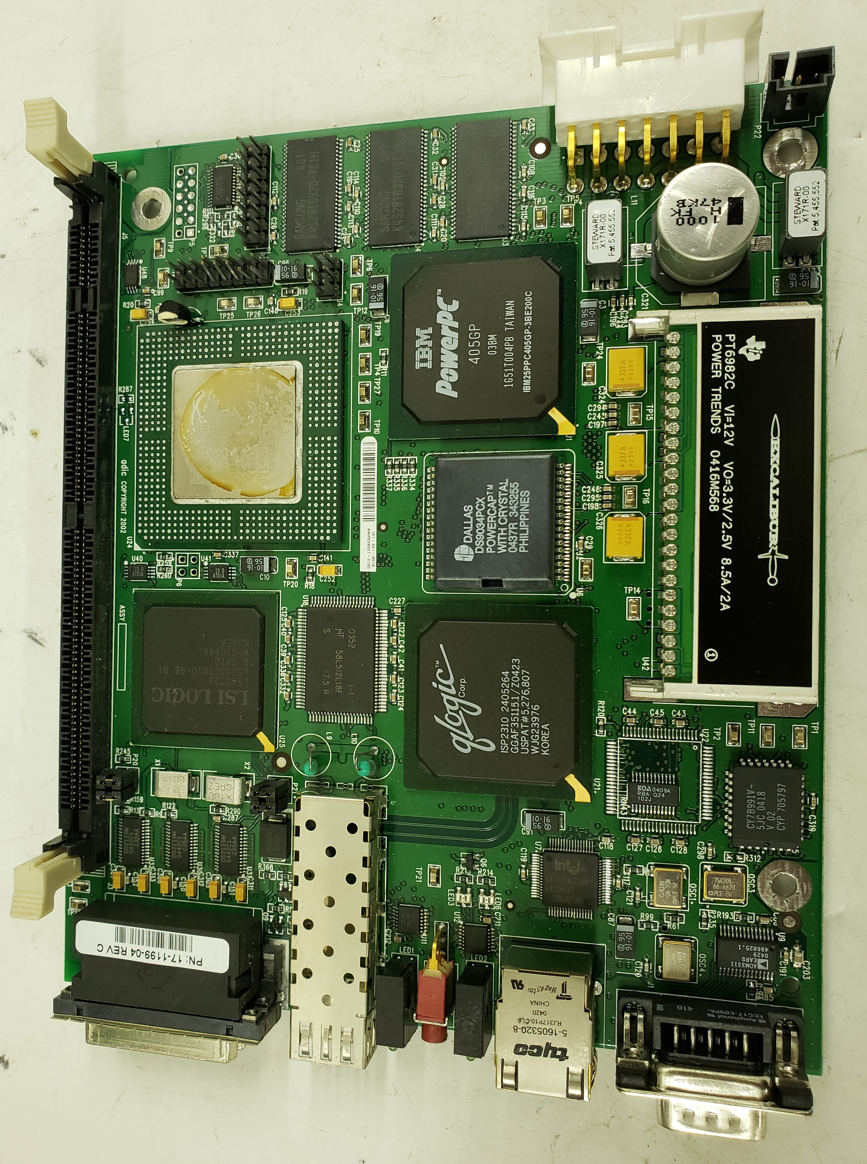

Firewall Board - this is out of a Symantec firewall. It had a processor and memory on it, but does this count as a motherboard or something else?

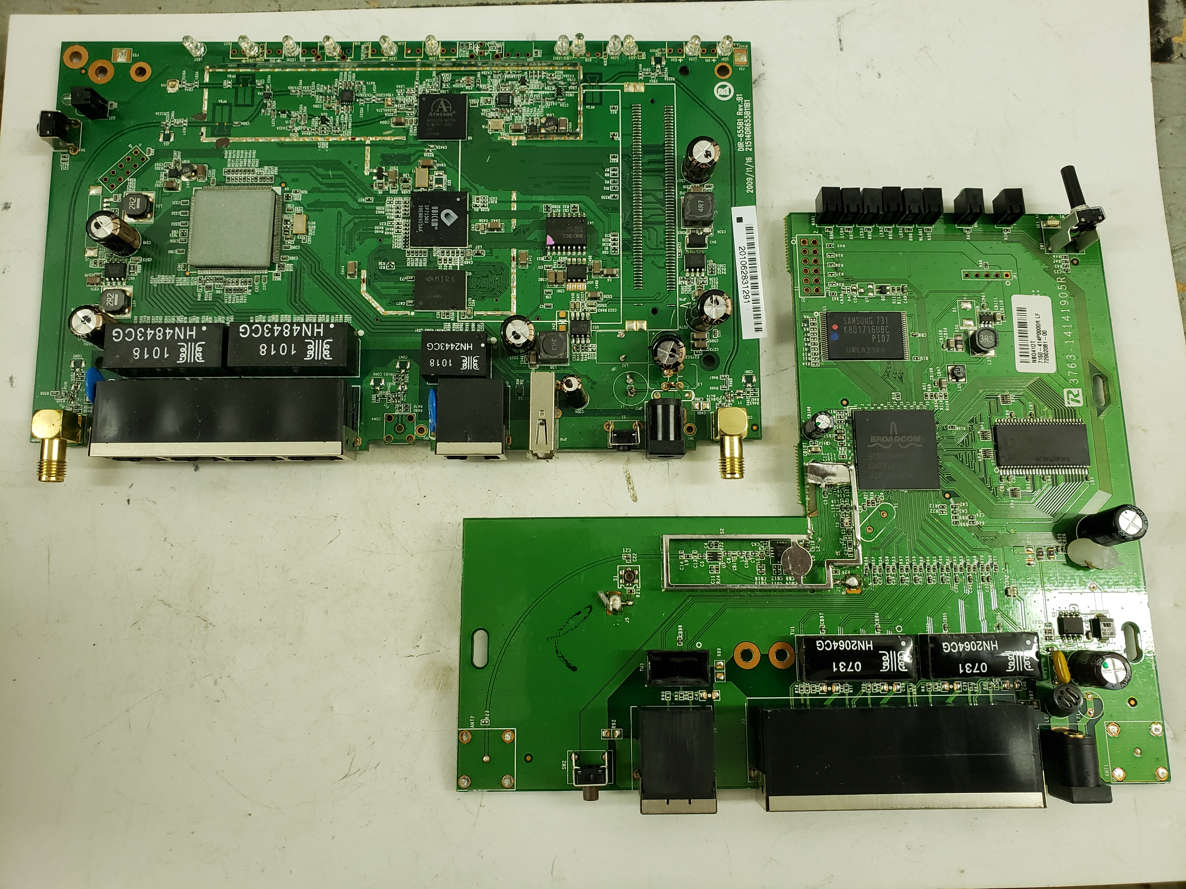

Small wireless router boards - Do they count as low telecom?

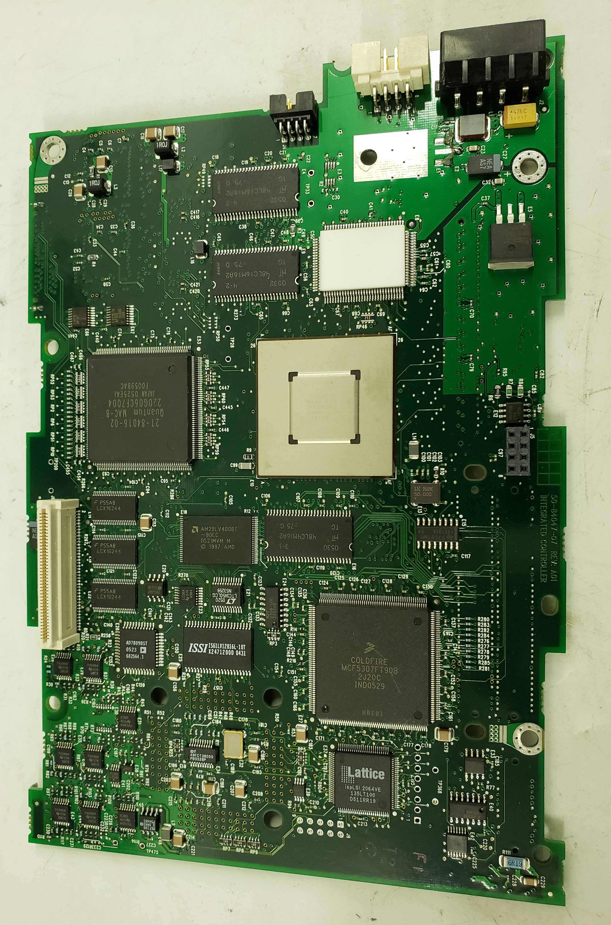

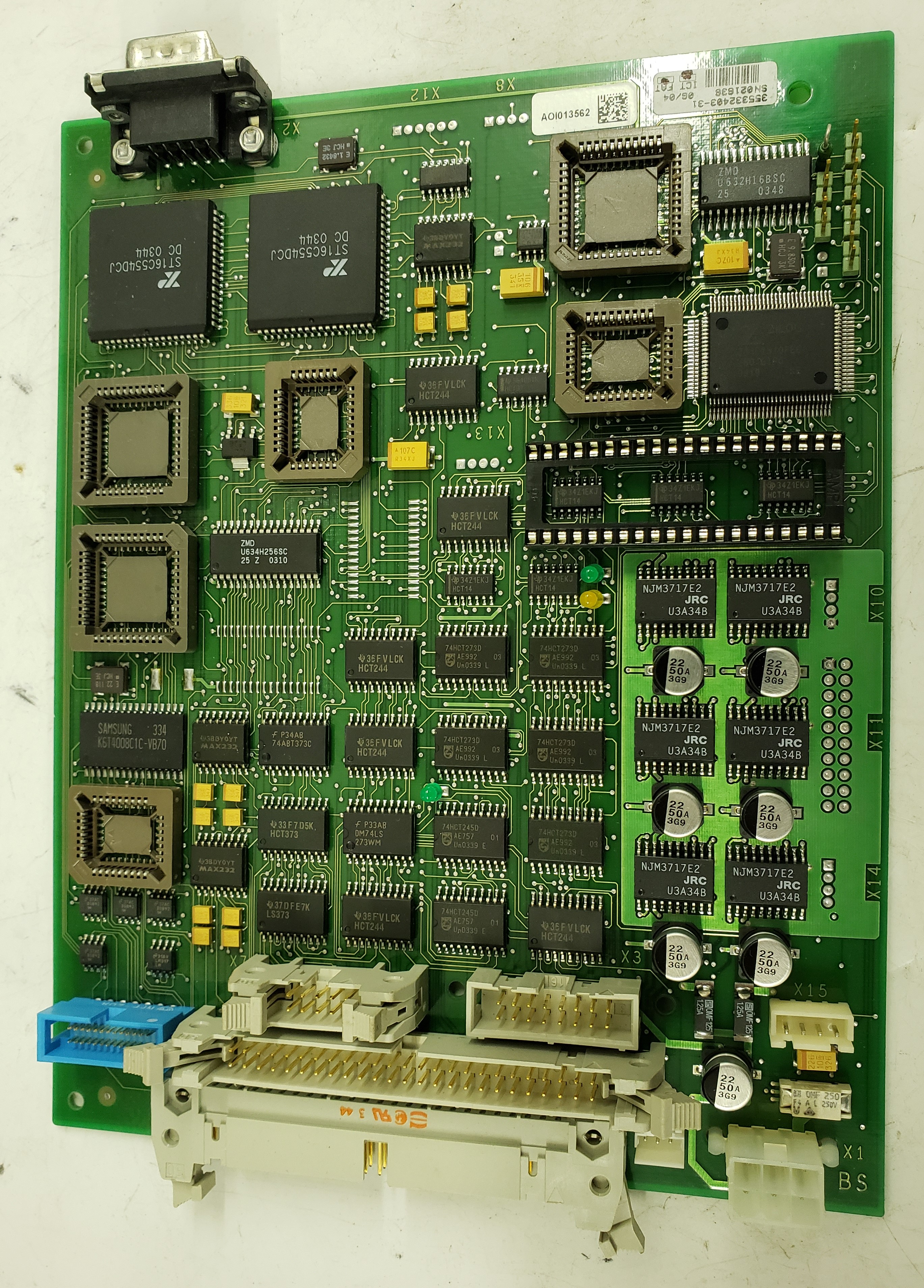

Next few boards came out of Dell DLT tape drives. What category for them? High Peripheral, low or high telecom?

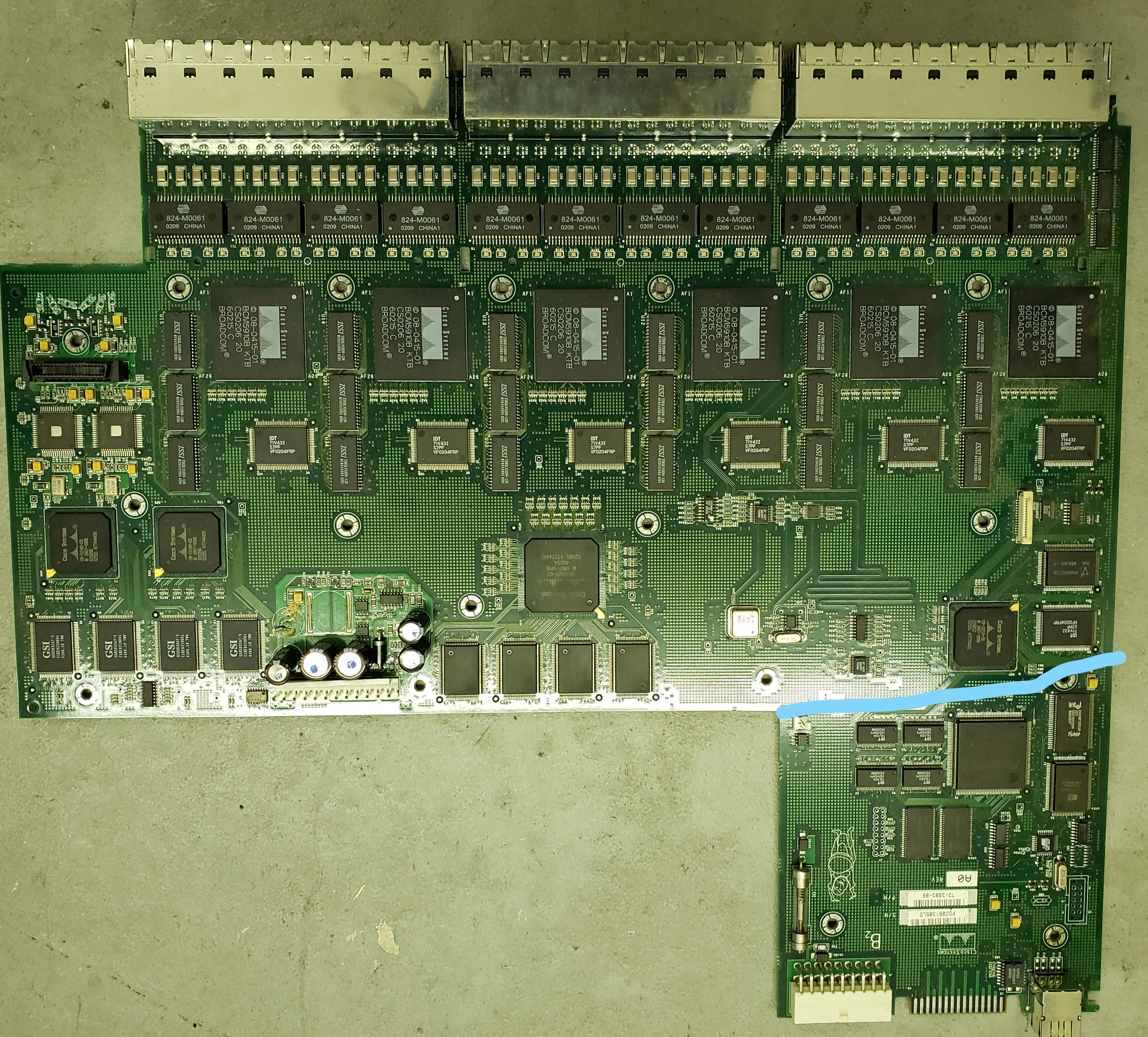

The last board is a Cisco switch board - Are you allowed to cut the board to fit in a box? If I cut along the blue line shown is that allowed or should I just find a larger box?

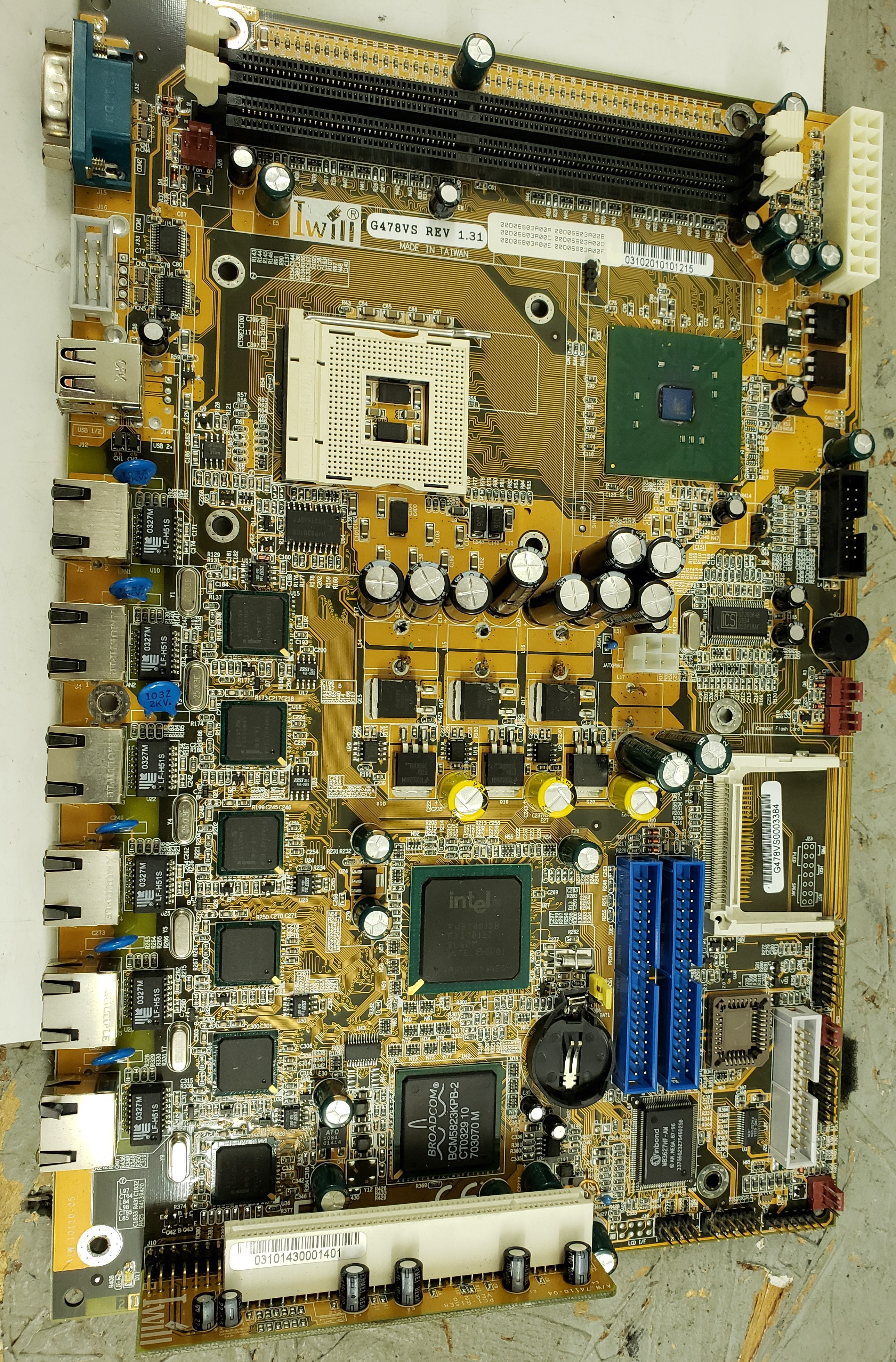

Okay, the first 3 boards would be high grade tele. Fourth board I would consider high grade periph. Board 5, high grade tele. Boards 6,7 (the 2 together in pic) both high grade periph. And finally the brown board would probably go as Small Plastic or Metal Socket COLOR Motherboard. There are just my opinions.
