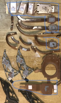

I know these are copper or mixed copper, but honestly I'm not sure they would go with anything listed on the payout list. Most of it might go into copper #2? One of them has a copper heat sink on it... some of them have alluminum heat sinks (painted black). I just don't know how to classify this stuff.
 Post subject: Re: It's not a board!
PostPosted: Tue Mar 31, 2020 1:52 pm
Posts: 10585
Circled are copper heatainks. Clean and one dirty
Outside will be #2 copper and dirty (paint) aluminium.
Heat sink bars like this are sufficiently soft enough you can cut, or bend to break, the copper extensions off.

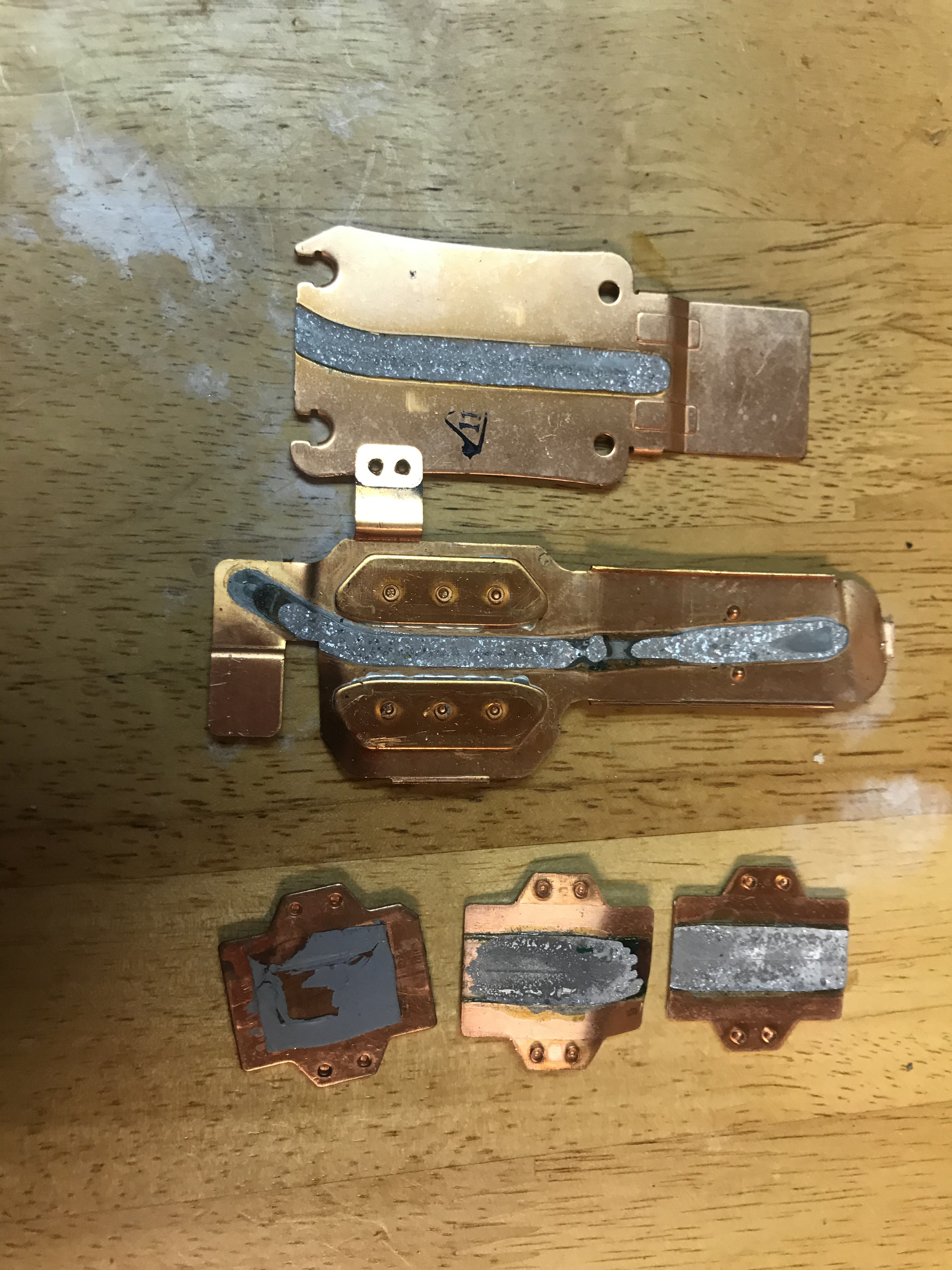

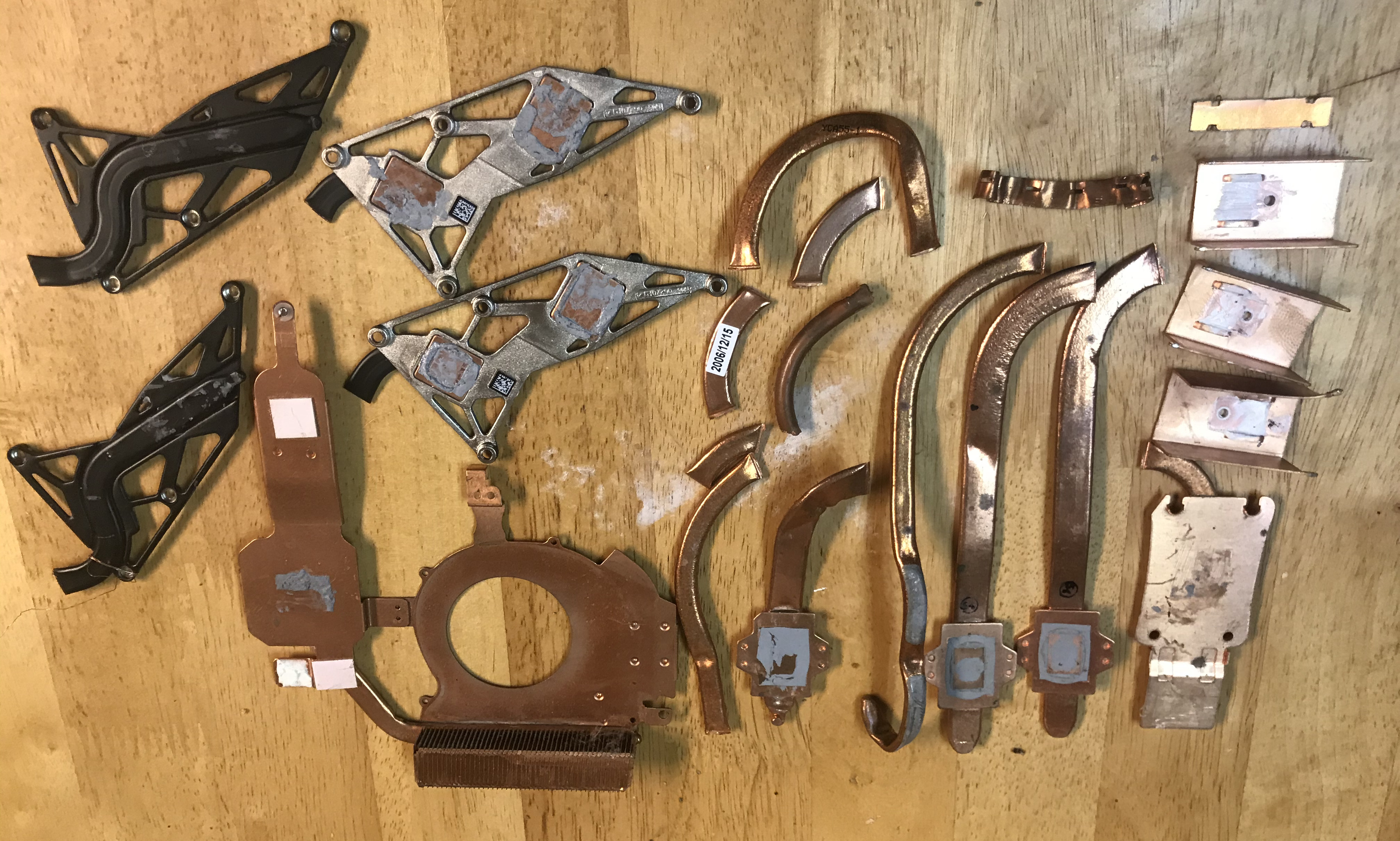

So I popped them off like you said lost... this is what they look like now. Are you sure these will go in clean copper heatsinks?
PostPosted: Fri Apr 03, 2020 11:30 am
Posts: 10585
As long as you removed and aluminium or brass; and wipe off any freely removable paste. Yes.
As I’m sure you noticed those design is made by punching small copper nubs through holes in the connecting pipe. They come apart easily.
I’ve sent these in as clean copper heatainks (and clean copper) in the past. As for the pipes if there’s any silveride solder at the end just nip it off.

Ok by paste you mean that old thermal paste correct? I can probably get that off... but as you can see where the copper pipes used to run that stuff is like cooked on there. I don't think I can get that stuff off. Would that still make it dirty?
PostPosted: Sat Apr 04, 2020 12:59 pm
Posts: 10585
I don’t think it will make a differ Here.
By clean in the heatsink categories he wants nickel and steel rivets removed. Brackets. Screws. Etc.

Stuff like this, I take to my local scrap yard. Frequently, I find a lot of copper and aluminum/copper heat sinks. I do what lostinlodos does and try separating the copper from the aluminum as best as possible. What I can't separate, as long as there's no ferrous metal on there, goes as clean al/cu radiators.
One tip I will share is if you find any heat sinks with the solid copper cores in them from desktop computers, you can bend the fins on one side of the heat sink and cut into that gap with anything you have that can cut metal. Cut deep enough into that gap to where you just barely touch the copper core. Use a hammer and a screwdriver or other tool to tap out the copper core. Core goes as #2 or #3 copper (depending on buyer), and remaining aluminum goes as extruded aluminum (in many cases).
