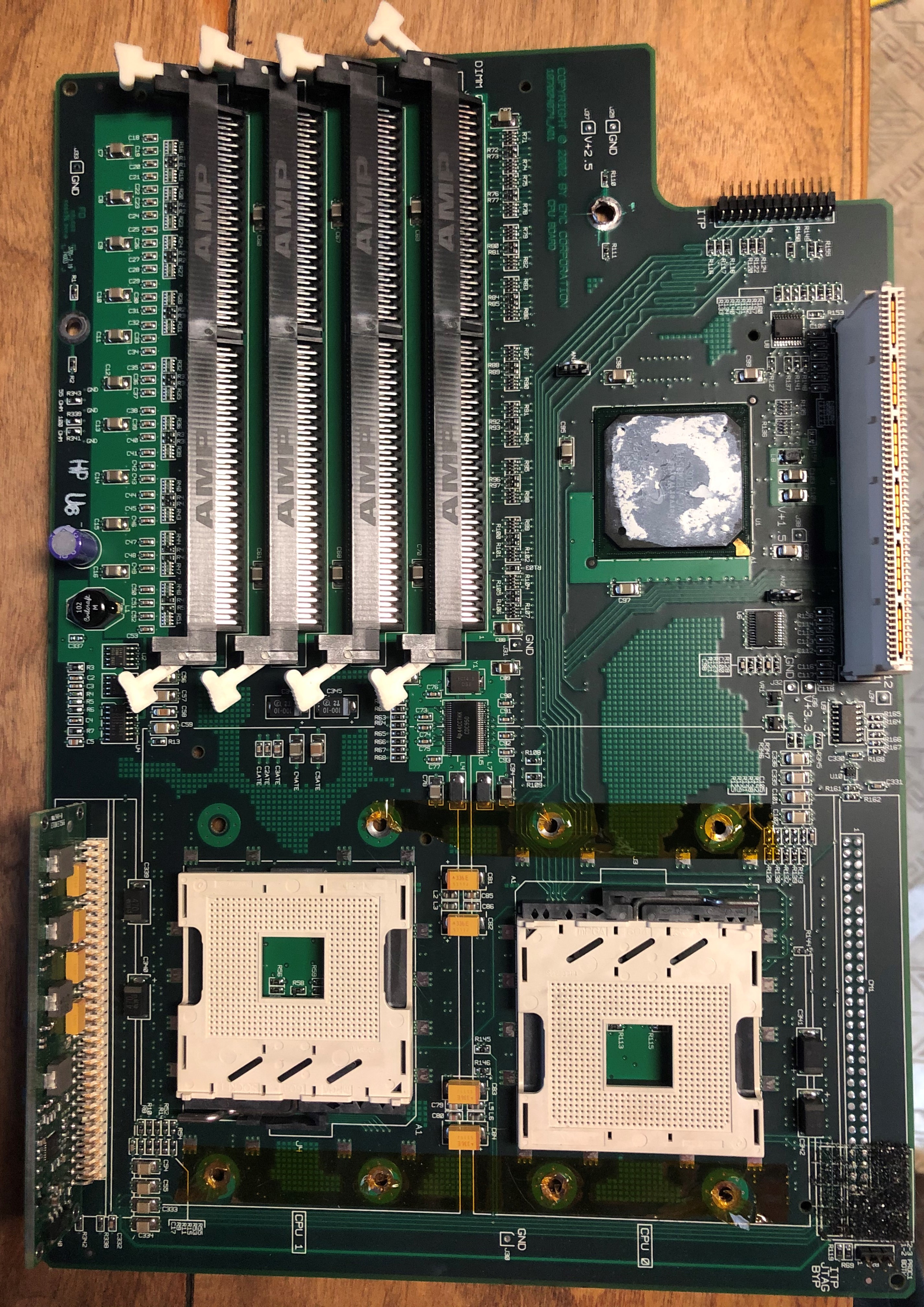

1) technically a large socket motherboard. Think we’re good for low telco here. You can remove the cmos (AM chip) and the controller next to it.

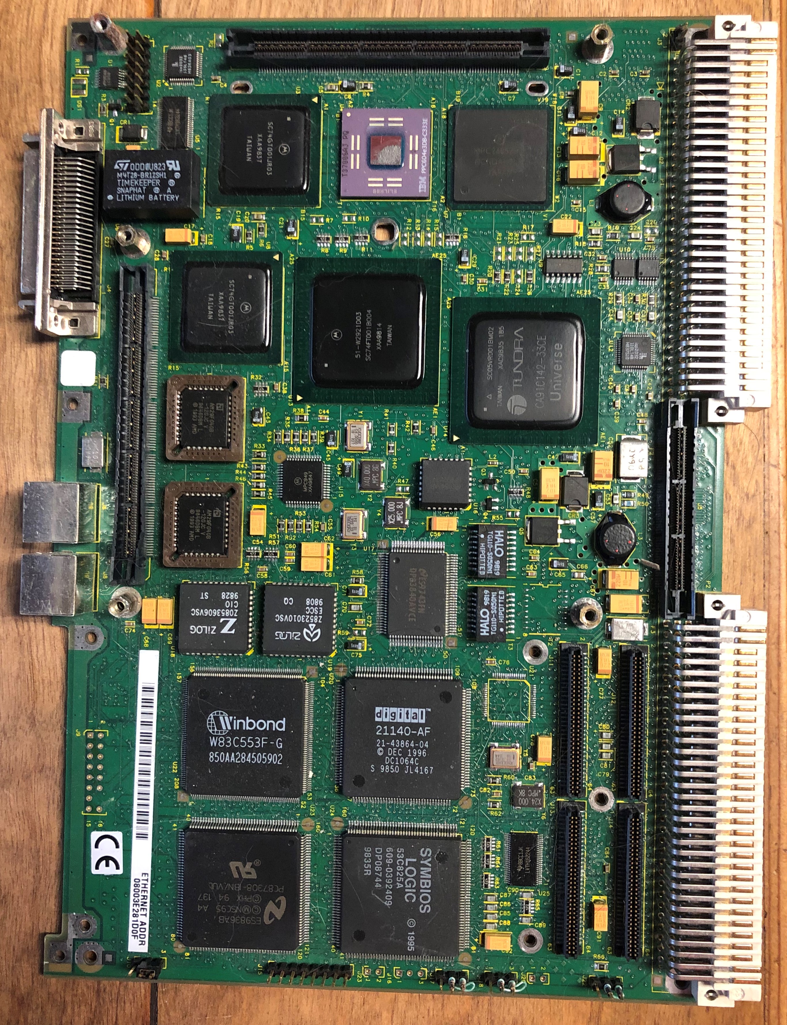

2)peripheral. Was also a large socket motherboard but someone removed the sockets or cpu and co-prof.

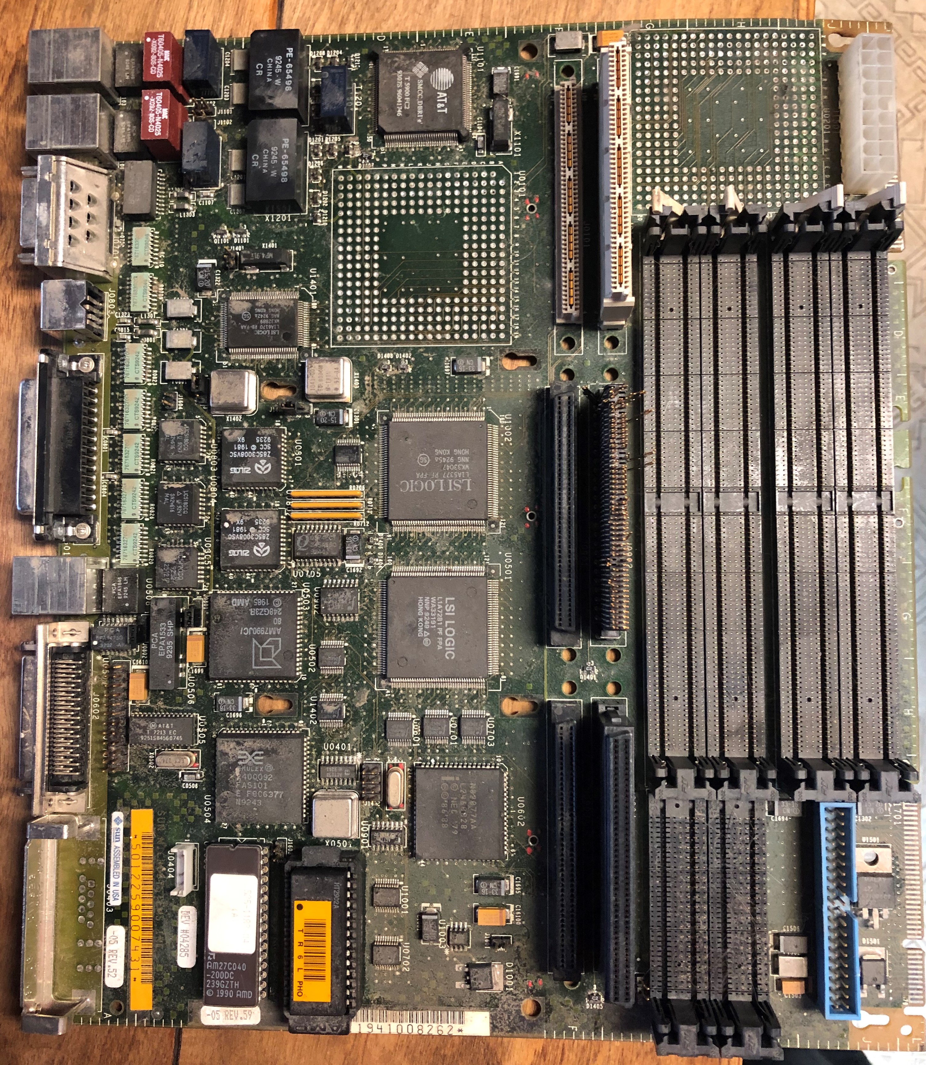

3)large socket. Remove the ami bios and other socketed ICs for IC.

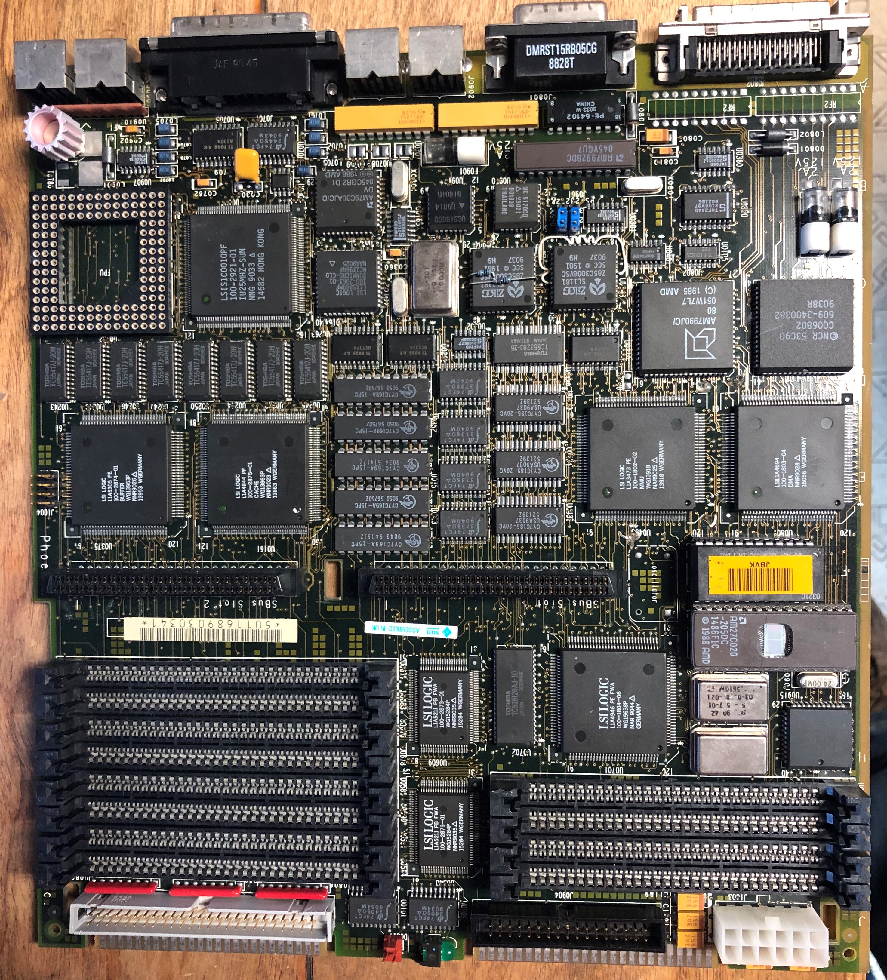

4)peripheral. Missing too many requirements motherboard class.

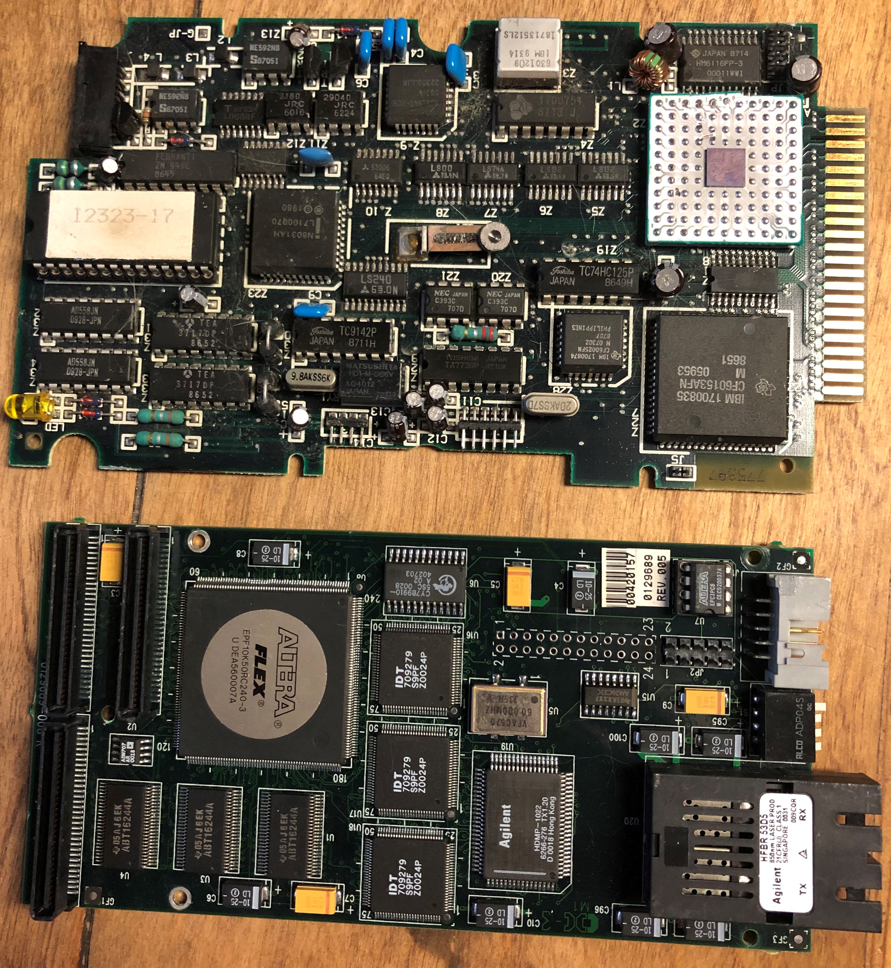

5)high telco. Full coverage. Thick pins offset socket weight. Nice IBM PPC ceramic.

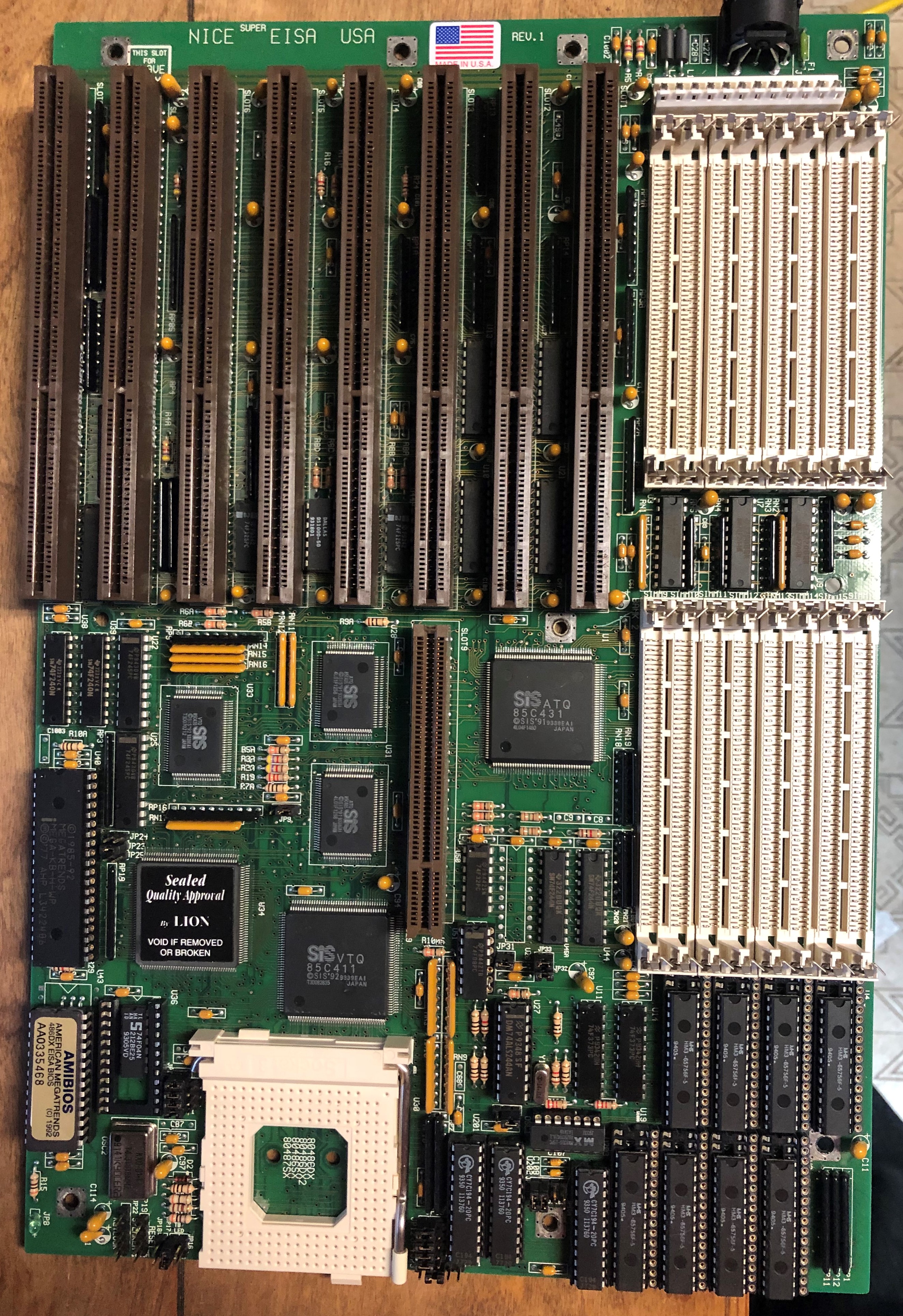

6)both borderline but I’ll say high telco
