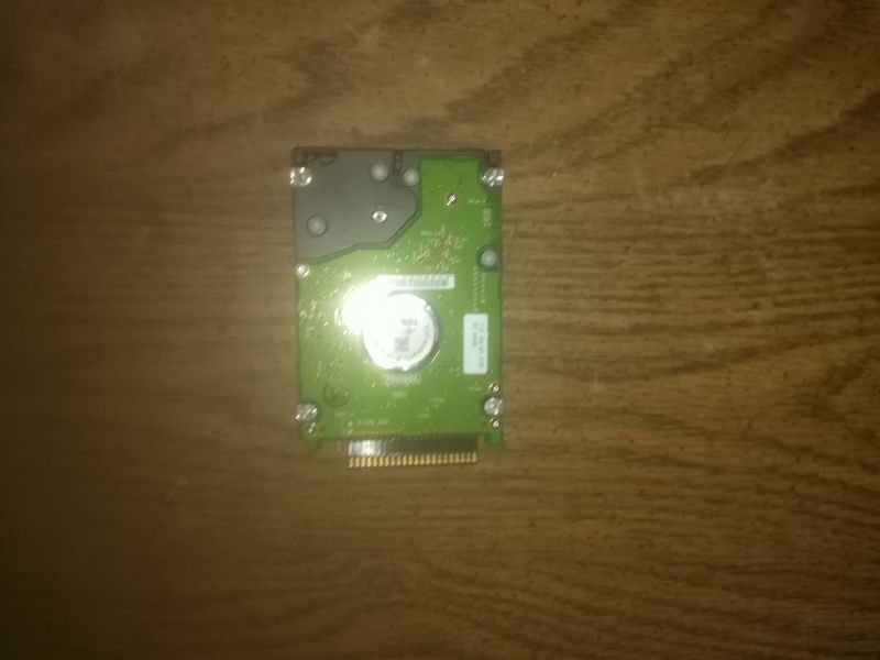

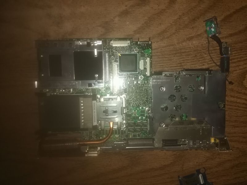

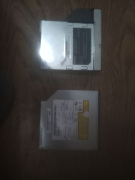

Not sure if i need to remove anything else or how to sort. Thanks

On the motherboards, remove the heatsinks, (the whole assembly of the copper heat pipe and the radiator at one end and the pad at the other), under them will be the CPU socket, it may require turning a plastic slotted screw to release the CPU, don't break pins off the chip, the motherboards will both go as laptop motherboard, CPUs are separately saleable at CPU prices, on the CD drives, hard to tell, pictures blurry (I have same problem) but if you haven't already, take/tear them apart, and liberate at the minimum, the circuit boards, which sell as their own class CD drive boards, there's other things inside but very small (brass, motors, aluminum) you can sell the hard drive whole but youll likely get far more if you have the small screwdrivers to take the board off the back, you can get the rest for fun, I like the magnets out of them

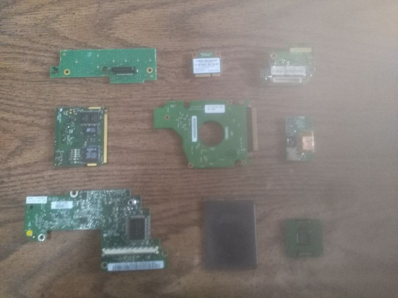

As for the picture full of smaller boards, the one with the gold fingers (bottom,middle) is gold finger ram, the larger board on right is either peripheral or CD drive, (need better picture) , the rest too blurry

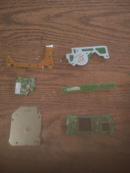

I cut the flash off and took new pics of everything except the motherboards. According to my computer geek son, one CPU is unremovable. That's why there is only 1 CPU in the pics.

Left
Low
Peripheral
Low grade
Right
Midgrade
Peripheral
Cd/dvd controller
—-___—-___—-
Peripheral/gold finger card/peripheral
Middle
Gold finger card/hard drive board/peripheral
Bottom
Peripheral/peripheral/green fibre no metal

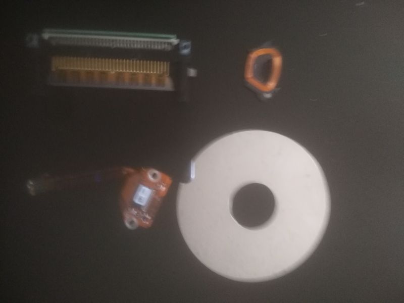

If i could get the spindle of the 2 boards, would that change the grade?
Also one more pic of stuff that I'm not sure where to sort.
 Post subject: Re: laptop
PostPosted: Sat Feb 15, 2020 2:18 pm
Posts: 10498
No. The metal boards keep it there regardless.
Gold pin connector/dirty copper
Dirty copper/hard disk platter
