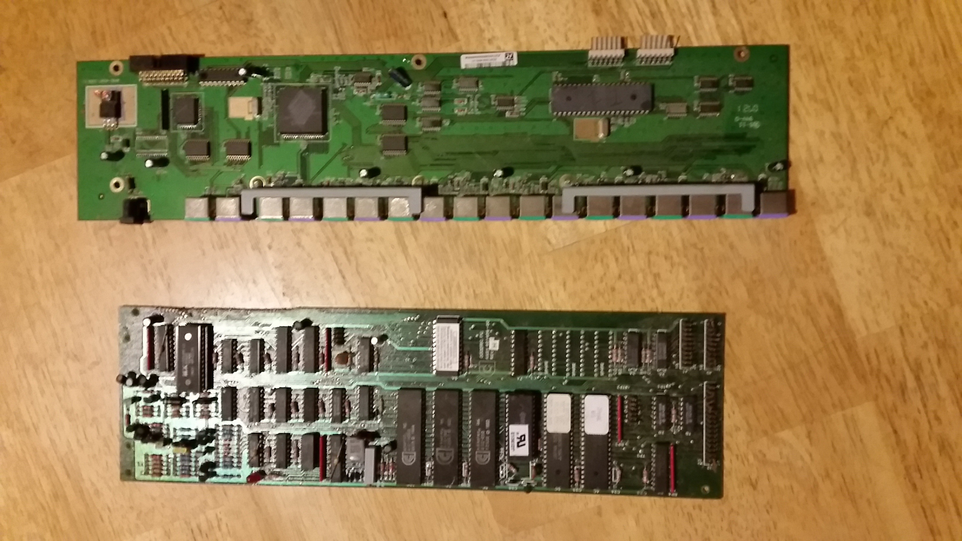

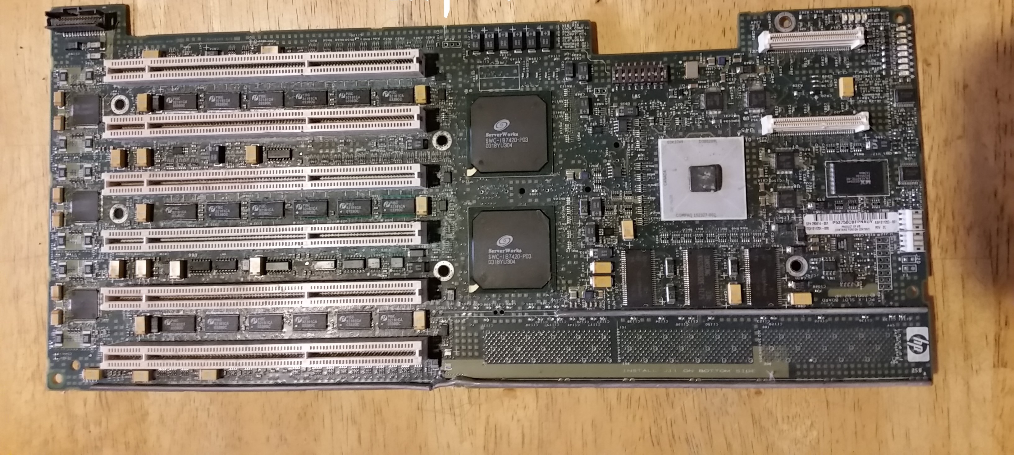

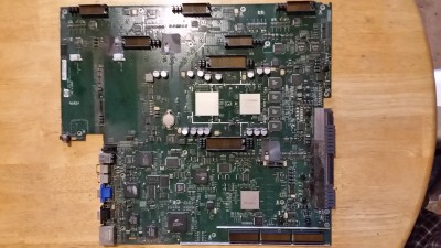

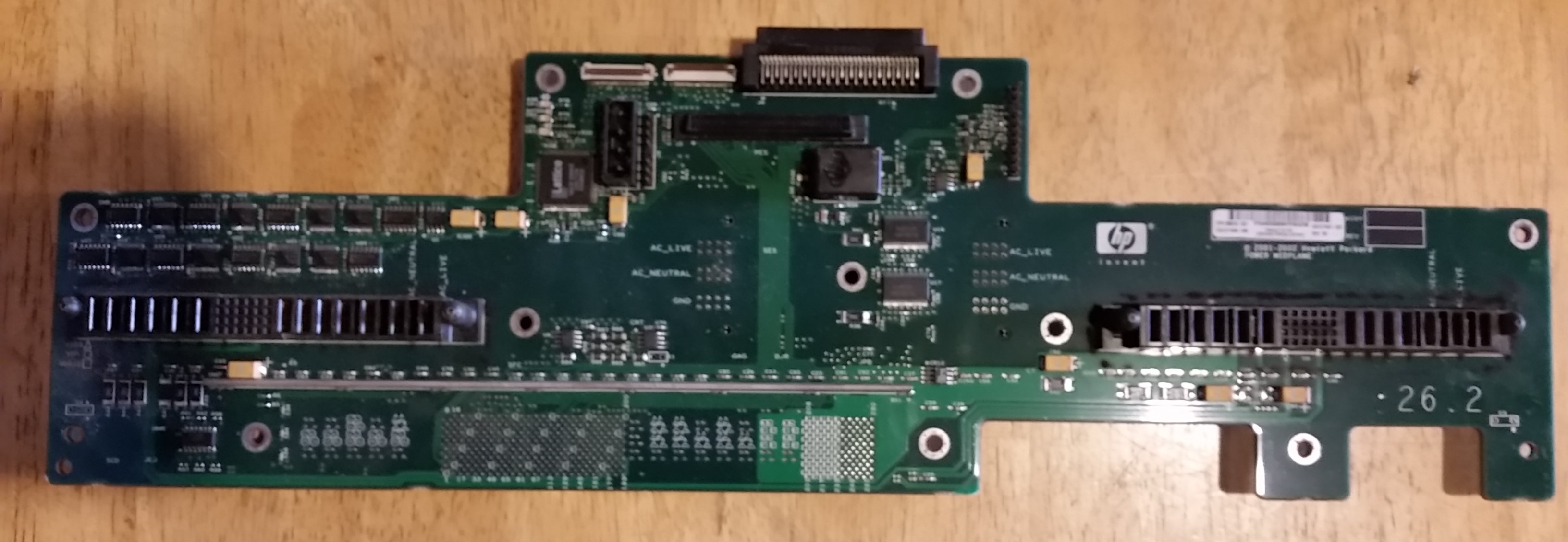

please help with grade, sometimes it's not easy

Peripheral: missing too many requirements for a mobo
Peripheral
Peripheral, this one is close to making low telco but just too much board for it
High telco/peripheral
Low telco
Peripheral

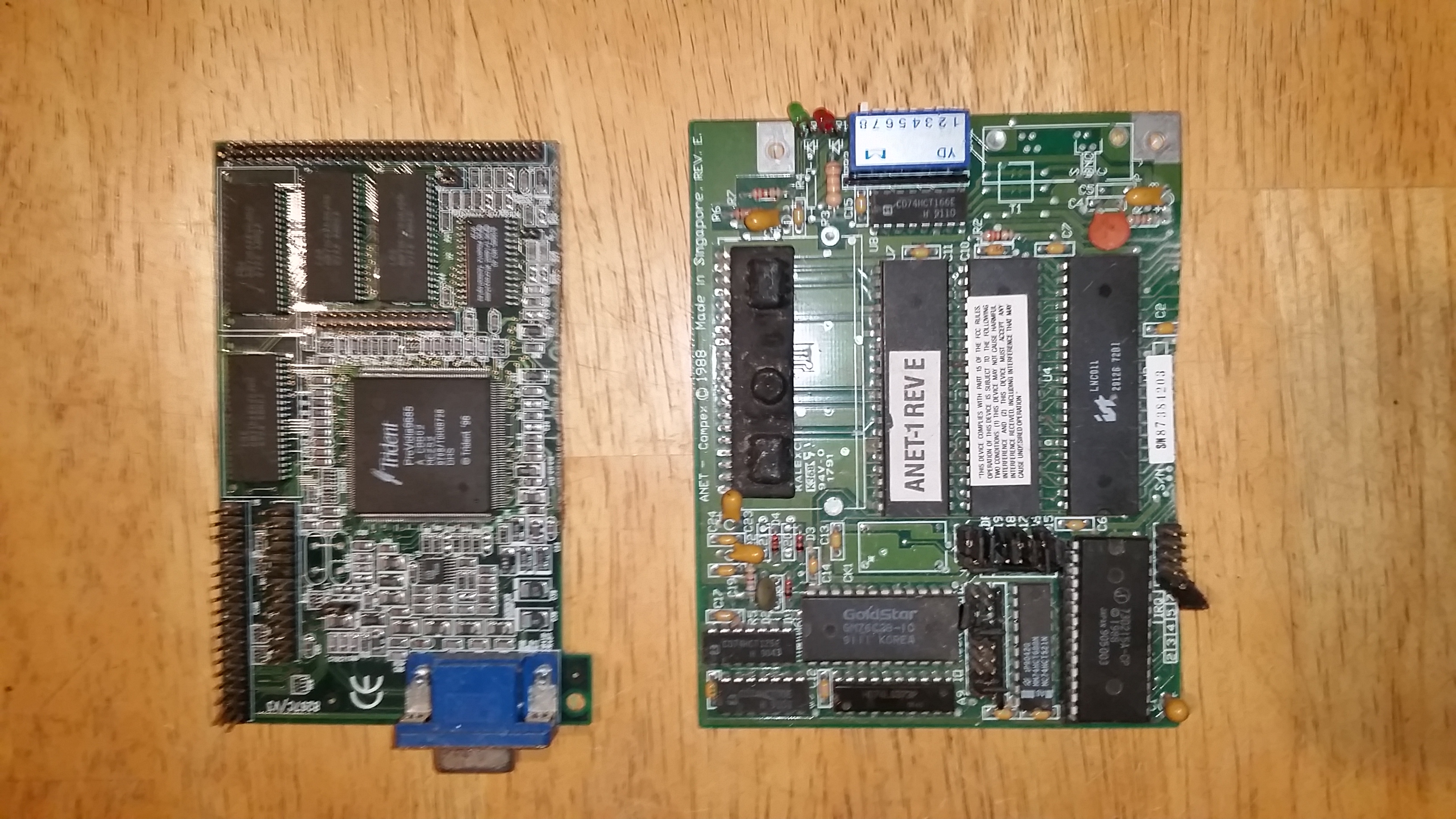

Gold finger card

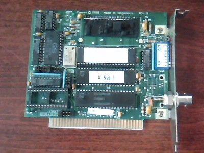

Video card trimmed gold finger card., network card low telco. An ArcNet card. Kool!
PostPosted: Wed Oct 30, 2019 8:38 pm
Btw the ArcNet card would otherwise be trimmed finger card if not for the population. Working they fetch over $150. Dead they run $25-$50.
Trimmed it’s now scrap.

First board has a battery as well.
