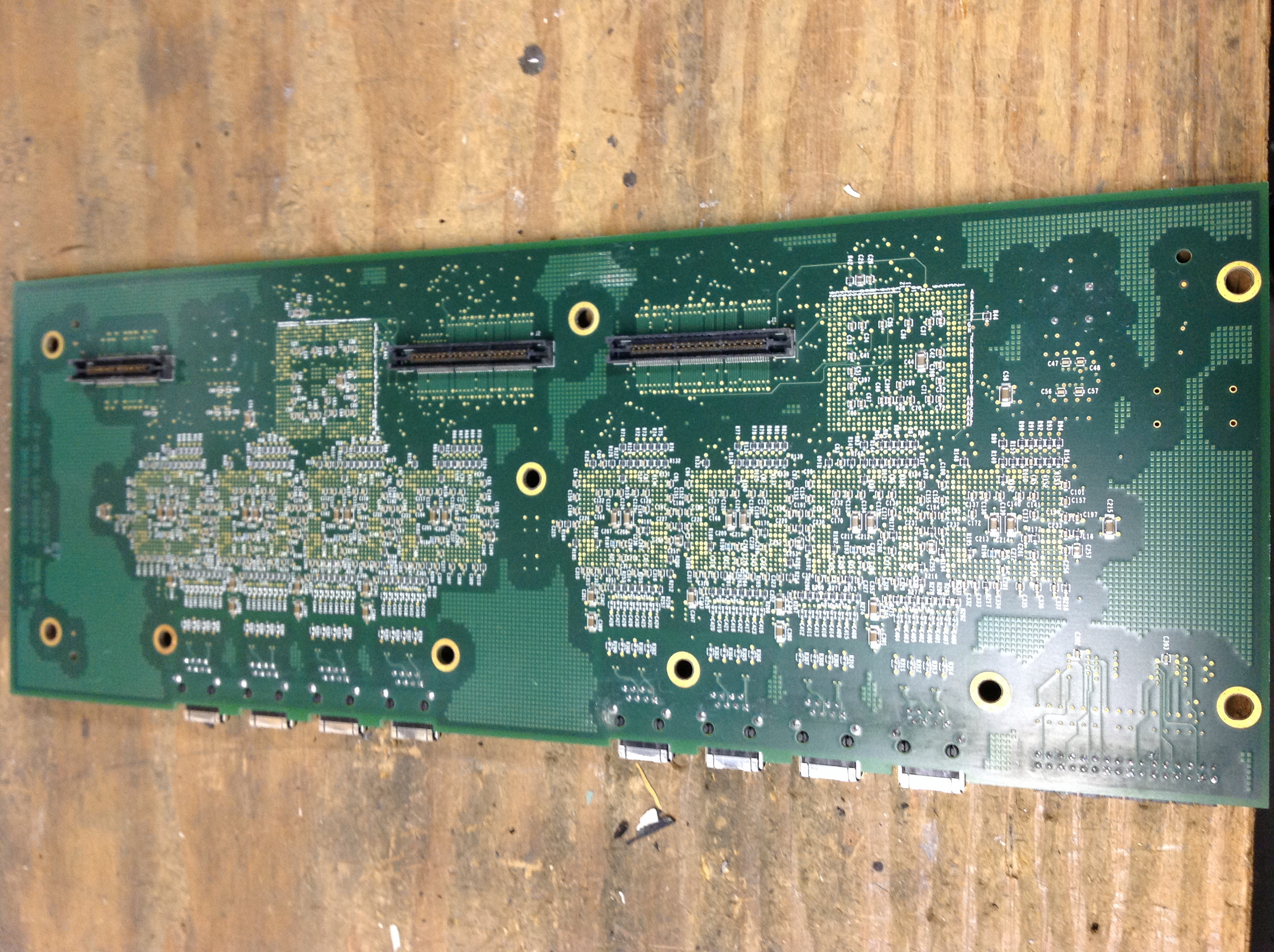

Number 5 i believe is on the low end of telco.

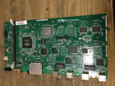

3 leave the fingers and again believe you're skirting the edge if telco
Remove the bel unit. Its has a battery

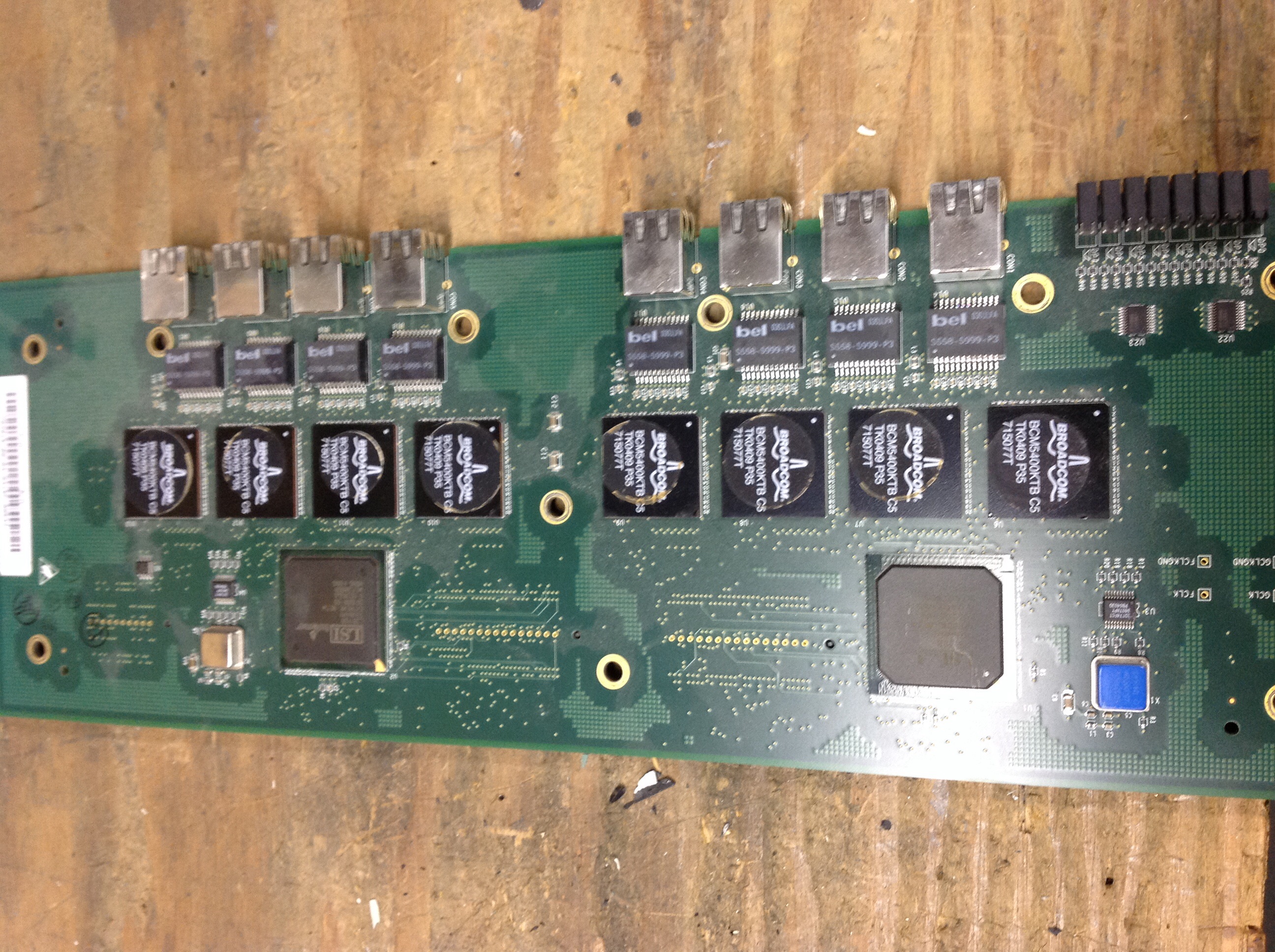

2 telco... only because it's double sided flashed with those flatpacks. interface board.

Number 2 has Bel boxes behind each eth port, are these batteries? Will remove if they are.

Yes remove all bel Dallas or thor Plastic squares/cubes you find.

Actually check those bel cubes on 2. If it's plastic it's a bettery pack. If it's ceramic it's a solid state capacitor or resistor.
Use a razor knife/box cutter. If it cuts/digs it's plastic.
If it scratches it's ceramic. Ceramic stays. Plastic goes.
