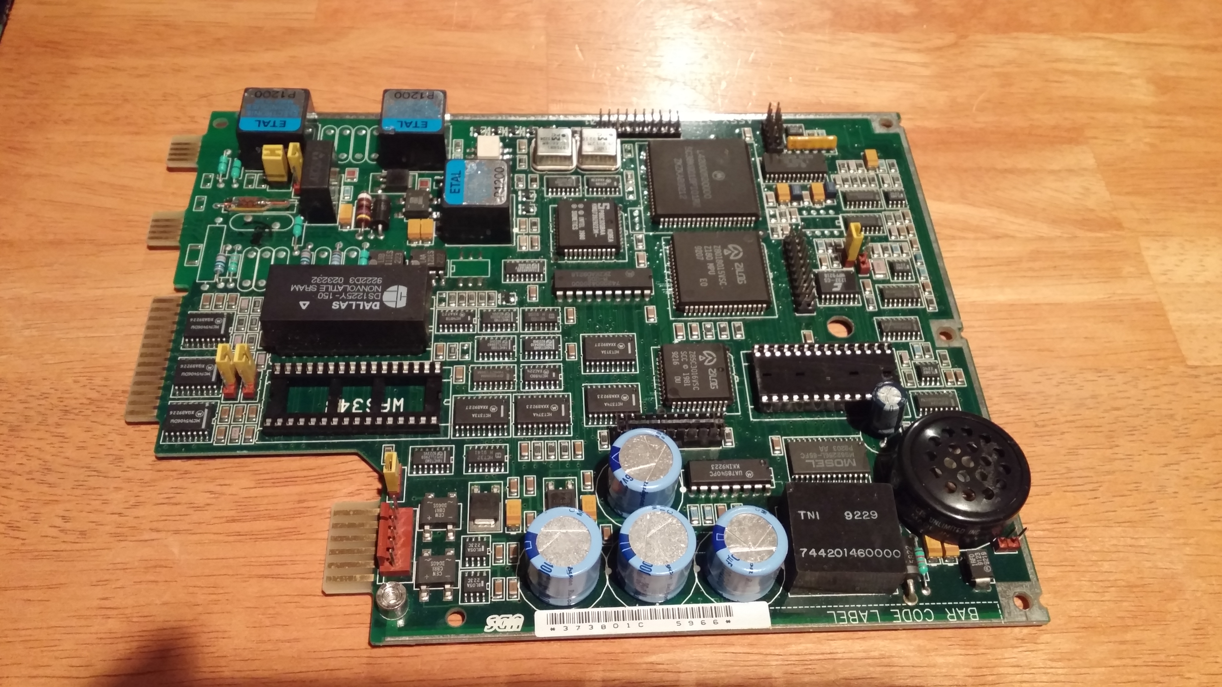

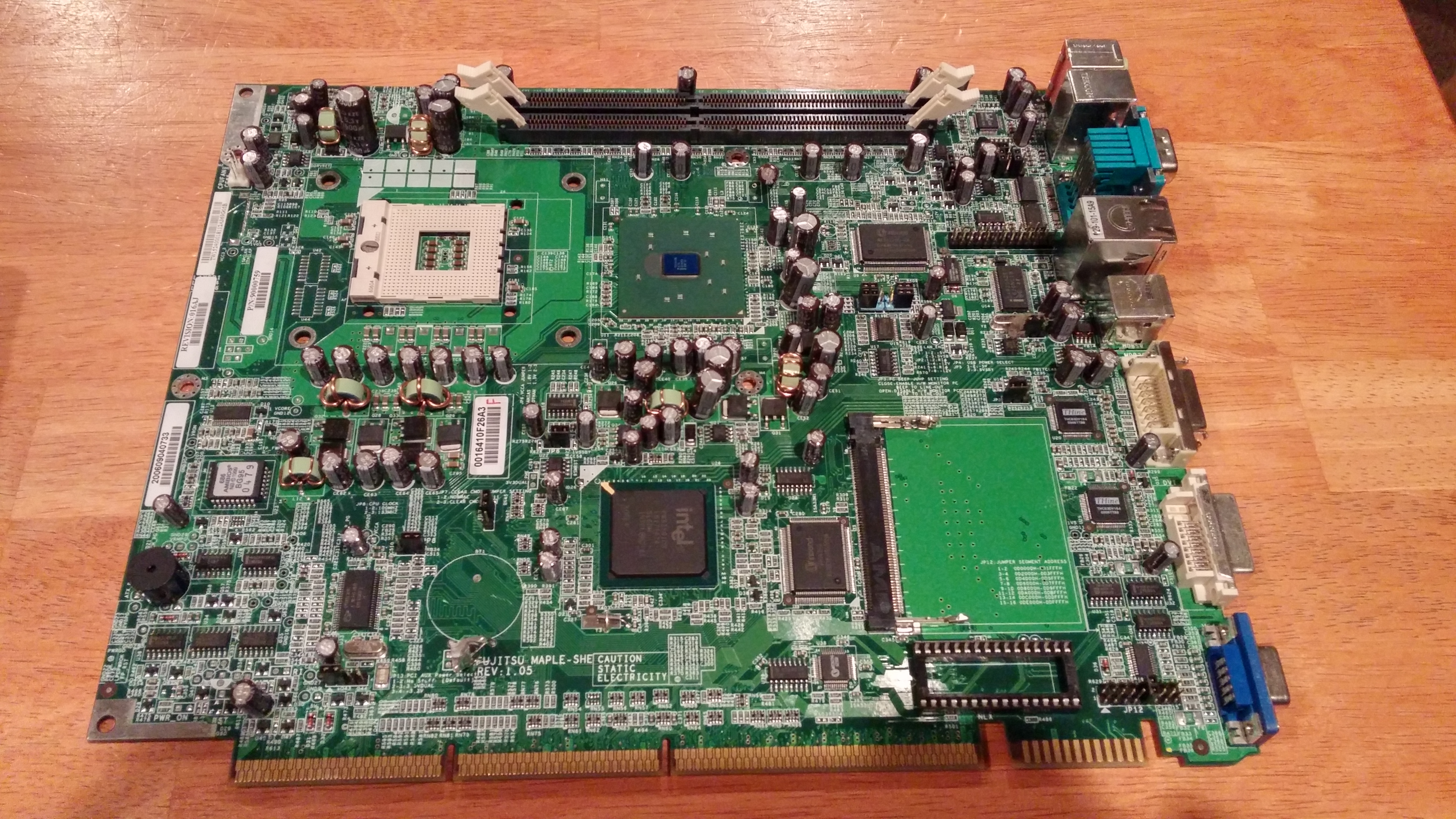

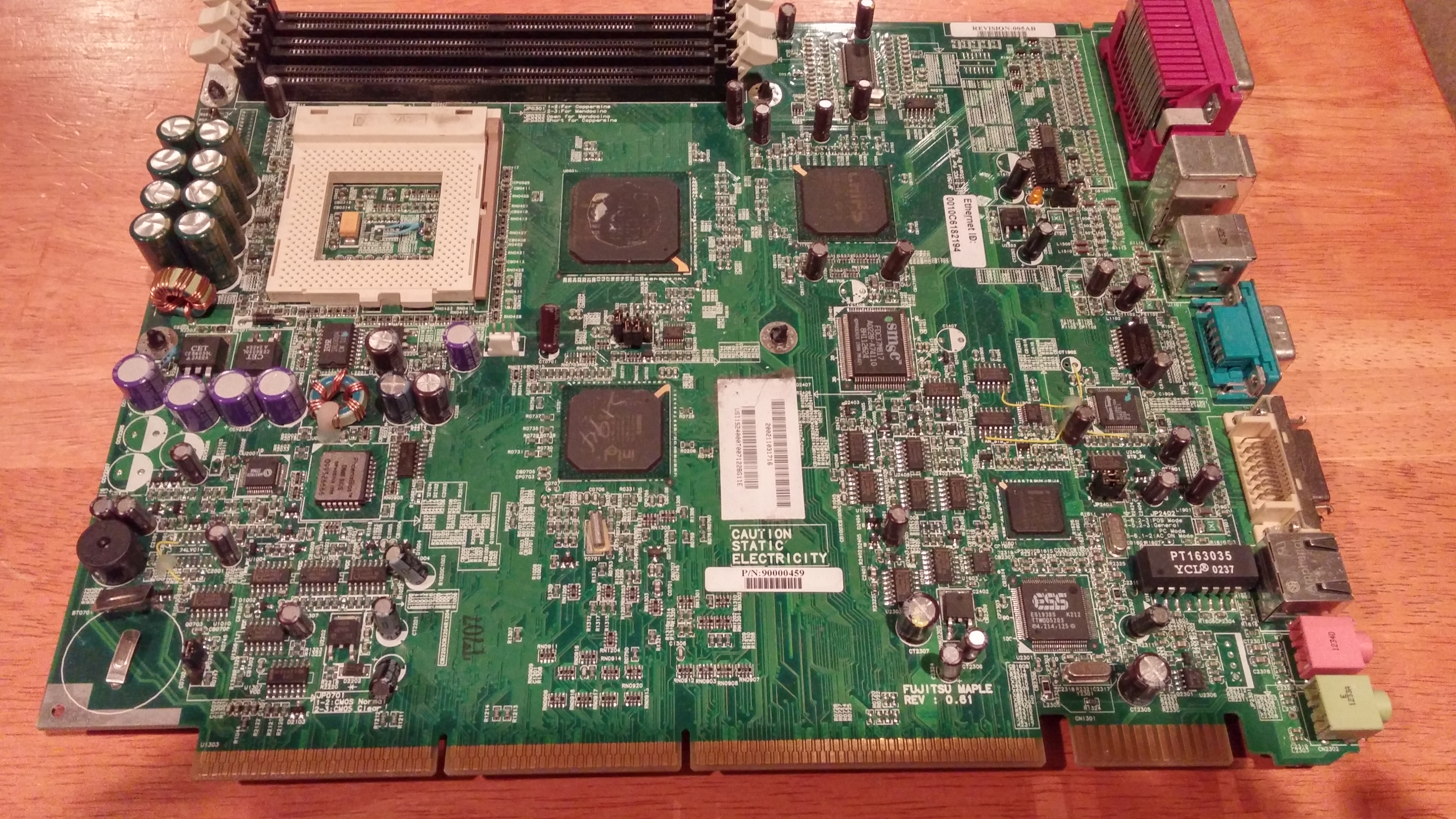

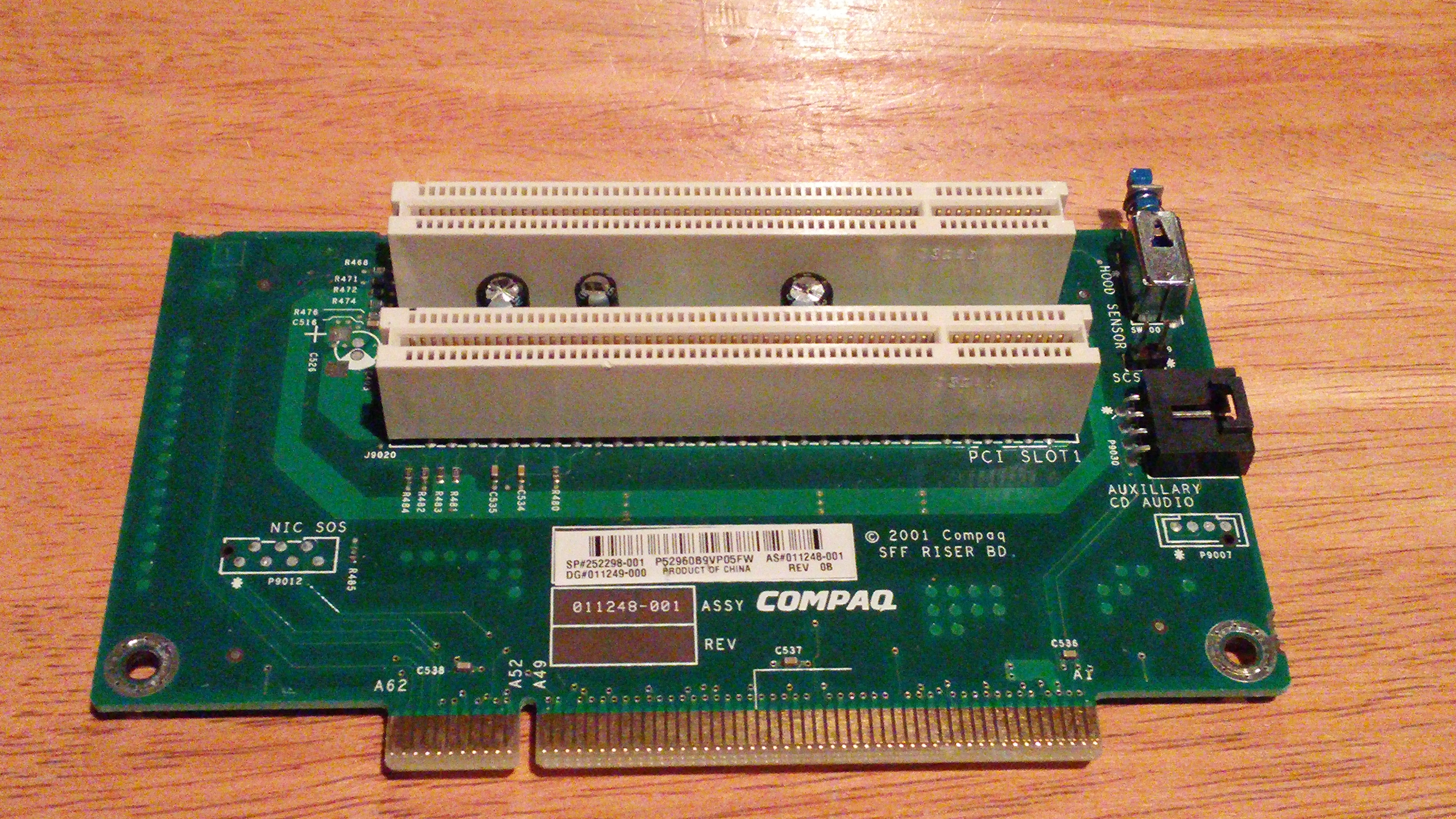

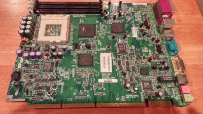

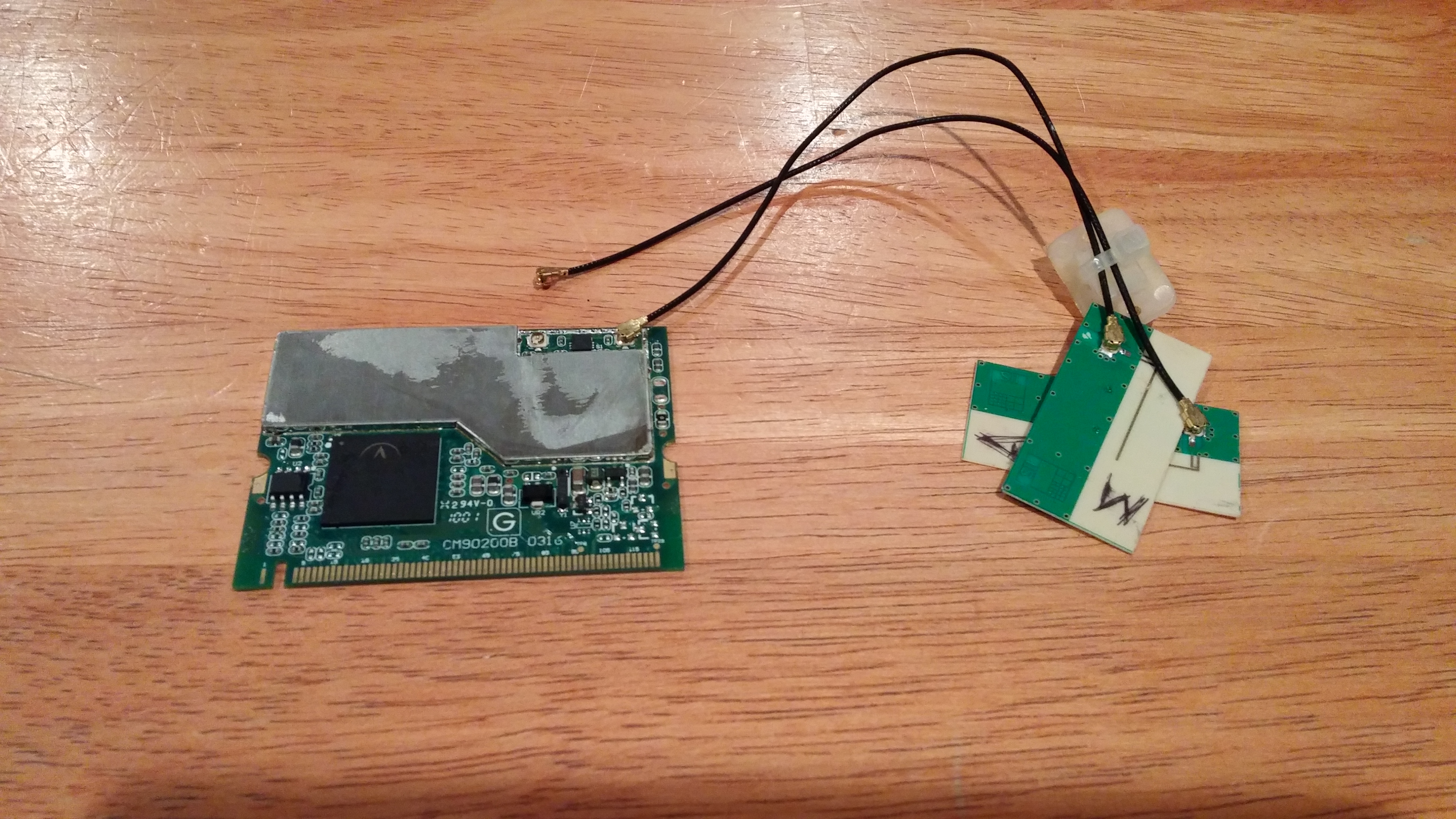

Sorry, but just when I think I have it figured out, I read more of these posts and find out that some things can be considered a higher grade with just a few more characteristics. So here we go with some of my stuff with my guess of what I think it is and what it might be considered for. For the experts out there, please let me know what sorting pile you would put these items in.
On boards like 8 & 9, would it wise to cut off the gold fingers and still be considered for small socket?
Where do you draw the line at leaving a board as is and when you rip it all apart for the smaller components? My line is if it's going to be less than peripheral, then I will remove chips, cbm, etc. But maybe I should think about doing it peripherals too?
Again, thanks for help!

10) pic gold finger card left 2 midgrade right
9) small socket yes can remove fingers
8) small socket yes can remove fingers
7) peripheral must remove Dallas pack (battery) and can remove fingers
6) peripheral
5) gold finger card
