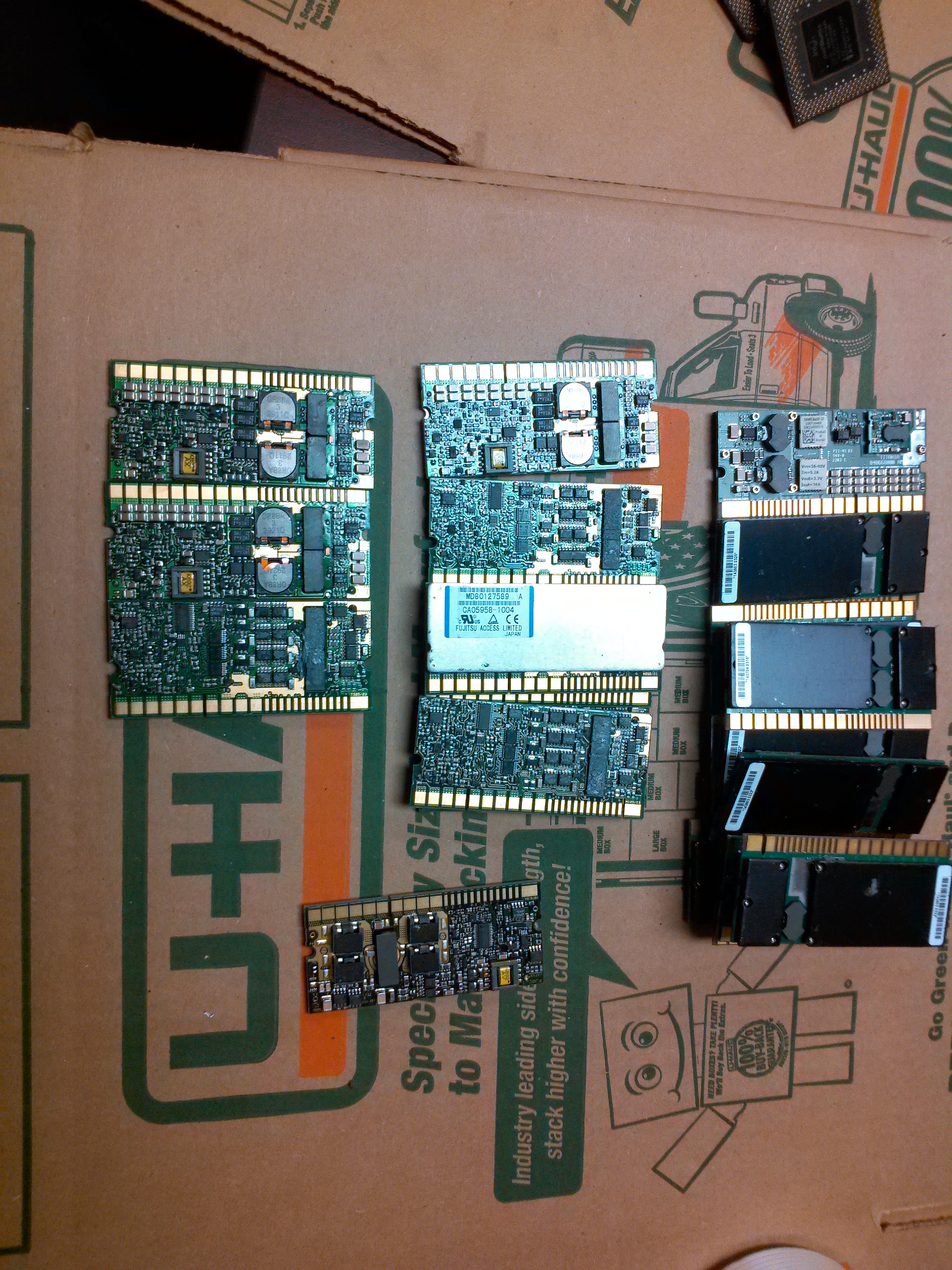

Helps to load the big photo.
Totally off. They're all gold finger card as long as you remove the heat shield

those are not ram sticks... they are VRM modules. They control the power/phase/voltage to the CPU's in servers.
If you remove the gold fingers, you will get peripheral grade for those... they 'might' grade them as gold finger card (but dont count on it) if you leave them on and remove the heat sink, but I have never taken them in that way.
You will not get gold finger ram grade because there are little to no IC chips and they have ferrite/copper coils on them.

Thanks for catching that.
