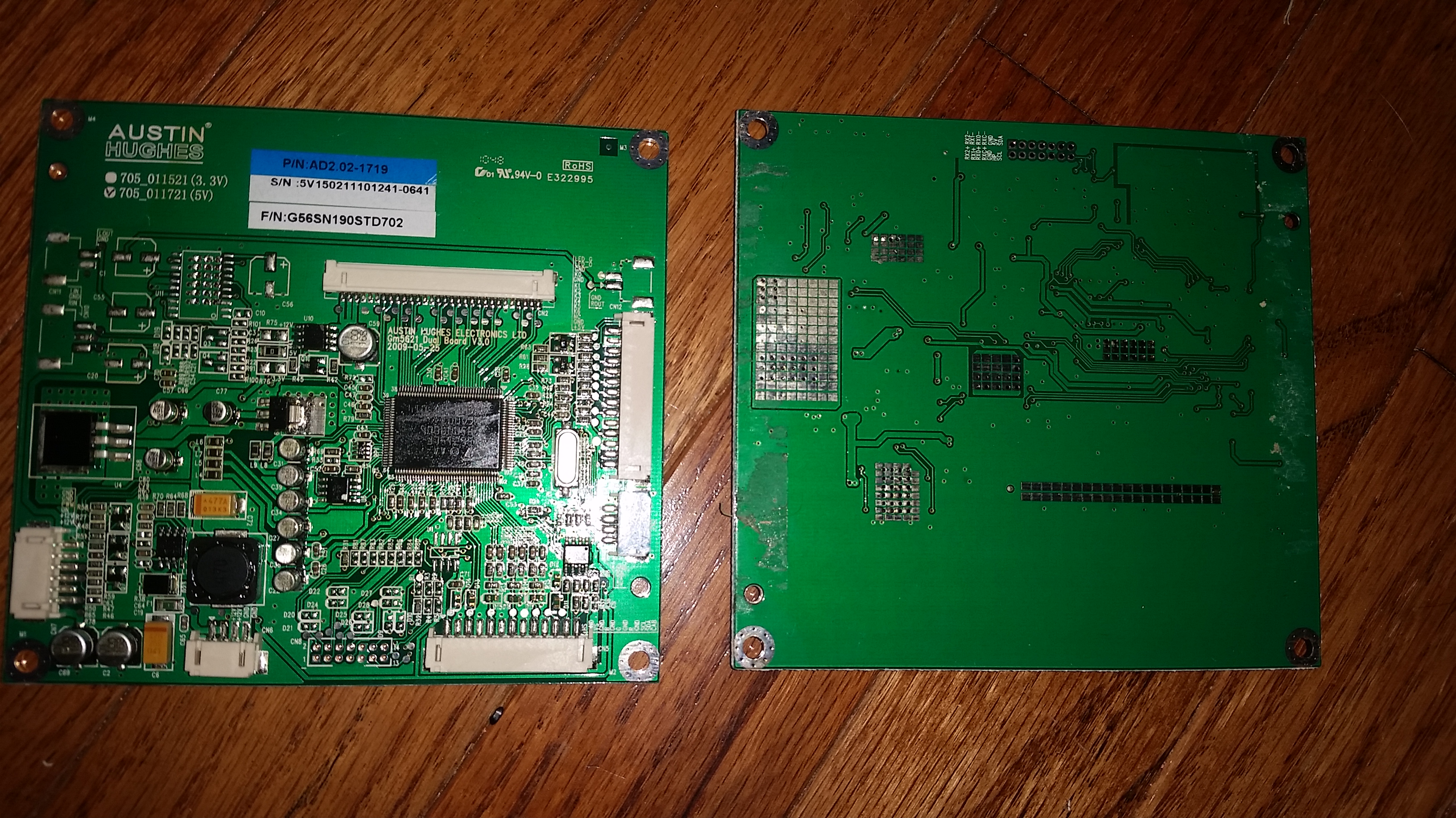

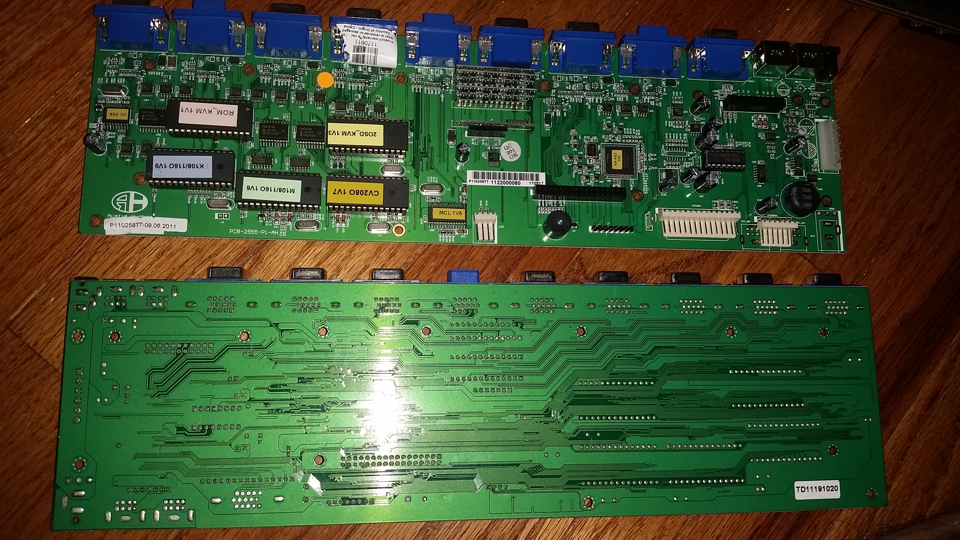

Ok I am asking for help for a few more boards....Also, is there a page on the forum, that I can go to that gives me the definition of the board classifications? I have seen pics but looking for more help

564000 is peripheral
the lower board is probably peripheral. There's alot of weight in the connector row on the edge
and i wouldn't cut it because i don't think there's enough weight in the ics to offset the price difference in telco/gold connectors split vs peripheral.
The two board picture. Is peripheral
the lower board as is would go for peripheral class.
Some people jump to ideas of can i cut this or remove that for a different classification.
Was just attempting to dissuade you from attempting that.
telco grade is a class based on integrated circuits (ic) / density / of a circuit board. Other sites and forums also call it chip board. Ic board. Or circuit farm.
