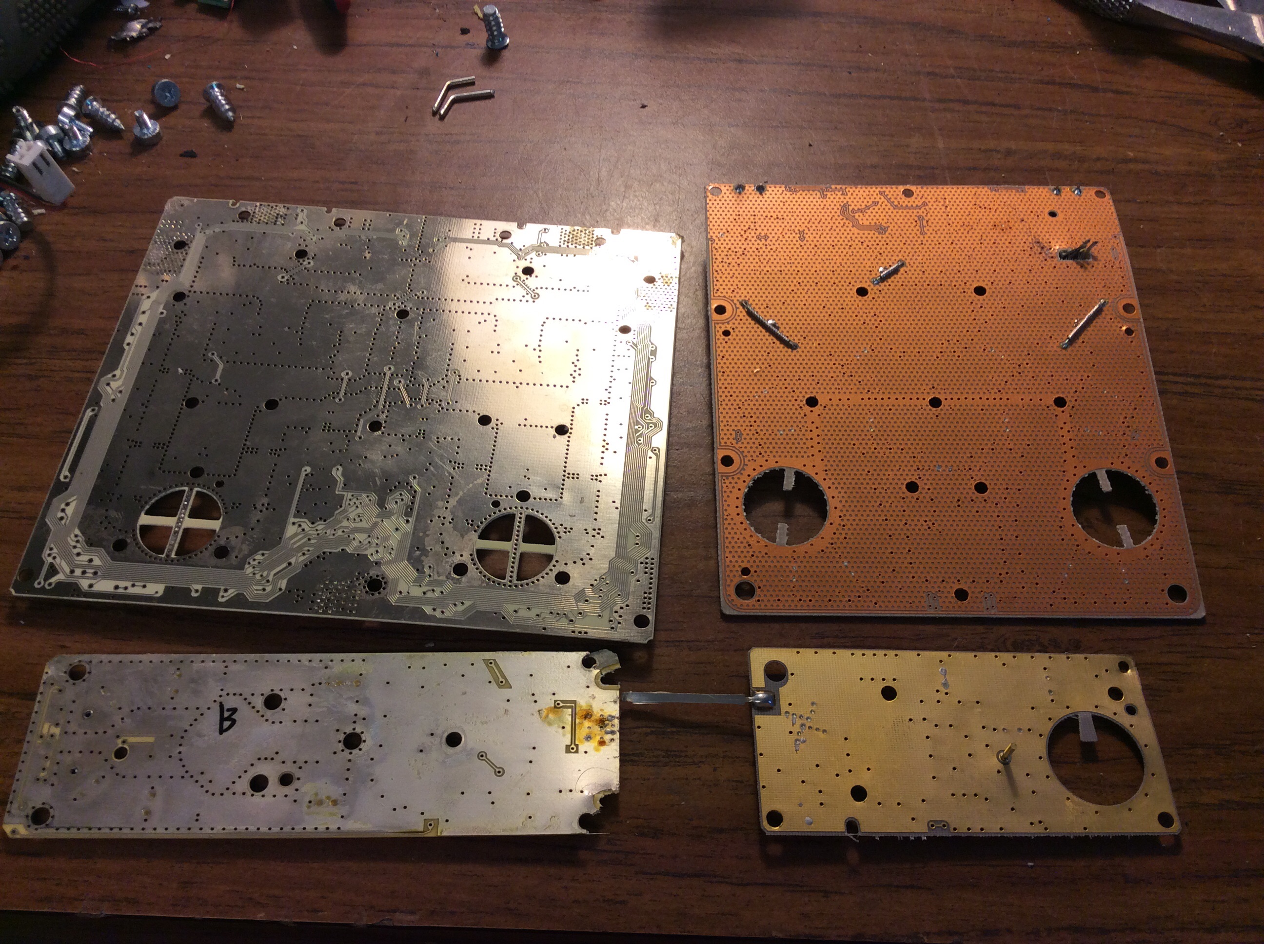

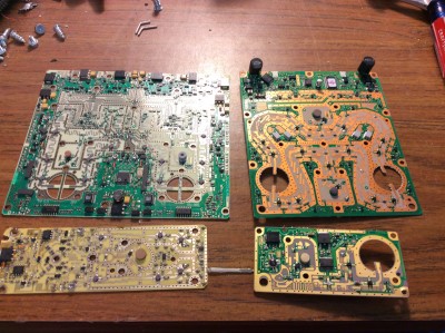

Could anyone help grade these for me? They are from various DISH TV satellite LNBs. My best guess is peripheral?
PostPosted: Wed May 20, 2015 10:48 am
Those will go as peripheral most likely. Others here have posted boards coming out of Dish and DirectTV satellite dishes and peripheral was the consensus given.
PostPosted: Wed May 20, 2015 1:42 pm
If the flashing is copper nickel or silver the general consensus is peripheral.
Gold flashing.or rhodium ask for a review upon arrival
