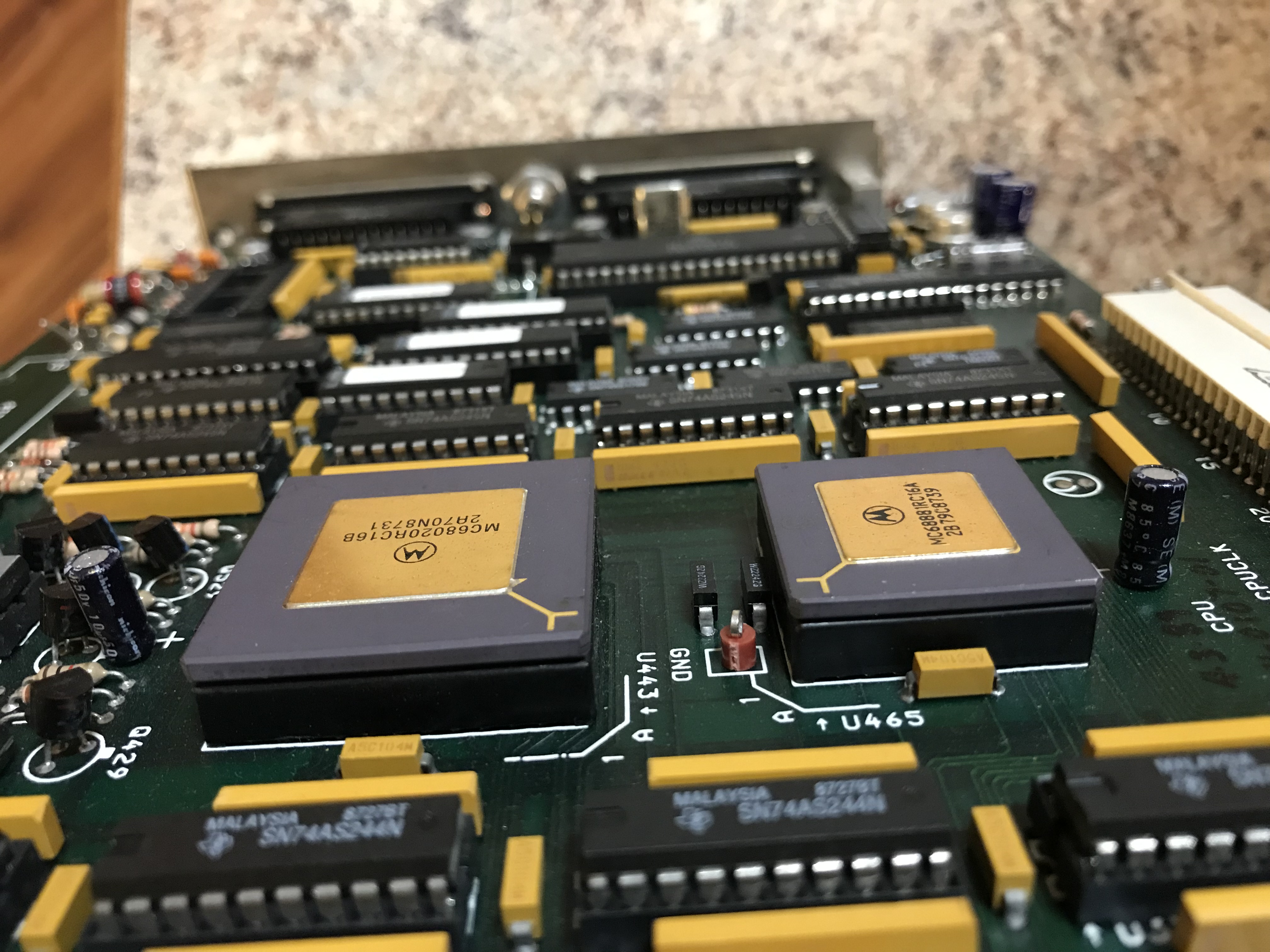

Can you tell for sure if they are socketed from this angle?
 Post subject: Re: Gold cap chip boards
PostPosted: Sun Nov 24, 2019 9:45 pm
Posts: 78
They are socketed. Use small flat screwdriver. Go around the perimeter, lifting a little at a time by slightly twisting the driver.
PostPosted: Sun Nov 24, 2019 10:09 pm
Yes. Start at the corner opposite the gold corner tab (opposite the y). Chips are designed to be lifted there first.
Motorola used HIF sockets, high insertion force, so it takes a bit more effort than most other’s of the time to get them out... or in.
